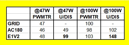

Update on the fridge issue - I am in PM contact with @BLUETTI.
  1. I detailed the problem.
  2. Their Tech Team, pushed a DSP update to me.
  3. On opening the App, the E1V2 also required an IOT update.
  4. The IOT was updated first, the the DSP update.
  5. I retested the fridge as follows;
    a. With my power meter inline from the grid only.
    b. From my AC180 - noting the display Watts and with my power meter plugged into the AC outlet of the AC180 to compare what the power station display Watts were and the actual Watts the fridge was drawing.
    c. The same setup as item 2. but with E1v2.
I waited until my fridge cycle started for each test, so it took a little time to do. At start up it hovered at around 47W for a minute or so, then increased to the 100W mark in around 10 seconds. This is the inverter fridge soft start.
The results;
FR RESULT
(PWMTR = Power Meter - U/DIS = Power Station Display.)
The power meter value is what the fridge is drawing in power and is similar in value in all 3 connections. At 47W = 2W range, at 100W = 5W range.
The anomaly is the E1V2’s displayed value, it’s high and I’ve FWD this to Bluetti. (Awaiting response) Whereas, the AC180 showed a difference of 3 to 4W.
The Good - The fridge is working perfectly in all instances, so the update appears to work. No feedback yet on if this fixes the A/C issue. Weather does not allow me to try another test, yet and I would like guidance from the Tech Guys first.
