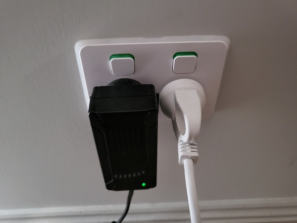

I have noticed that power outlets in some parts of the world are just plug in with no switch. Here in AU, all household GPOs are switched.
AU GPO
There is a green bar at the top of the switch, which notes the ON position.
There is “method in my madness”, lol.
