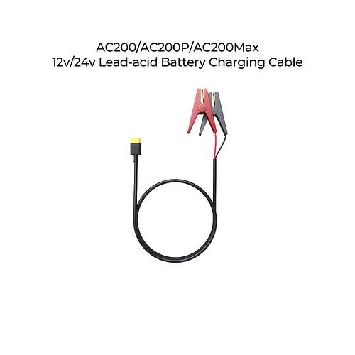

assuming I would have to do some crazy stuff like this:
I’m not well-versed in electronics/voltage etc. So yeah just wondering if it’s possible to charge my EB150 while driving, or even just parked and idling.
