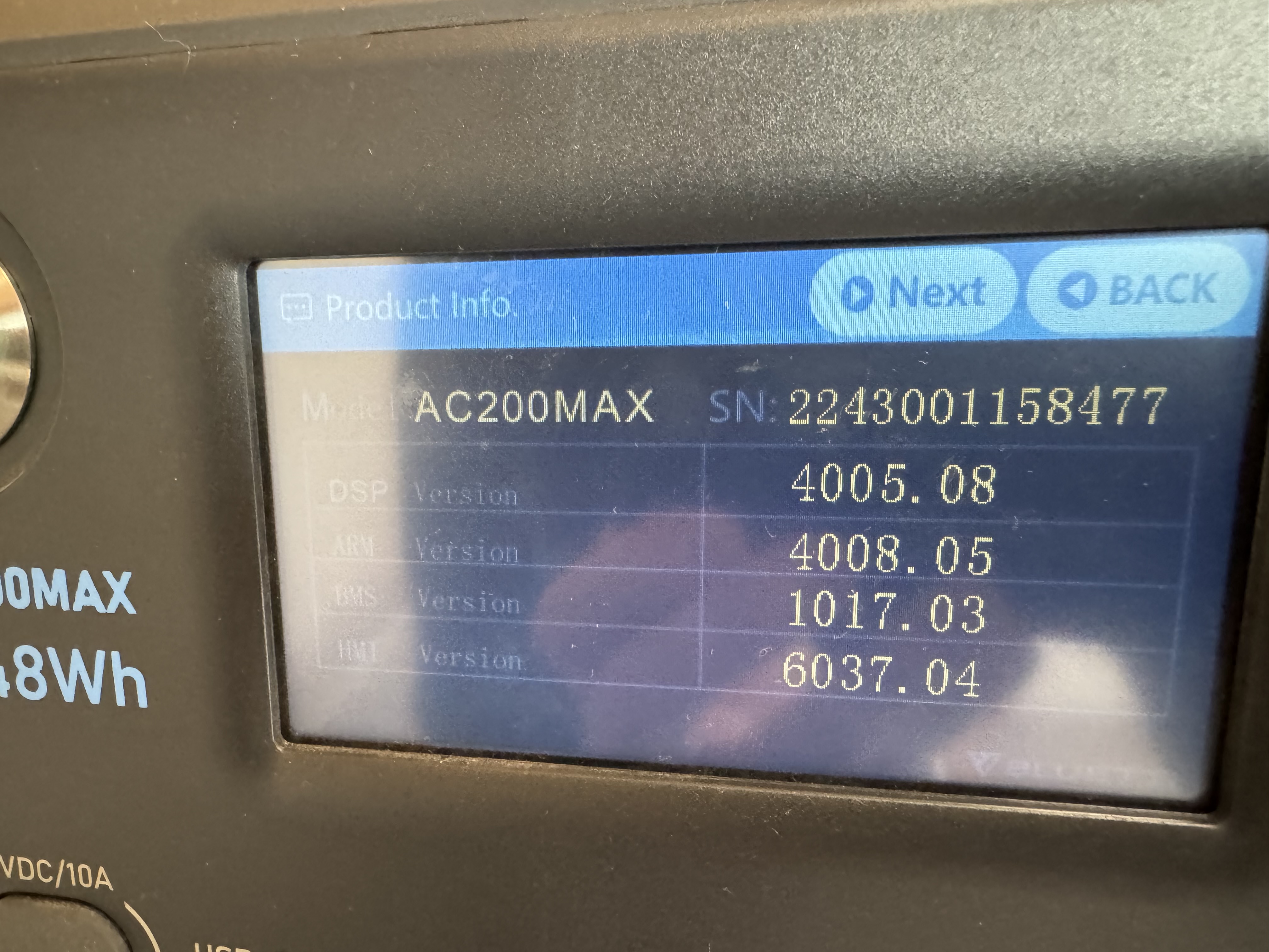

Hi @BLUETTI_CARE I am having the same problem. I press the AC or DC buttons, but that action does not turn on the ac or the dc outlets. Can you please send me the update? Here is a screenshot of my device info:
Hi @Melf, thank you for contacting us.

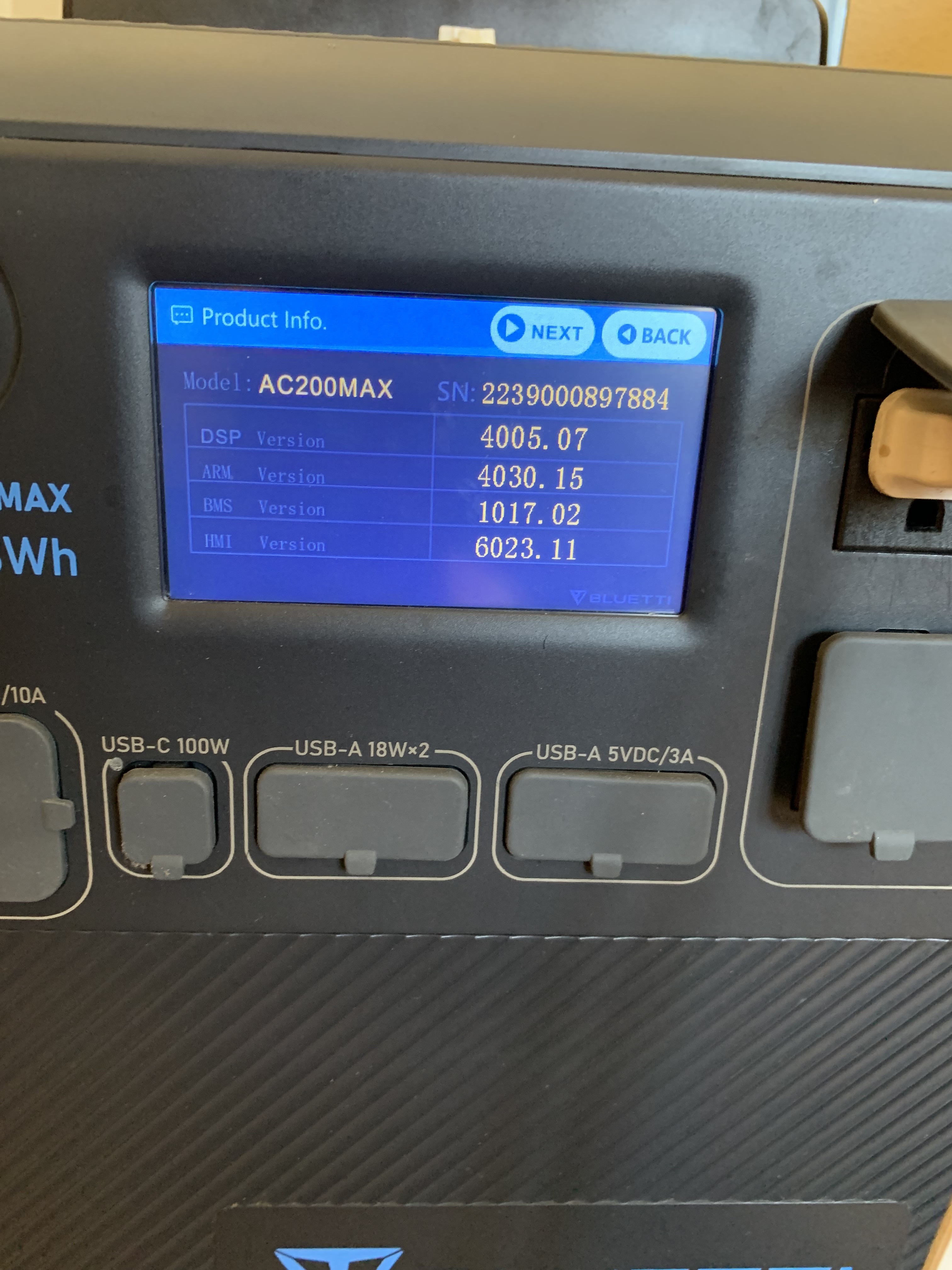

Dear BLUETTI team, my device also have such problem, could you push firmware update to this SN

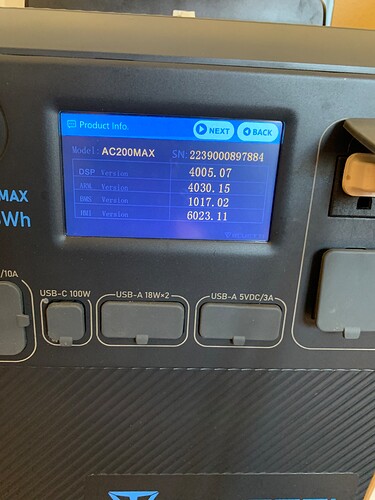

Same situation here for one week. Could you solve this issue?
Thank you and kind regards from Switzerland ;-)

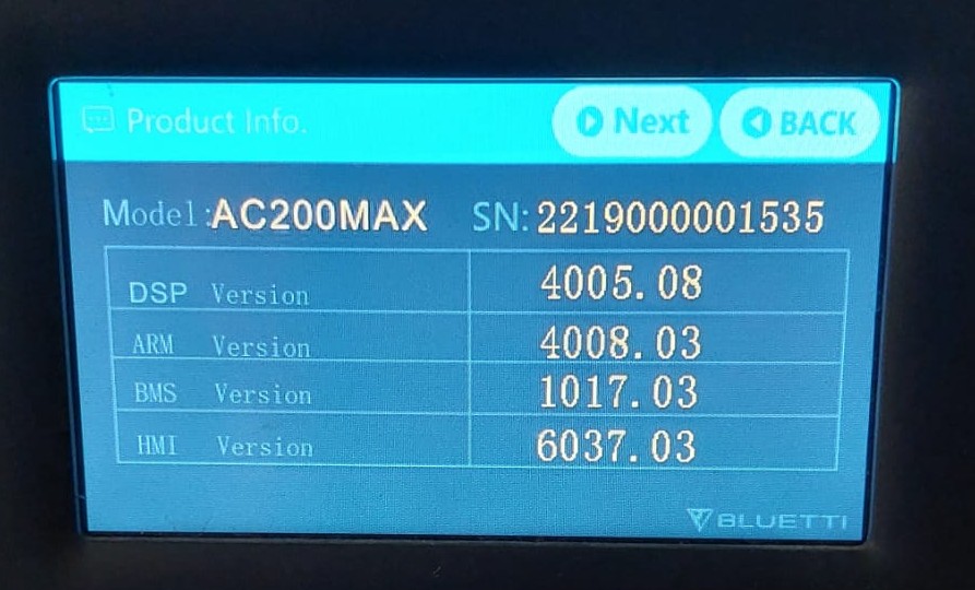

@BLUETTI Hi, I didn’t receive an answer to my previous request. Could you make my Bluetti device working well again?
Thanks a lot.
