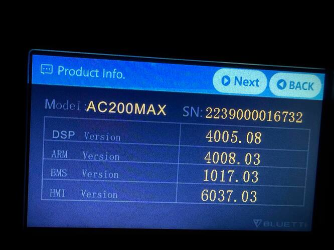

Hello, have similar issue. Cannot control AC/DC via touchscreen, only works using app

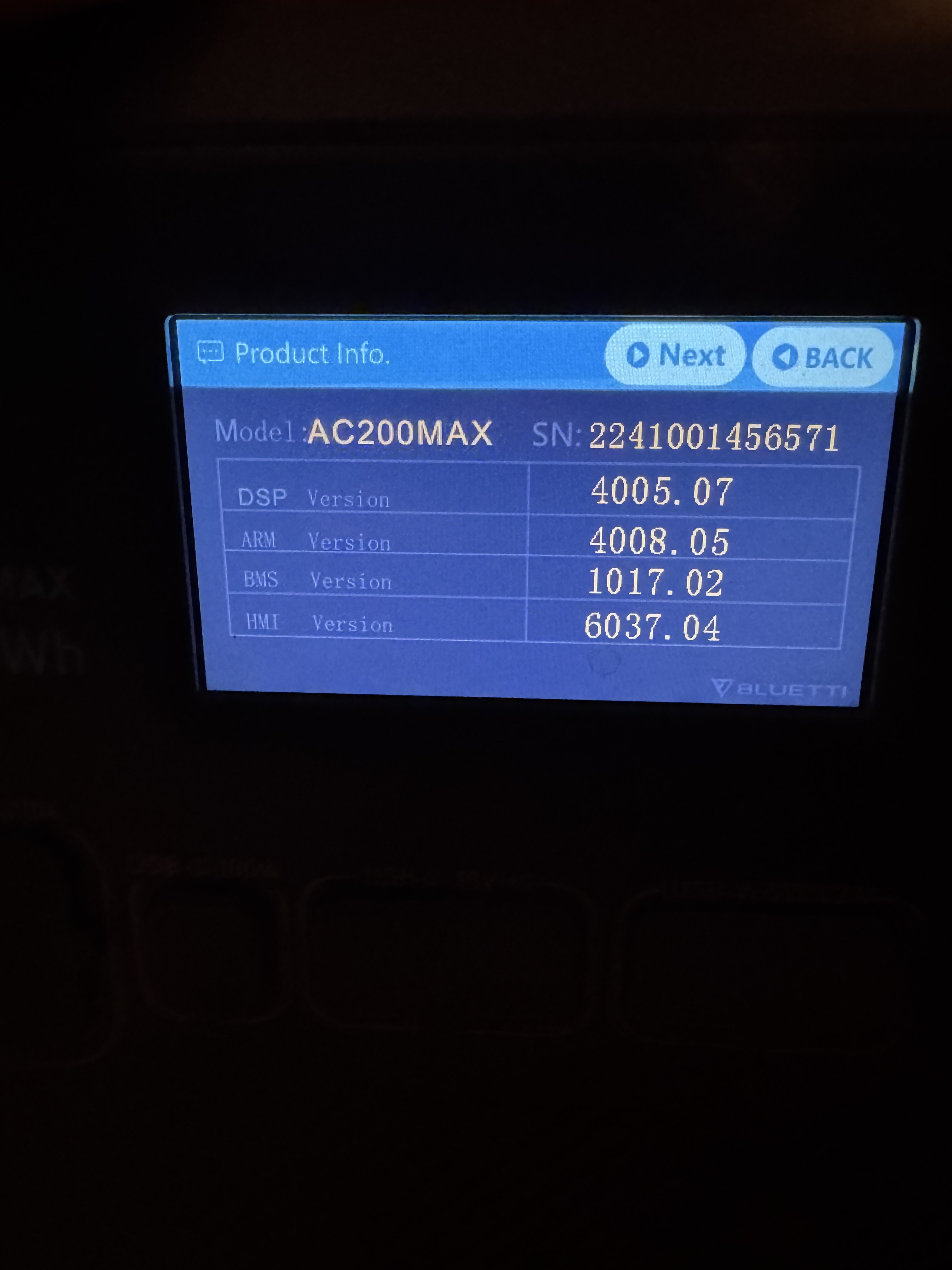

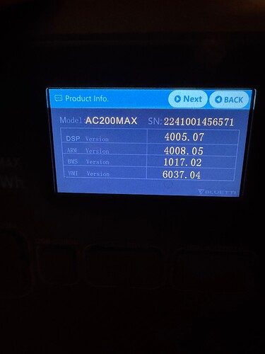

Same issue on AC200MAX
SN: AC200M2247001128971
ARM v4008.05
DSP v4005.08
BMS v1017.03

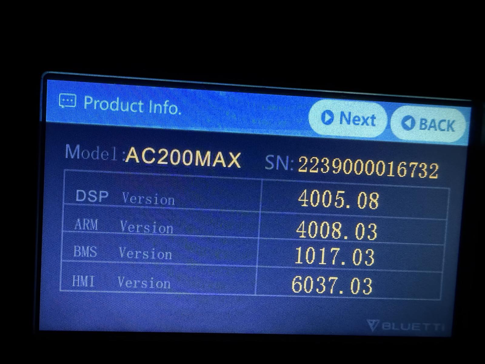

Please support, may I know which are the firmware version most updated?

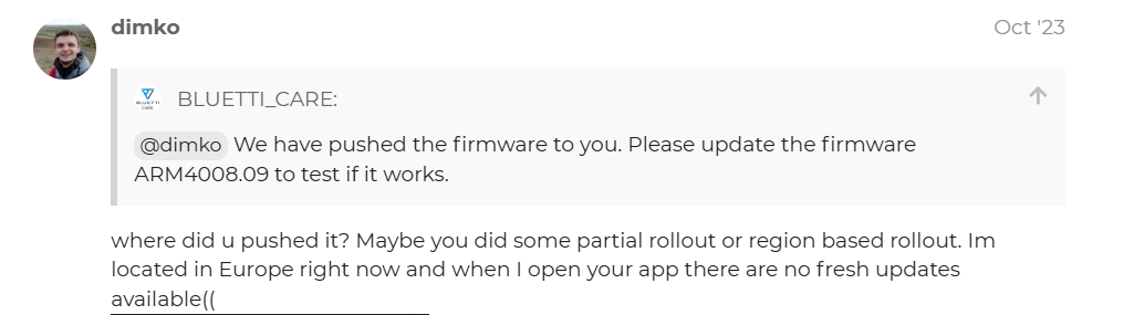

The app says I’m updated but on the forum above, @dimko, in 2023, asked the newest version and the support answered that the ARM was 4008.09. Now, in 2026 my device is considered updated with ARM 4008.05.

After one month, I’ve called again via phone and finally they pushed also to me the ARM 4008.09, the same that solved 3 years ago the problem to dimko. The problem has been SOLVED. I write here in order to help other people in my condition. Even if the phone tells you that the device is UPDATED, it’s not said, that check it’s not robust.
In my case I had a firmware vers. 4008.5 (in 2026 considered updated by the system) while in the 2023 there was already a 4008.9 available. Don’t give-up, If you are strong enough, in 2 months you can be updated with the “push”.
