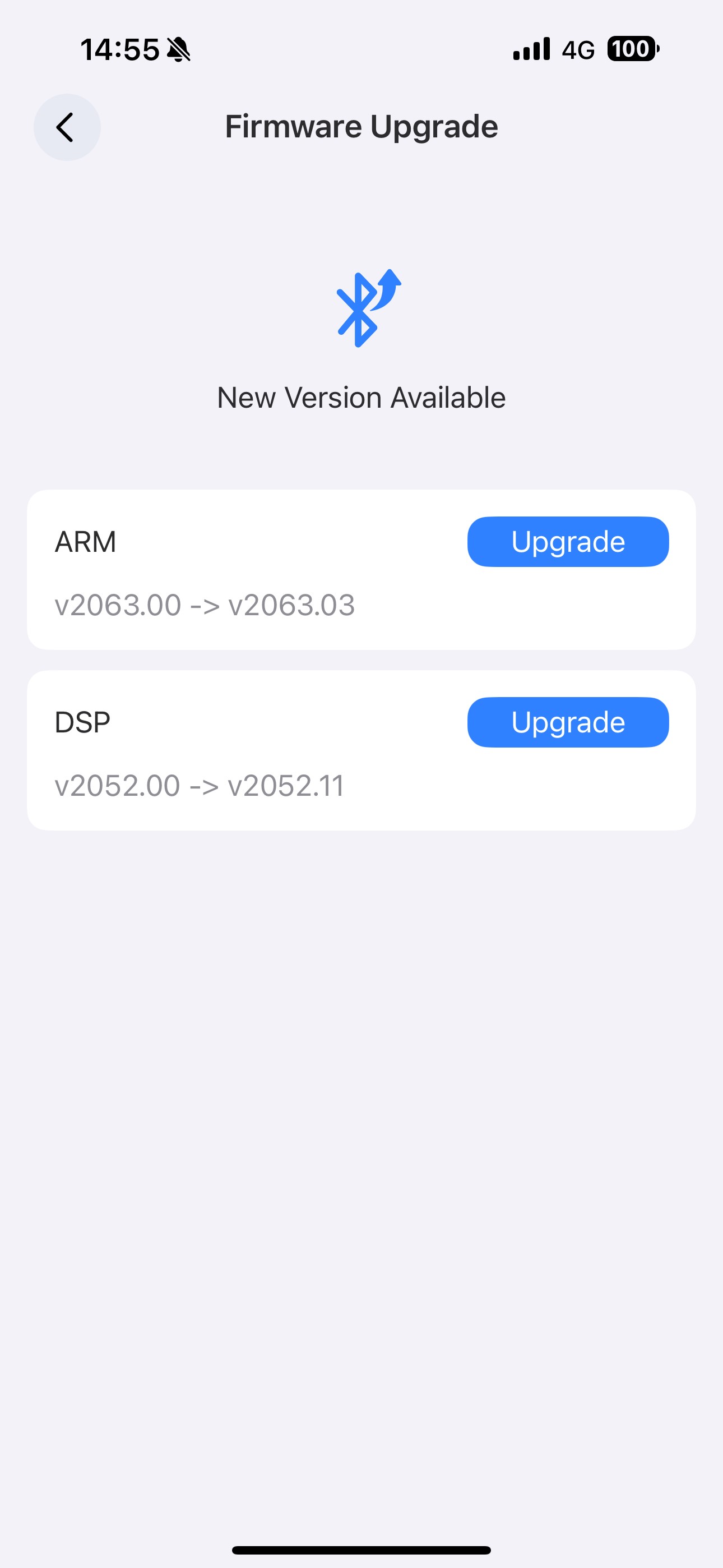

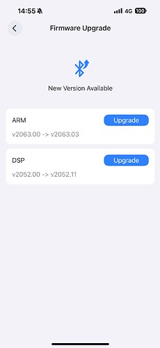

I don’t know if this is normal, received unit today and went through ARM firmware upgrade and message on the phone was all successful. Unit now just has 4 flashing lines on the left hand side.
After reconnecting the phone the firmware versions still shows the same as prior to upgrade.
EB3A2313004590299
Firmware
ARM
v2063.00 → v2063.03
DSP
v2052.00 → v2052.11
