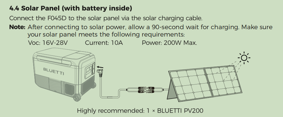

@R.M.1 Hi Dean,
You’re not referring to BLUETTI’s SwapSolar portable refrigerator, are you?
Generally speaking, refrigerators need to have a built-in battery in order to connect to solar panels for PV charging. Without a battery, they can only be charged via AC power.
