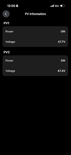

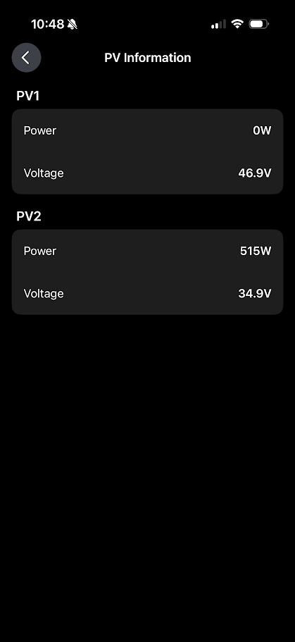

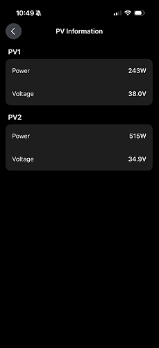

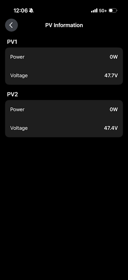

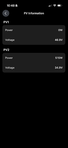

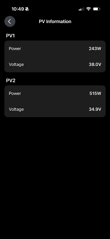

For whatever reason, PV1 shut off, and the app reports 0W at 47V
I reset the breaker for PV1 and within seconds it is working a at 240W 38V
Something is going on to cause the Apex300 PV MPPT to not work. It remains connected as it reads the voltage, but is not pulling current / power. At this point, by SOC is 85% in self consumption mode with set point 70% SOC. Check the app screen shots made just before and after within 30 seconds or so.
