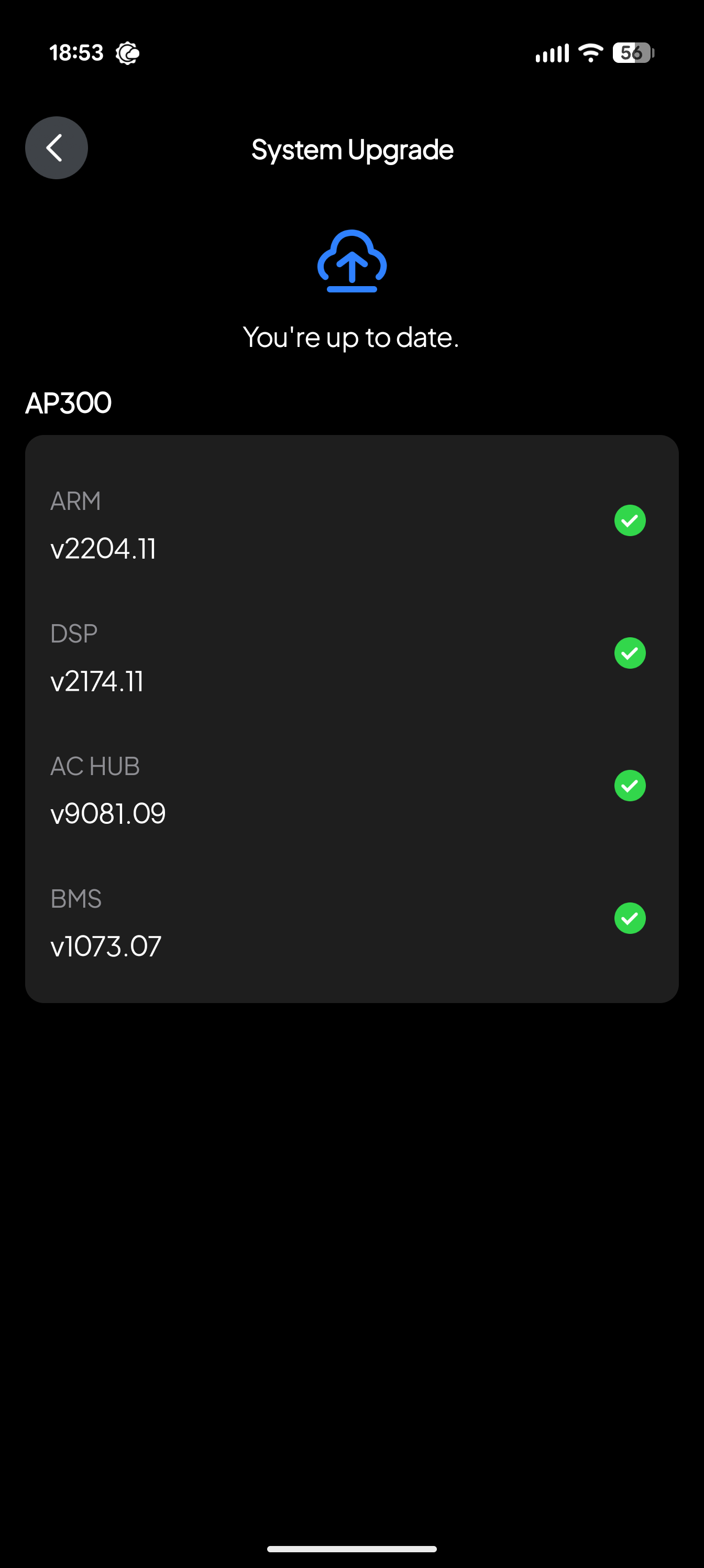

My firmware:
IoT v8026.12
ARM v2204.11
DSP v2174.11
BMS v1073.07
Bluetti says it might be related to recent firmware update and offer a roll back, but I am hesitant to take them up on that as I don’t know what else was fixed in the recent update. They said they are looking into it.
What firmware are you using?

I have the exat same problem, after the firmware update.
My firmaware settings look like the same as yours.
BMS v1067,13
ARM v2204.11
DSP v2174.11
DC HUB v9084.08
BMS v1073.07

I had been testing the following set:
DSP V2174.12
ARM v2204.12
BMS 1073.07 (no change)
BMS B300 V1014.18
BMS B300k V1067.13
The behavior has improved but is not fixed 100% for me. In the past, I would get PV power drop off (where it is not pulling any power but just showing voltage) frequently. Now, I haven’t seen that when the SOC is <90% for at least a week. But I’ve seen the drop off 2x when the SOC is between 98-100%. How, I know the charging should stop at full charge, but it doesn’t seem to restart when SOC drops. If I unplug and re-plug the PV cable, then it would pull power again. I am continuing to follow up with Bluetti support

This is what I am at currently
v2204.12 was the ARM that I was updated to which fixed the cut off issue at lower SOC. But it still cut off sometimes at high SOC. I am now testing a new IOT v8026.13 and ARM v2204.13 that may resolve the MPPT PV input issue at high SOC. These are likely test builds, and if it works, probably will roll out broadly in Nov. I’ll let you know what I find.
