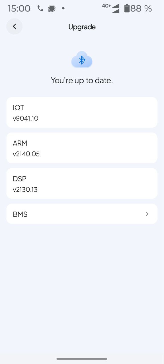

The problem is that all updates are installed, the option is enabled, but even when the charge is more than 5%, the station does not turn on automatically.
After all applicable updates have been installed sucessfully – it still does NOT recover either output, even if the battery level is 100%% charged and despite the output has remained off for over 30 minutes. How can we get it fixed?
