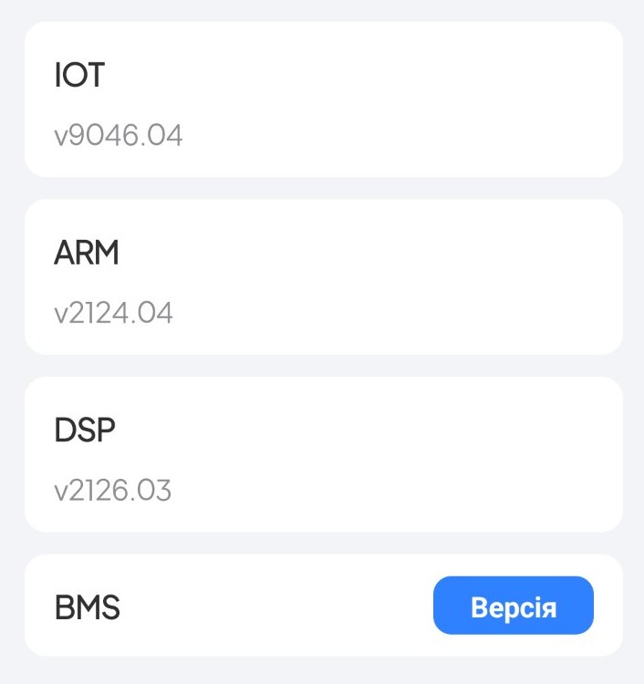

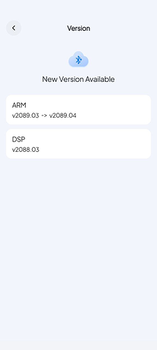

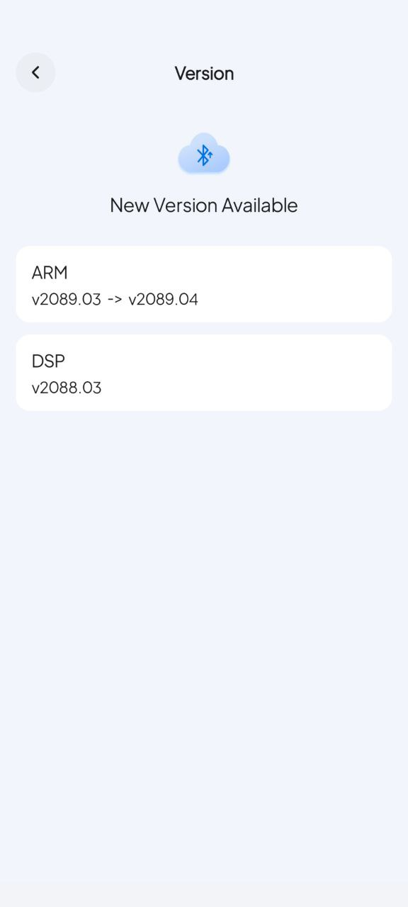

Thank you, but I don’t know how to proceed from here:
I see no buttons or other controls on this page :frowning_face:
Hi @Ontone, judging from the screenshots you provided, you are using the Bluetooth offline mode. Firmware updates are not available in this mode. Please register and log in to your account, then bind your AC180 device first, and then select the Bluetooth connection mode. Next, locate the blue update button and tap it to start the update.
We have attached a screenshot for reference.
