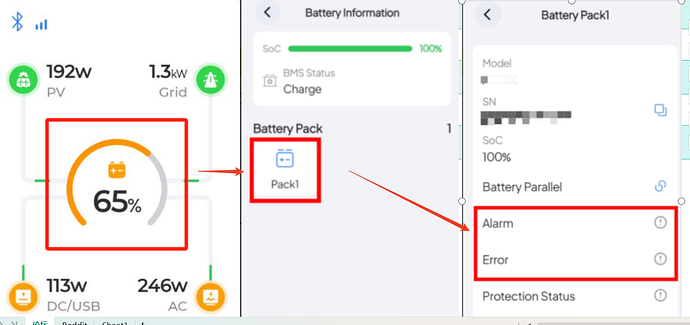

Please log into the Bluetti app, click the SOC icon in the center to enter Battery Information, then click on the Pack1 icon to find the specific Alarm and Error codes (starting with the letter P).
Once you have the exact error code, let us know, and we’ll further investigate the issue for you.
