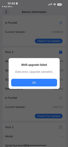

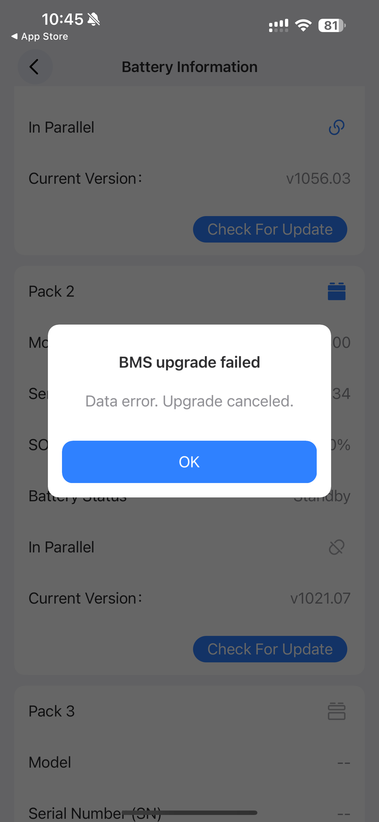

Also thank you for new BMS version pushed to my B300, but I can’t install it.
After transferring files, the app shows me that unzipping is in progress and progress stopping on 50%. Later it interrupts with the error “BMS upgrade failed. Data error. Upgrade canceled.”
Update:
after few times of trying to upgrade BMS in b300, my app starts crashing.
app version iOS 2.3.10

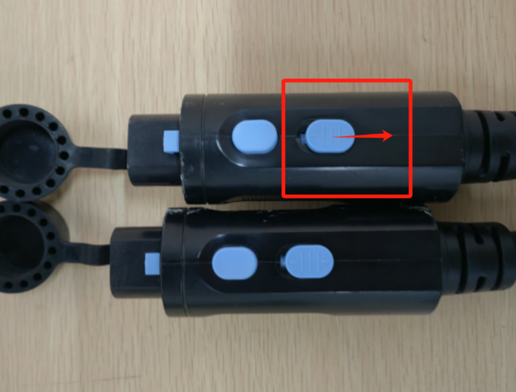

Hi @Filosof, Regarding this issue, please charge the battery pack first, as upgrades cannot proceed when the battery level is too low.
Additionally, when the upgrade reaches 50%, try toggling the lock on the connection cable to the Unlock position without disconnecting the cable. Then, continue with the upgrade. This helps ensure a successful update. Once the upgrade is complete, please switch the cable back to the Lock position.

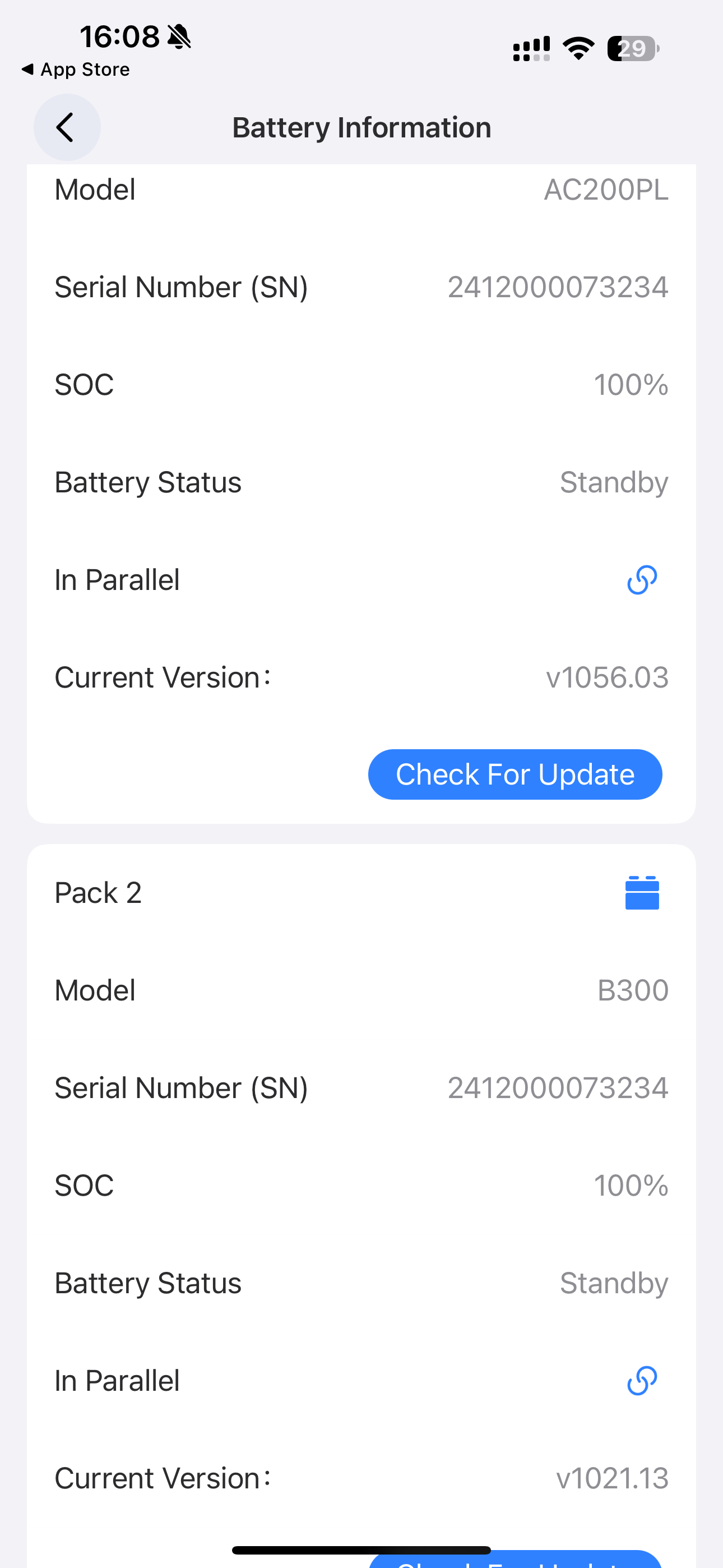

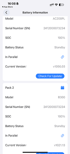

Thank you, @BLUETTI_CARE, for your instructions. The new BMS version works!)
The battery was updated successfully.

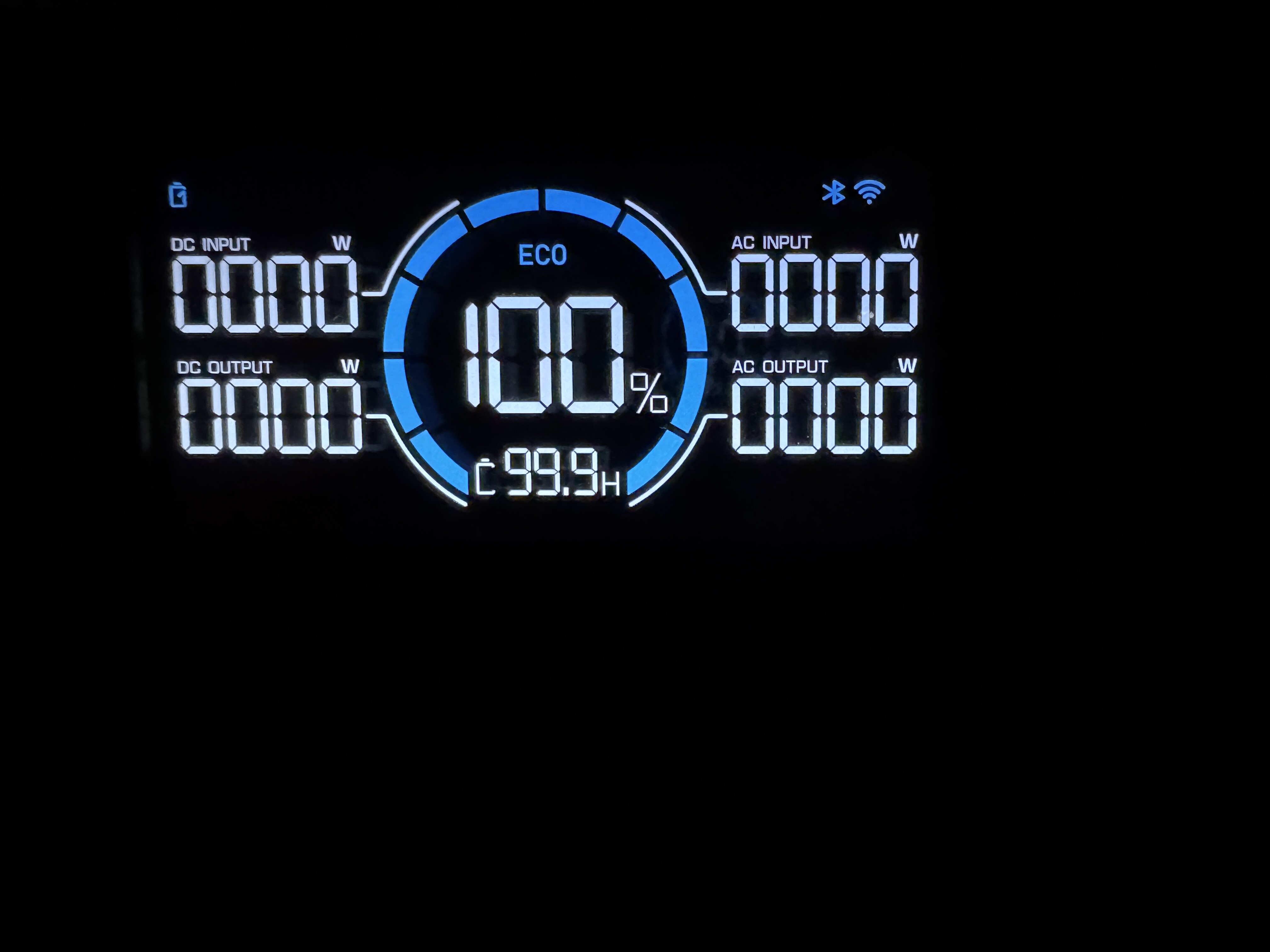

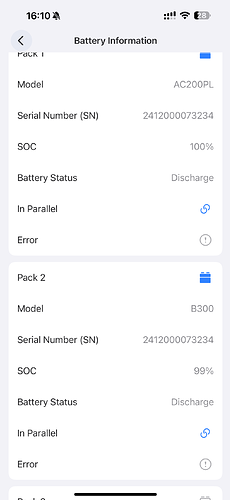

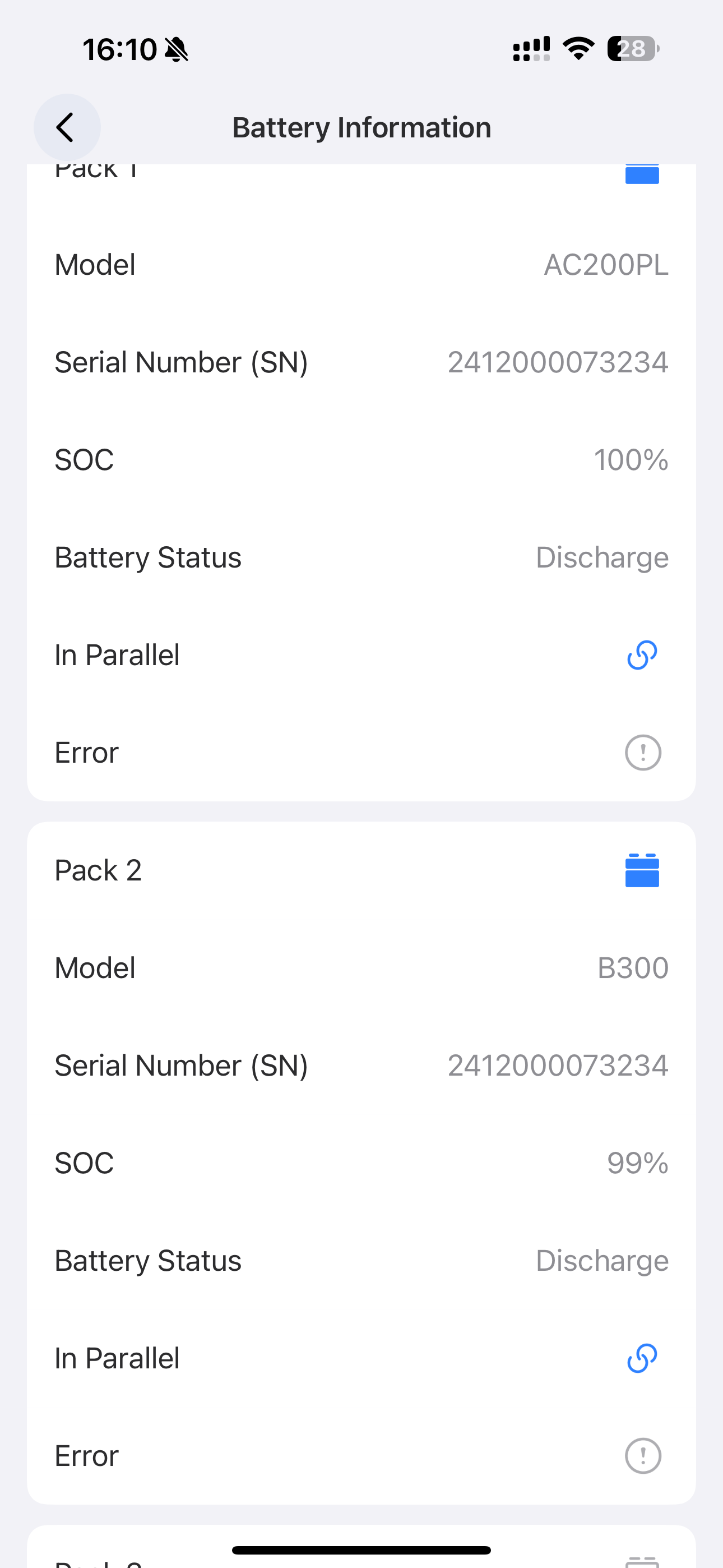

The app and screen on ac200pl show that the battery and ac200pl work in parallel.
During discharging, they also work in parallel.

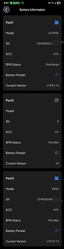

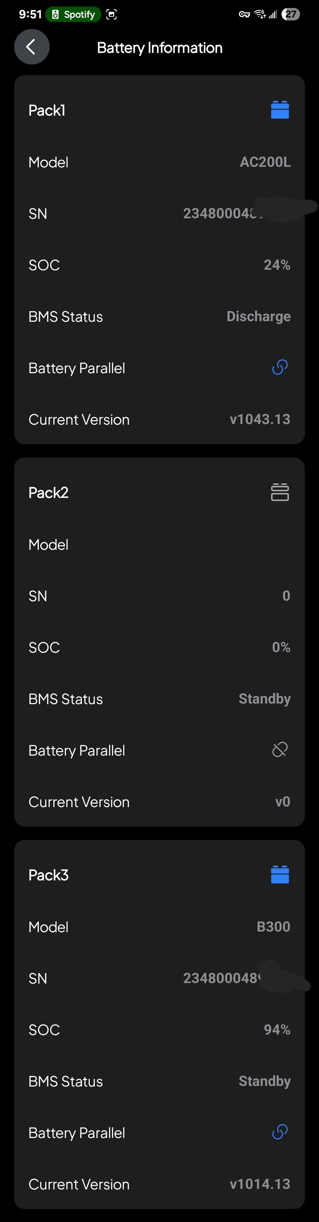

@BLUETTI_CARE I have a similar problem with my AC200L and B300, they are not discharging equally.
I already did a battery drain on both then fully recharged. But this issue still persist.
Thanks!
Hi @Dan90, We noticed that you’ve already updated the BMS firmware to the latest version.
Also, please make sure that after charging or discharging the units separately, both devices have the same battery level before connecting them together.
