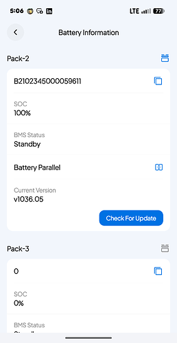

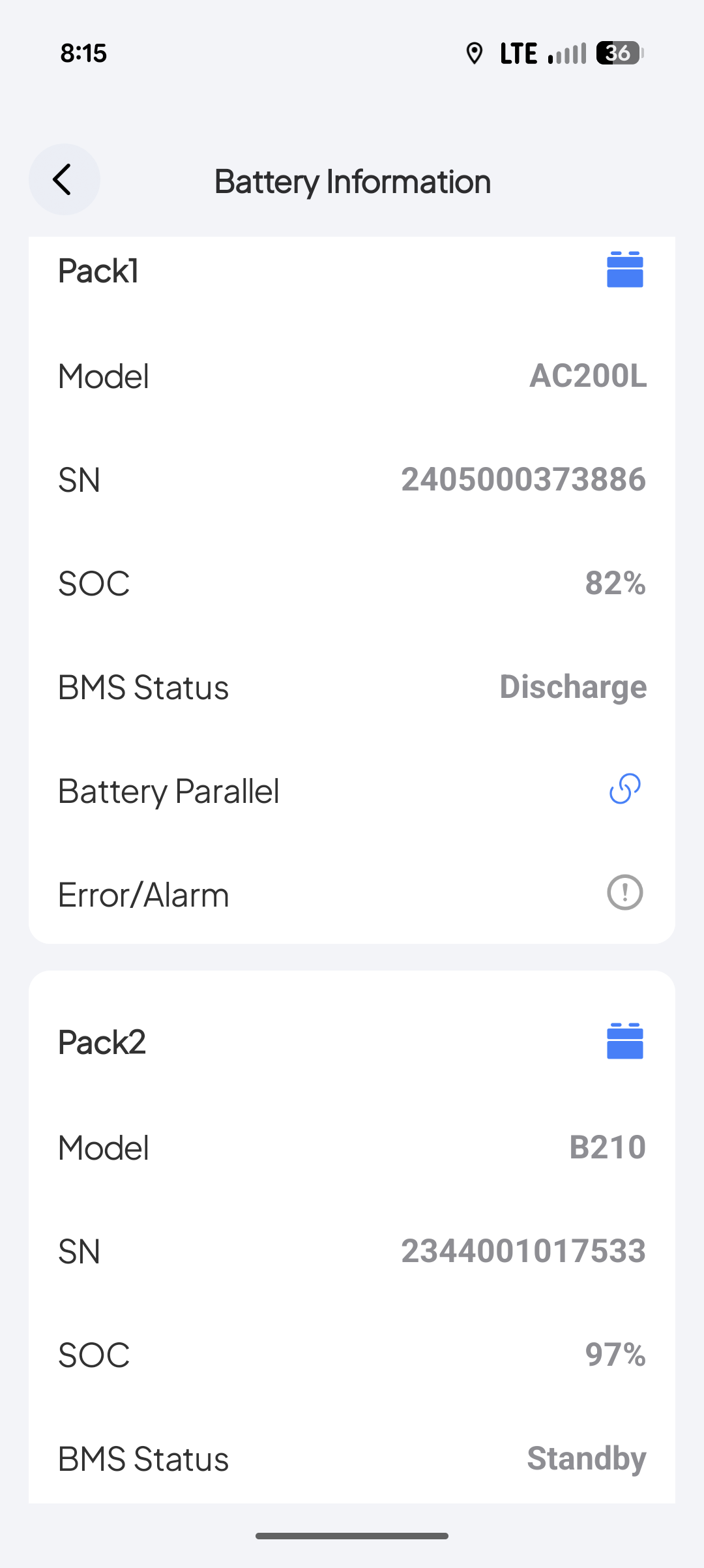

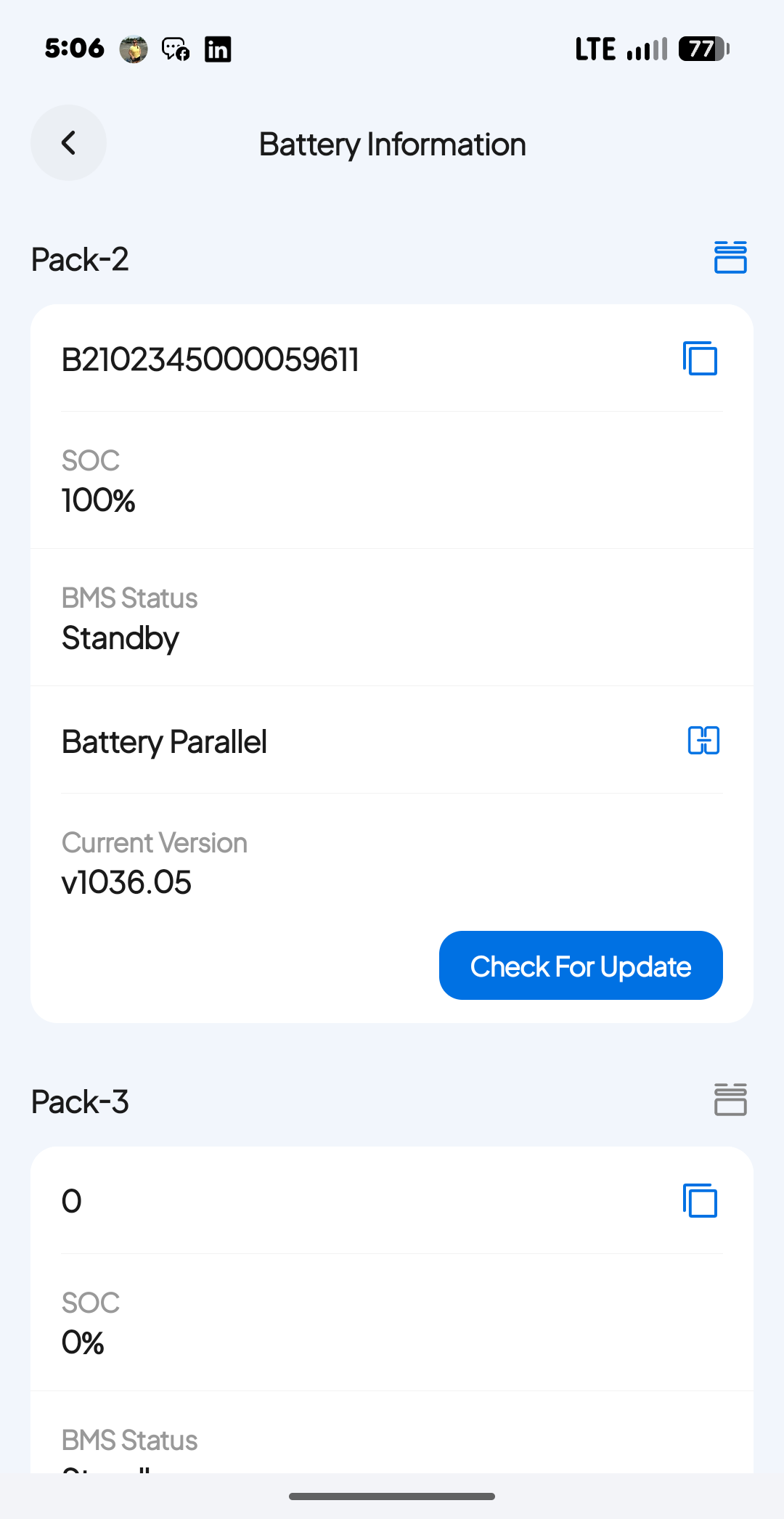

@BLUETTI_CARE I seem to still have balance issues after several charge and discharge cycles. Please see photo
Please advise.
Hi @Ellimatt37, Thank you for the update.
We’ve noted that the power difference between the two batteries is not significant—it falls within an acceptable range. This will not have a substantial impact on practical use.

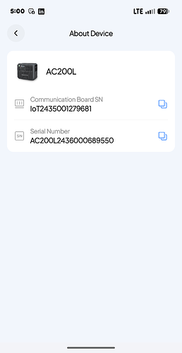

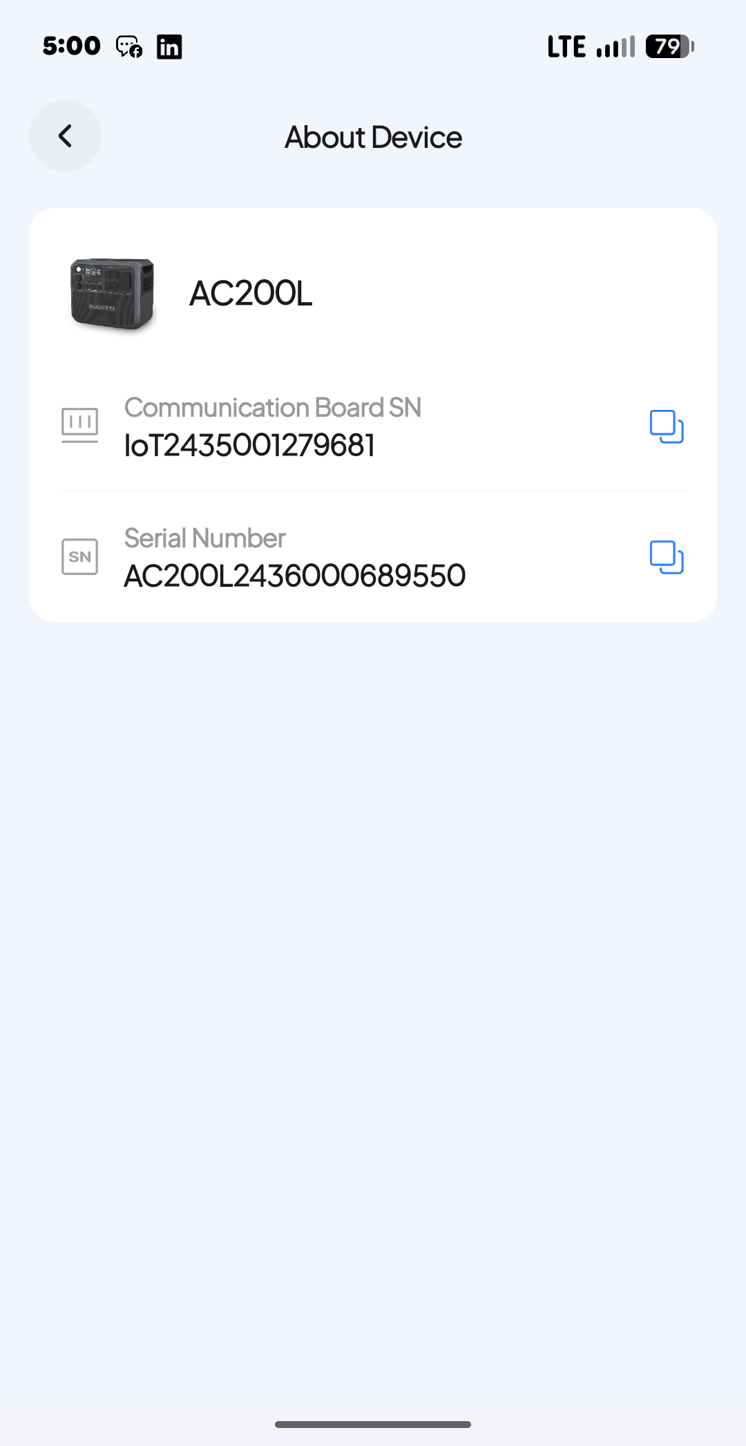

Here is my AC200L SN info
