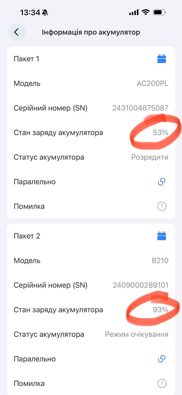

Hi. I might have the same problem. My B210 is in a standby mode when i use AC200PL+B210 only AC and usage is bellow 200. What to I do to make AC200PL+B210 discharge evenly?
wh.

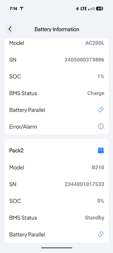

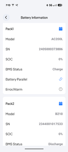

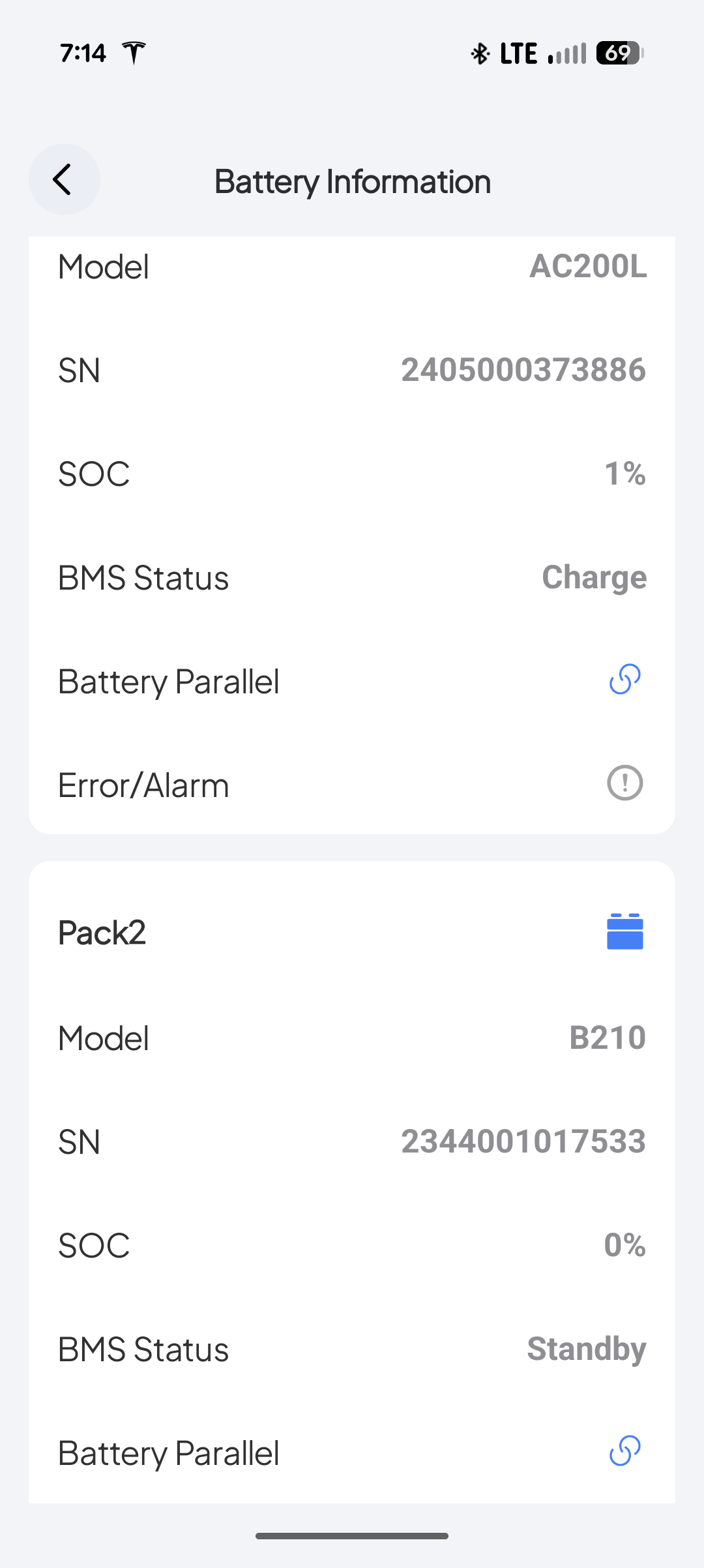

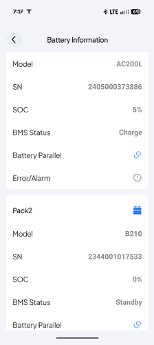

@BLUETTI_CARE new firmware for b210 and ac200l loaded. Currently in the SOC calibration cycle.
I charged both to 100%. Then I connected a load to drain. I did notice that the AC200L started discharging but the B210 was in standby. The AC200L was at 96% the last time I checked and the B210 was still at 100%. Is this normal for this part of the SOC calibration cycle?
Hi @Ellimatt37, Thank you for the update. We consider a 4% SOC difference to be normal.
Please don’t hesitate to reach out to us if you need our help.
@BLUETTI_CARE During the charge cycle, the B210 was in standby mode and there is more than 4% discrepancy. Is this an issue? It said the B210 was actually discharging to start when i plugged in the AC200L. Then it went charging on the AC200L and standyby on B210. Is this normal?
Hi @Ellimatt37, We consider a 4% difference to be normal.
When two power stations are connected, the one with higher power will have a higher voltage and discharge first.
Once it discharges to a point where the other power station has higher power, the latter will take over and discharge first.
This also helps to keep the final power levels of the two stations roughly consistent.
Unfortunately didnt get any updates pending.
SN: 2431004875087 and 2409000289101

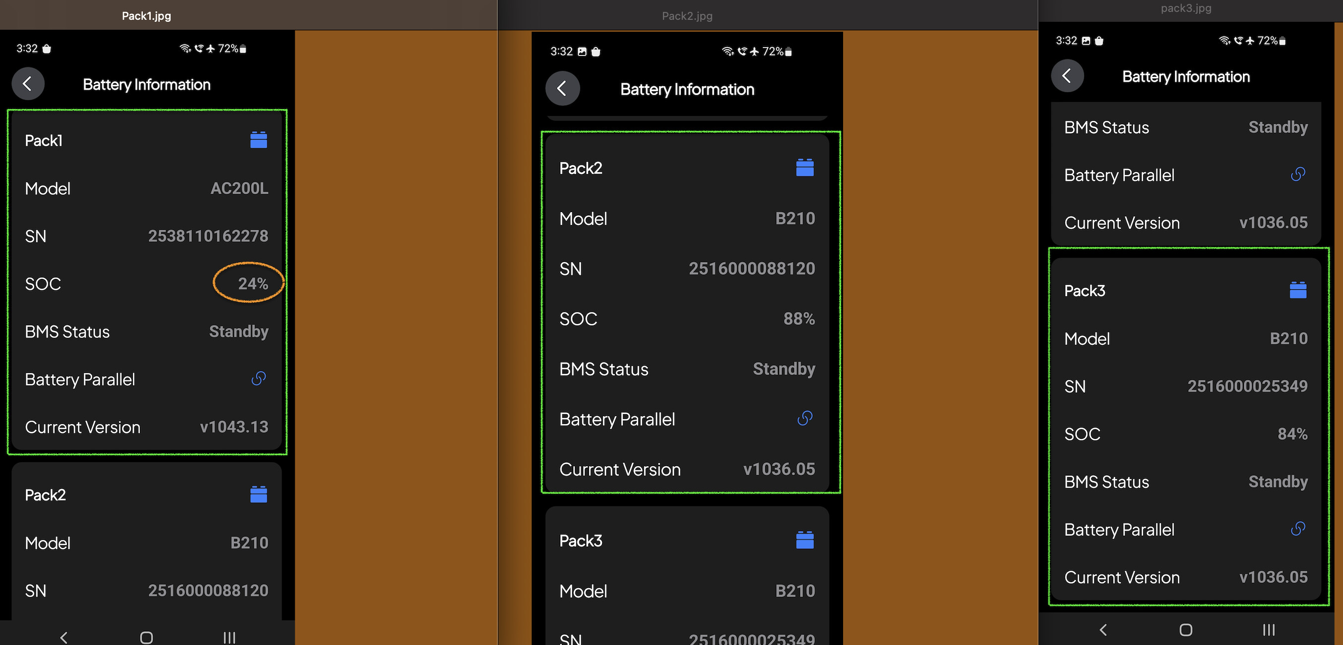

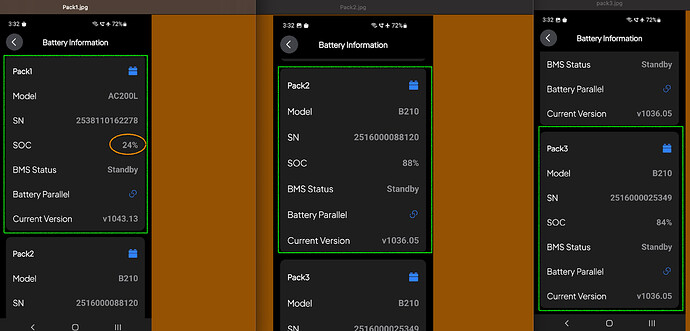

@BLUETTI_CARE I have same issue. Brand new AC200L with 2 x B210. During discharge the ACL200 (pack1) is SOC 24% vs the B210 SOCs are 88% (pack2) and 84% (pack3). It is very uneven SOC among packs.
Could you please send me BMS update too ?
Kind Regards
Hi @Ferine5, we have pushed BMS v105603 in batches—you can upgrade directly.
If you are unable to upgrade, it may be due to using a WiFi connection or a Bluetooth direct connection.
Please log in to the app, switch to Bluetooth connection, and then proceed with the upgrade.
Hi @dmc, thank you for getting in touch with us.
We have applied to upgrade your BMS. Our IT department will push the latest version of firmware to your machine within 24 hours. Please upgrade it tomorrow.
Please only connect one battery to the AC200L, and do not load any device when upgrading it.
After that, please recalibrate the system.

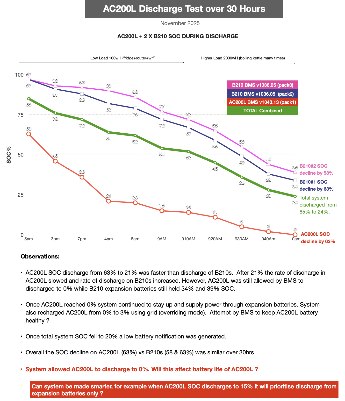

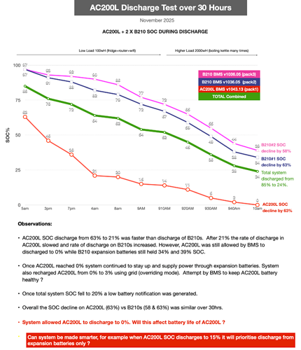

@BLUETTI_CARE Thank you. I have not received BMS firmware upgrade from your IT department. Could you please check.
Also, for clarification I ran a 30hr discharge test and graphed the result. Can you please confirm the future BMS upgrade will prevent AC200L discharge to 0% when B210 expansion batteries are still holding >30% SOC.
Thank you
