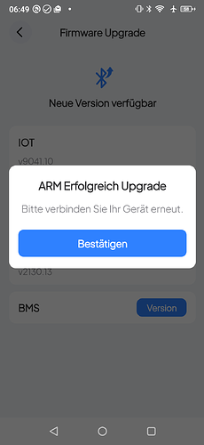

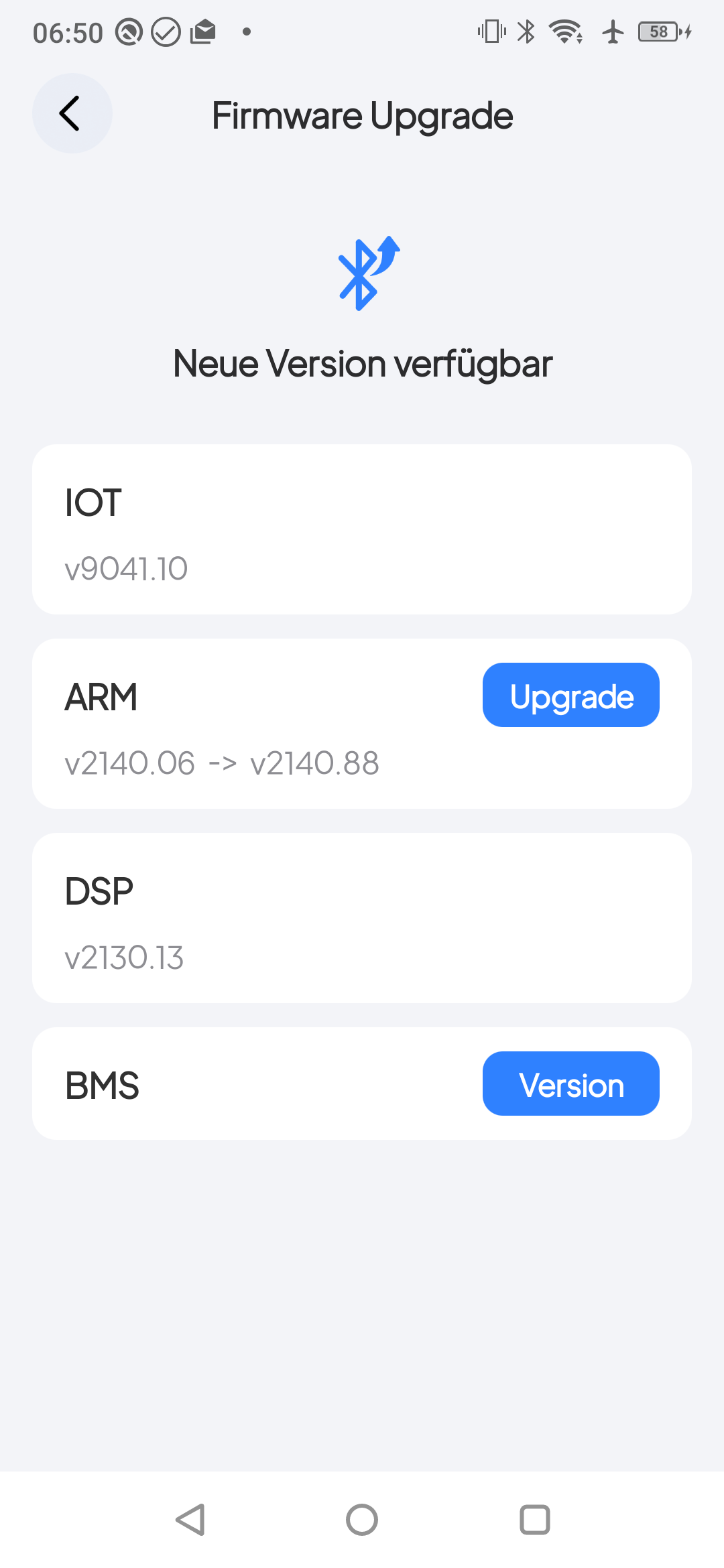

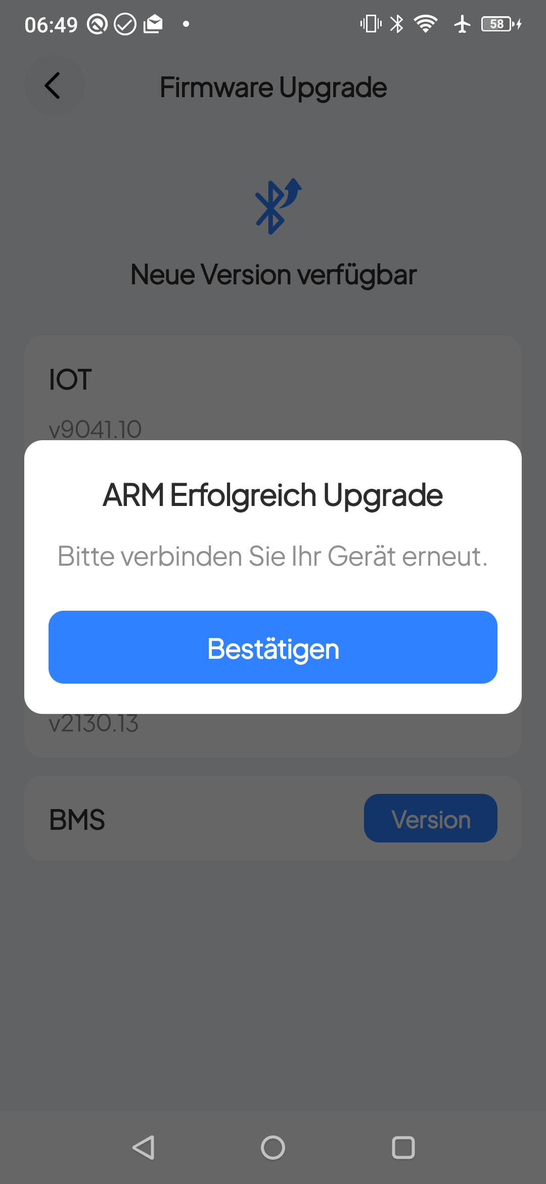

I tried to upgrade the firmware three times without success. As you can see in the three screenshots (I#ll post them in three posts, since I am allowed to pleace only one by one) and their time stamp, the firmware always goes back to the initial state of v2140.06. The powerstation confirmed three times the success of the firmware upgrade, but went back to it’s initial state, even after switching the powerstation of and then on again.
So, I’ll wait antil next release. But as I said, I am currently fine with v2140.06, it’s good enough for my purposes. Thank you and kind regards.

Hi @4montIntra, We checked the server data and found that your new firmware has actually been upgraded successfully. Please rest assured—there is no need to upgrade repeatedly.
Please ignore the upgrade prompt. We have already removed it, and now you will no longer be disturbed by the upgrade prompt.

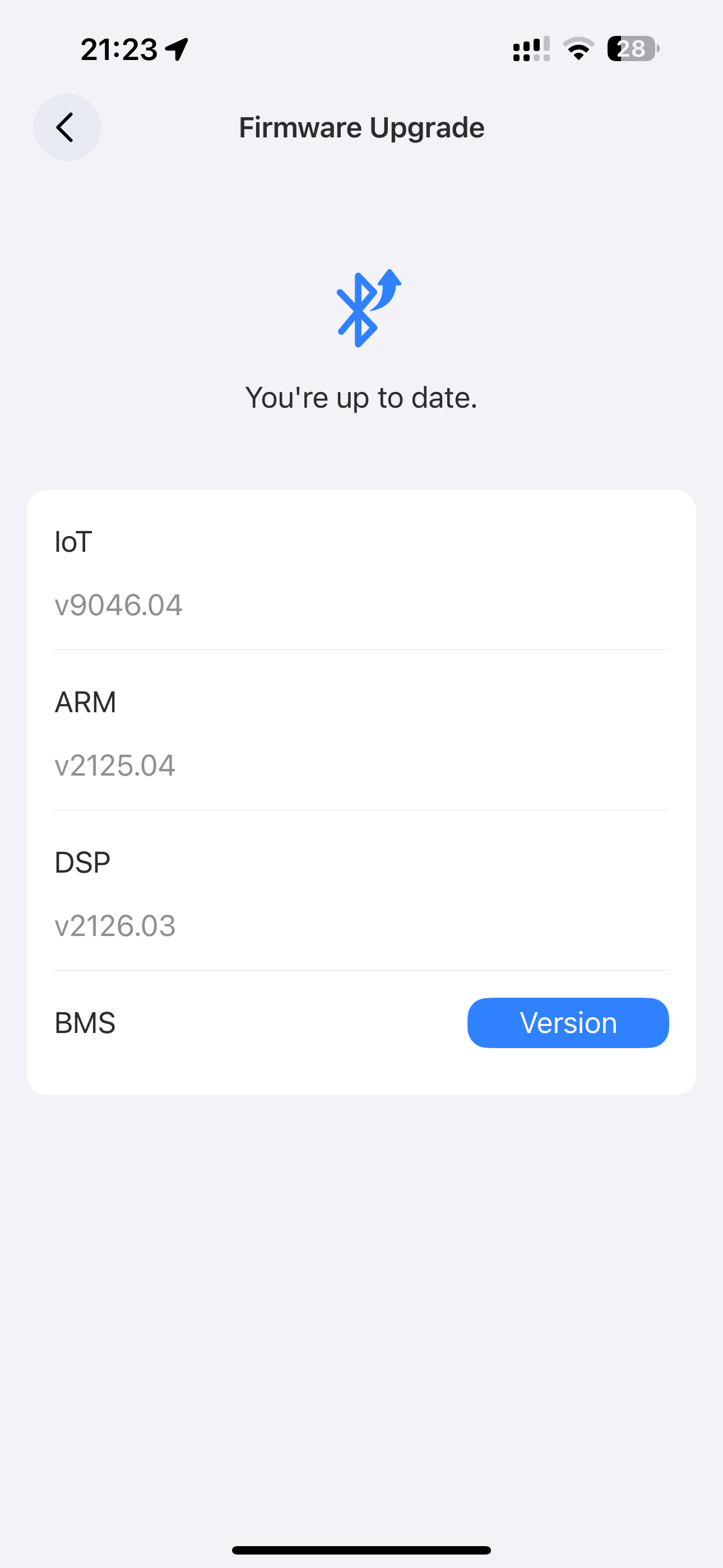

Hello, I purchased the AC180P today.
Then I went into advanced settings and enabled System Switch Recovery (screenshots attached).
  1. Then I enabled the AC output.
  2. I disabled the power by holding down the power button for 2 seconds.
  3. Then I tried turning it on by pressing the power button or by connecting to the network. In each case, after turning on the station, the AC port was disabled, even though the settings should have been saved. What am I doing wrong?
Or does this function only work when the station’s battery is drained to 0 and then the network is reconnected?

Hi @belka, We have found your comment. Please rest assured that we will follow up on this matter next.
We noticed that your firmware is already the latest version, so there is no need to push a new firmware update.
Yes, the AC180P will resume output only when its battery is fully drained; shutting it down will not activate this function.
Enabling “System Switch Recovery Mode” in the app allows the AC and DC power button settings to be saved when the battery drops to 0%. Once the battery level reaches 5%, the settings will be automatically restored.
Also, please note that AC output will only activate when the battery’s level more than 5%.
  1. When grid power is available, the output settings will resume as soon as the battery reaches 5%.
  2. When grid power is unavailable, the output settings will only resume if the battery reaches 5% and the output has remained off for at least 30 minutes.
Additionally, if your Bluetti app has been updated to version 2.3.10, you’ll need to input the password 88888888 to enable this feature.
