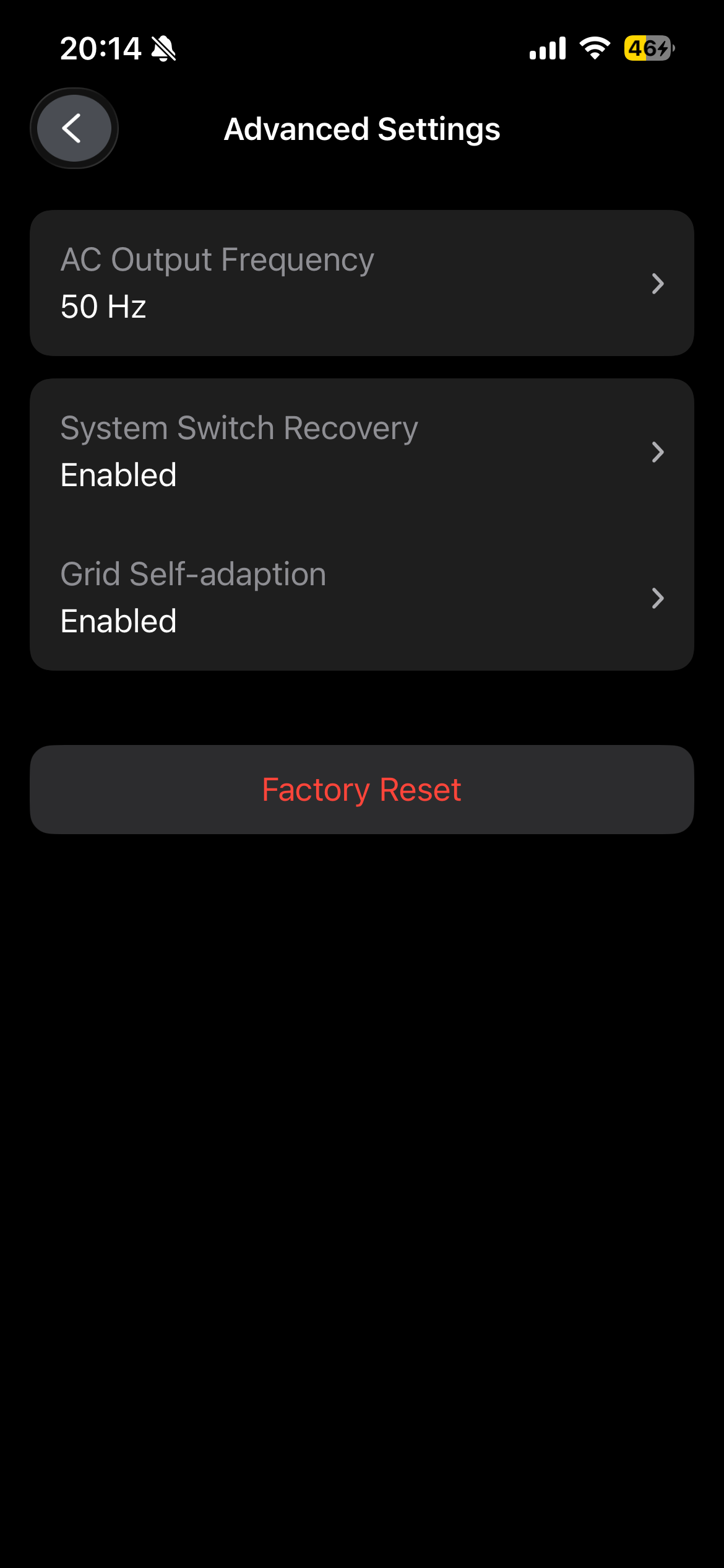

Hello.
The function switch recovery doesn’t work on my device.
Ac 180p
it is enabled in the settings
after the device is completely powered down. when the light is turned on, the ac and dc buttons do not turn on
How to make this function work?
AC180P2332001030357
Arm v2089.04
Dsp v2088.04
thanks for the help
@DmytroDubinin Have you waited till station is charged to 5%?

Everything works fine. I didn’t know about the 5%. As soon as the charge reached 5%, AC and DC immediately turned on.
Thank you.
