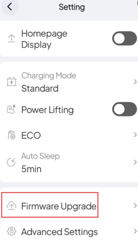

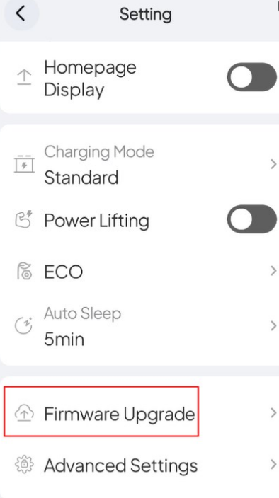

You can find it on the Settings page.
Then we will apply the new firmware for you.

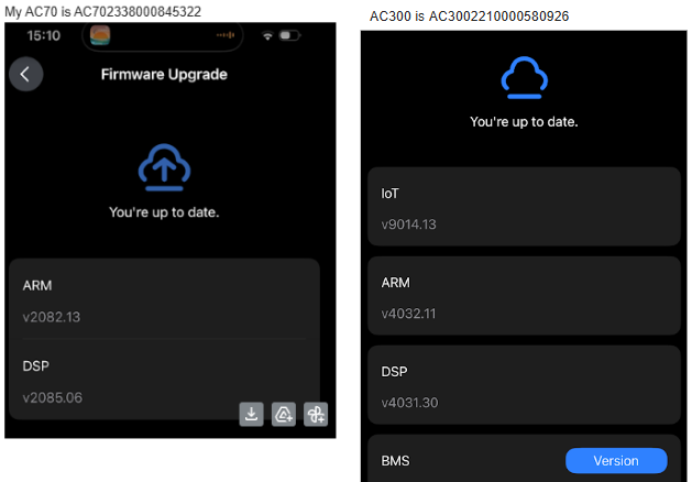

Here are the firmware versions of my AC70 and AC300, SN below. See screen shot for latest firmware installed.
AC702338000845322
AC3002210000580926

The version of your AC70 meets the requirements, so we have pushed the new firmware for you.
Now I have applied to upgrade your system to our IT department. They will push the latest version of firmware to your unit in 24 hours.
The version of your AC300 does not meet the requirements, so we cannot push it for you.
