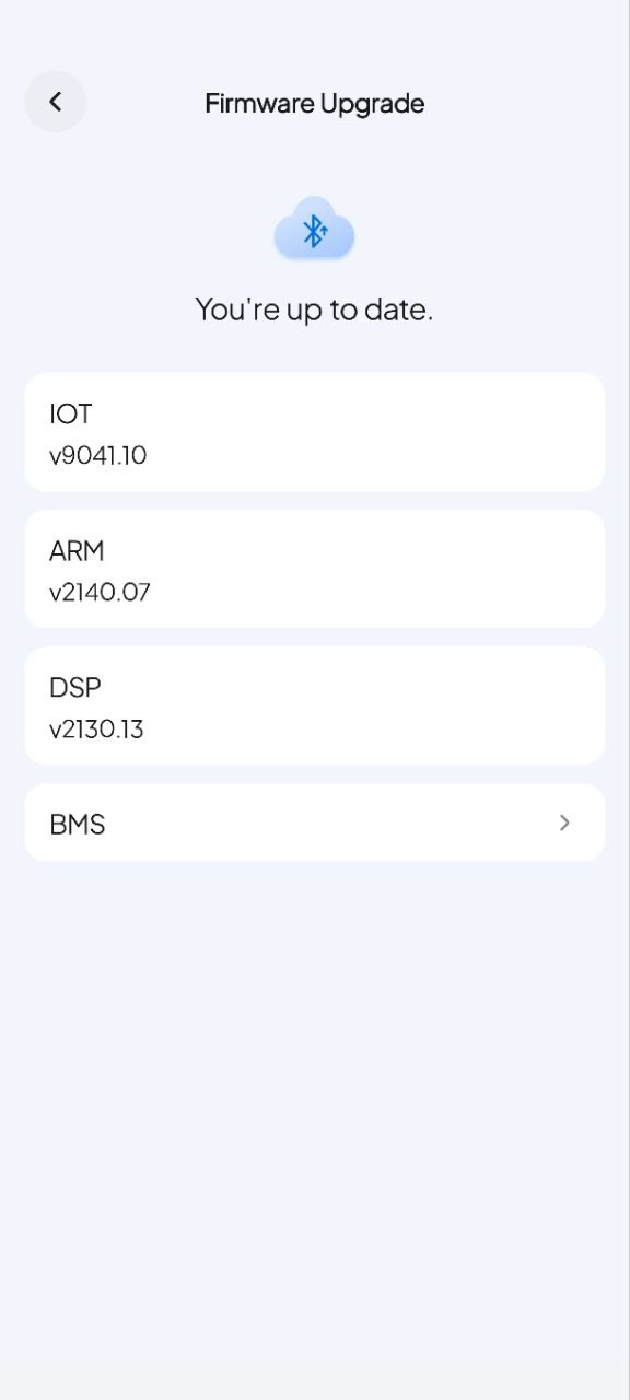

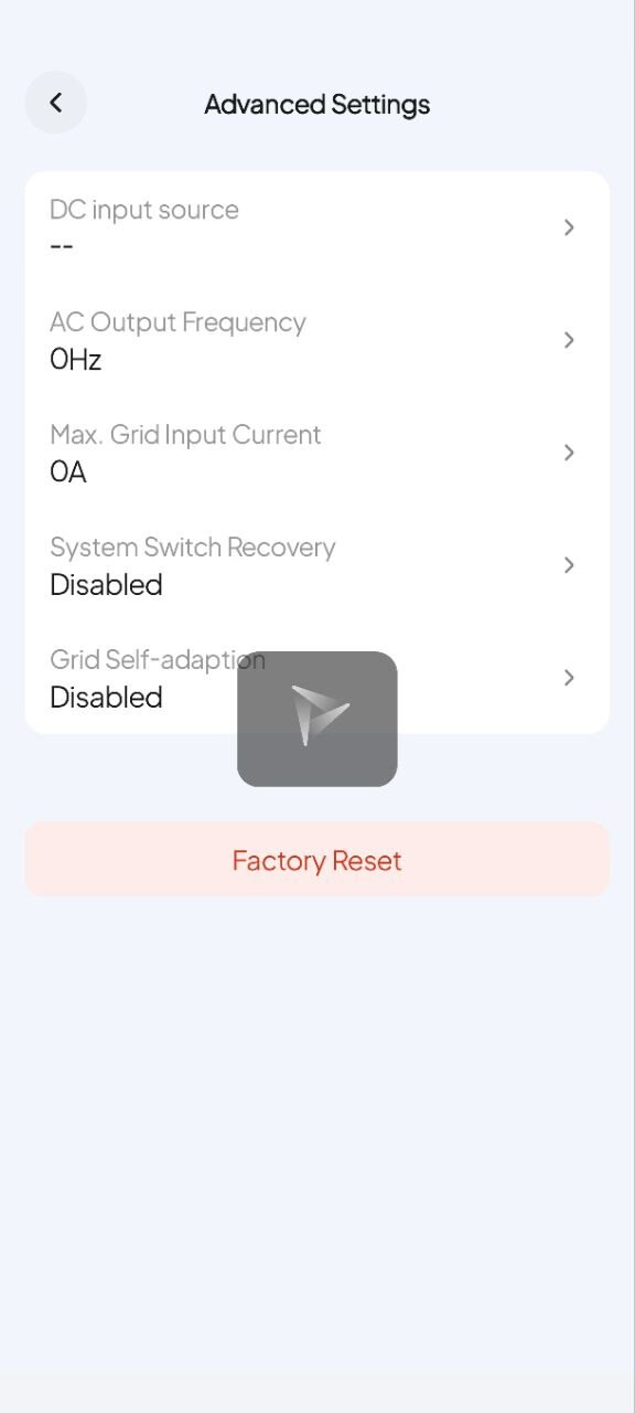

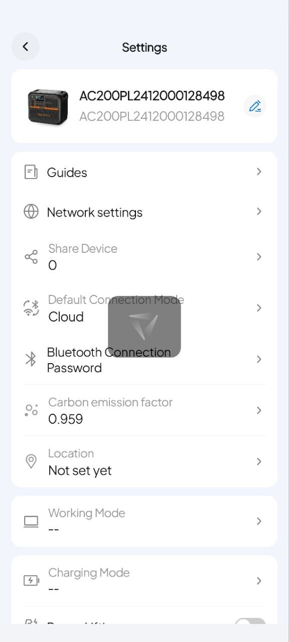

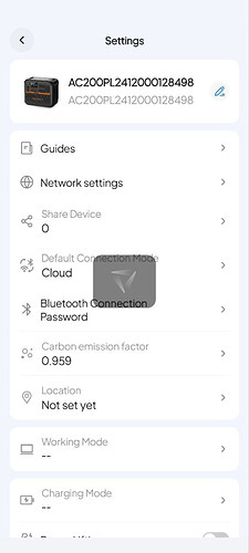

Hi @BLUETTI_CARE, @BLUETTI, I’ve received an ARM only update for my AC200PL (2140.05 to 2140.07). After successful installation the station itself is working fine, but it feels like there are some de-sync between station state and the application on the phone (which is of latest version on Android, connected via bluetooth). The app shows e.g. AC state is off, while actually it is turned on. Some settings are either zeroed out or not loaded at all (seen as --), there are spinner constantly appearing every time I switch app menus e.t.c. And the main objective of all this hurdle is not fulfilled: I still can not turn the AC switch autorecovery. Please, see some screenshots.
Maybe, I need some more updates, like IoT component? If so, please, push them to my device (ID is AC200PL2412000128498). Thank you!

We have pushed the latest firmware version ARM 2140.08 to your device. Please update both the firmware and your App to the latest version, then check if the issues are resolved.
Let us know if you need further assistance.
