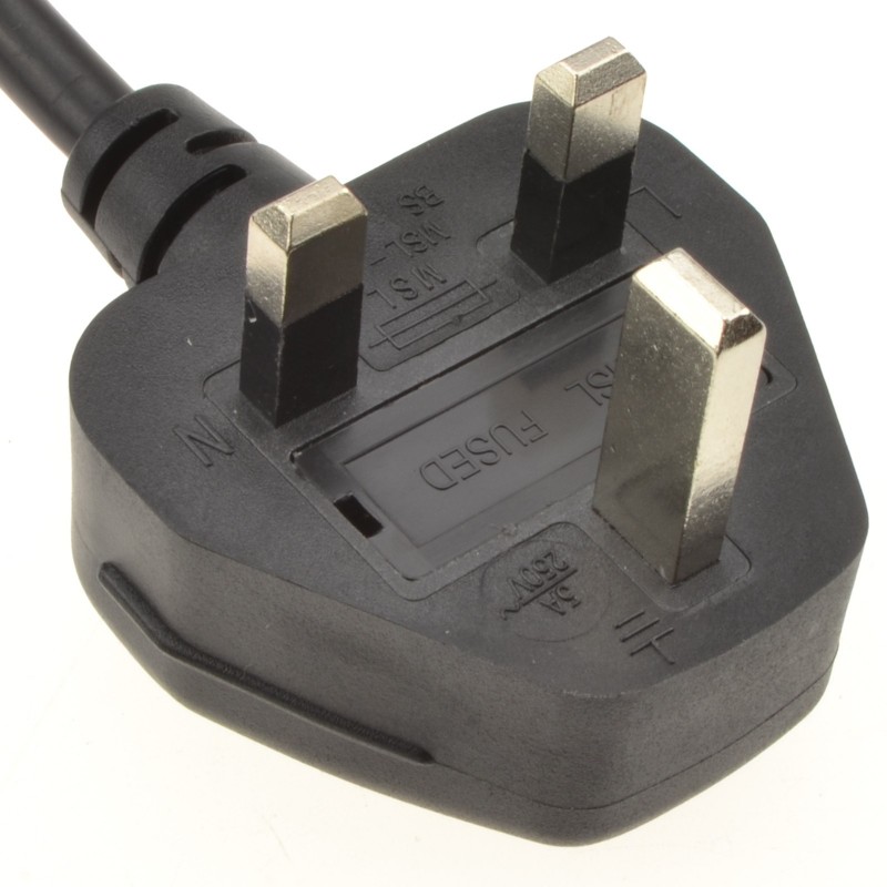

Ok i solved the issue, it was indeed grounding issue, this is what i did, i bought a uk type g plug then used the ground cable and connected earth cable to the plug and other side of the plug wire is connected to the waterheater body and it worked, it is recommended to connect the earth to real earth as well but i would assume since my boiler also screwed into the wall it is basically a real ground

Thank you <3 Its just one of these plugs with three wires, i bought a fused one for extra protection, one line is phase, one is neutral and third one which is green and yellow is ground i connected that ground wire to the ground wire of the boiler as well, ground wire is also connected to boiler chassis
So basically : eb3a - - >plug - - > wires - - → boiler chassis which is screwed to the wall
I am not using a different plug to power the boiler btw its all same plug and my eb3a has uk outlet, also dont worry if you have a different outlet basically all of the different type of plugs have ground capabilities its just a bit different
