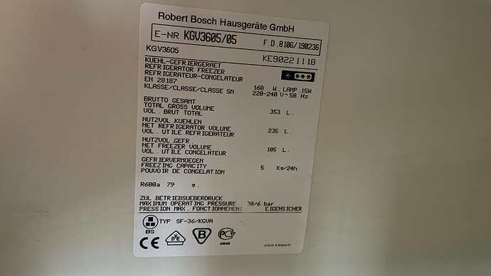

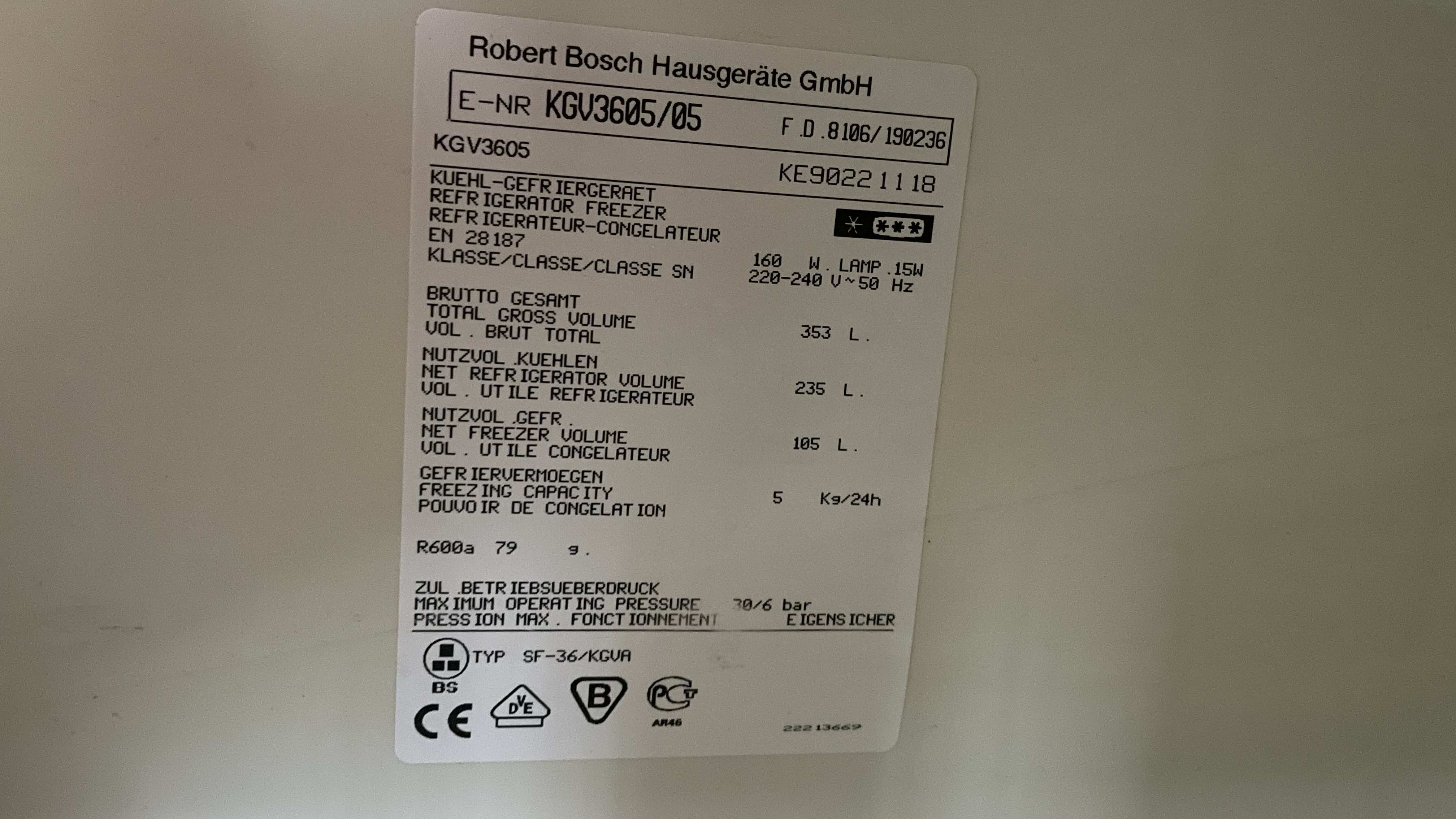

Dear all and dear Bluetti support team! A few days ago I’ve become a happy owner of the new station Premium 100V2. When using the station, the fridge does not work adequately. Its declared power is 150 W. Although the fridge is rather old, it seems to match the station by characteristics - it’s Bosch KGV3605/05 (photo of the label below).

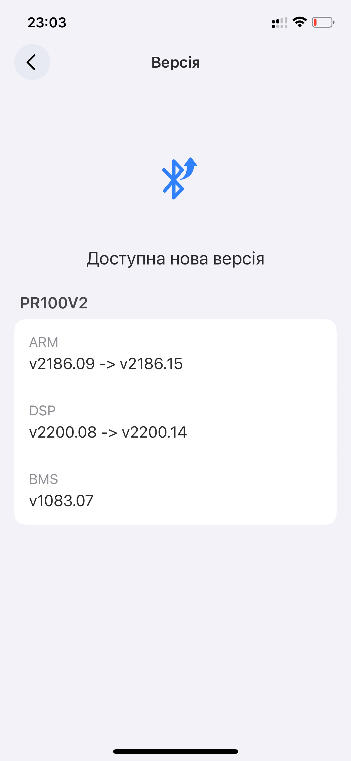

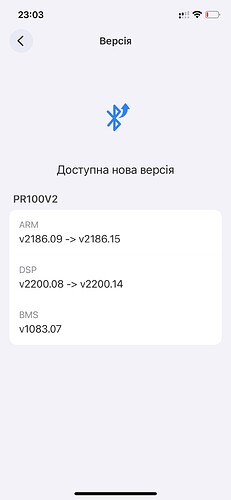

When the fridge motor starts, it releases a somewhat unusual sound, like it lacks something to run at full power. Today the fridge motor worked for an hour without stopping, and consumed 32% of station capacity during that hour. The output figures range from 0 to 506 W. The station is in the Power Lifting Mode, DC-ECO and AC-ECO deactivated. In the bypass mode (while station is charging and releasing power at the same time) everything is ok, but as soon as I deactivate charging and make the fridge feed purely from the station, the problem arises again. I would greatly appreciate any tips, hints, ideas and support, and also the possibility to download firmware in the app (since it shows that new firmware is available, but there is no “Download” button displayed, even when connected via Bluetooth). THANKS TO ALL AND TO THE SUPPORT TEAM IN ADVANCE!
Bluetti Premium 100 V2
IoT v8024.11
ARM v2186.09>v2186.15 (no download button or any other option to download, photo below)
DSP v2200.08>v2200.14
BMS v1083.07
S/N PR100V22528001796797

  3. Firmware situation is funny. From the looks of it, it’s the same firmware they pushed exclusively (as they said) for my unit to mitigate this problem.

  3. You won’t believe, but - yes) Yesterday, even while my topic was pending review for publication, I received the firmware update in my app. After I’ve installed it, the problem magically disappeared. I tested the station over the night (I use it to feed the fridge, 2 WiFi routers, lights in the apartment and some sockets during the power outages in Ukraine). With the fridge, 2 routers and a socket, there was 28% left in the morning after 7 hours of work at night, and the rhythm of discharge in the app was very smooth and rhythmic, let me say. So it’s definitely the firmware. I’ve found this community randomly - while using Chat GPT for solution. And I pray all people that encounter the same trouble will be able to do this!!! My best regards and support for all “beta testers”)))
