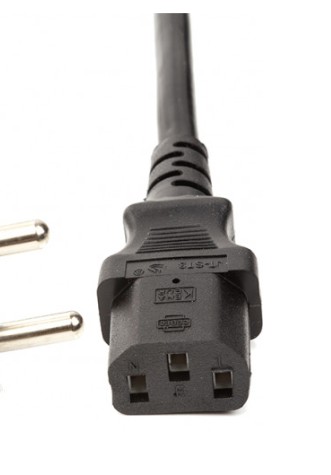

I don’t want to look hopelessly stupid)) but can you please tell me what power outlet I can use to plug the cord into? I guess we’re talking about this piece of cord to be unplugged from the station and then plugged into any other power outlet, right?
Снимок экрана 2026-01-16 123200
Disconnect the power cord from the station.
Plug the power cord into a 230V outlet.
Then plug the other end of the power cord into the station.
If the station doesn’t turn on, disconnect the power cord from the station (don’t remove the power cord from the outlet!) and try connecting it again, repeating this process several times.
If it doesn’t turn on after 30 attempts, don’t worry.
