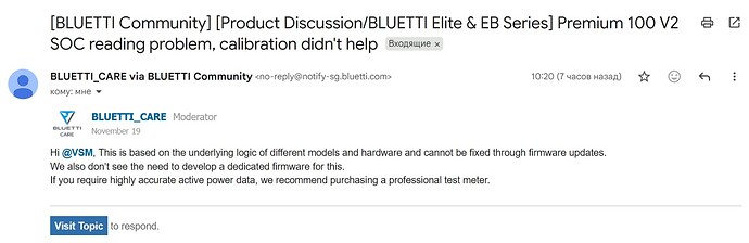

@BLUETTI_CARE I have re-tested following the update and messaged you the results.

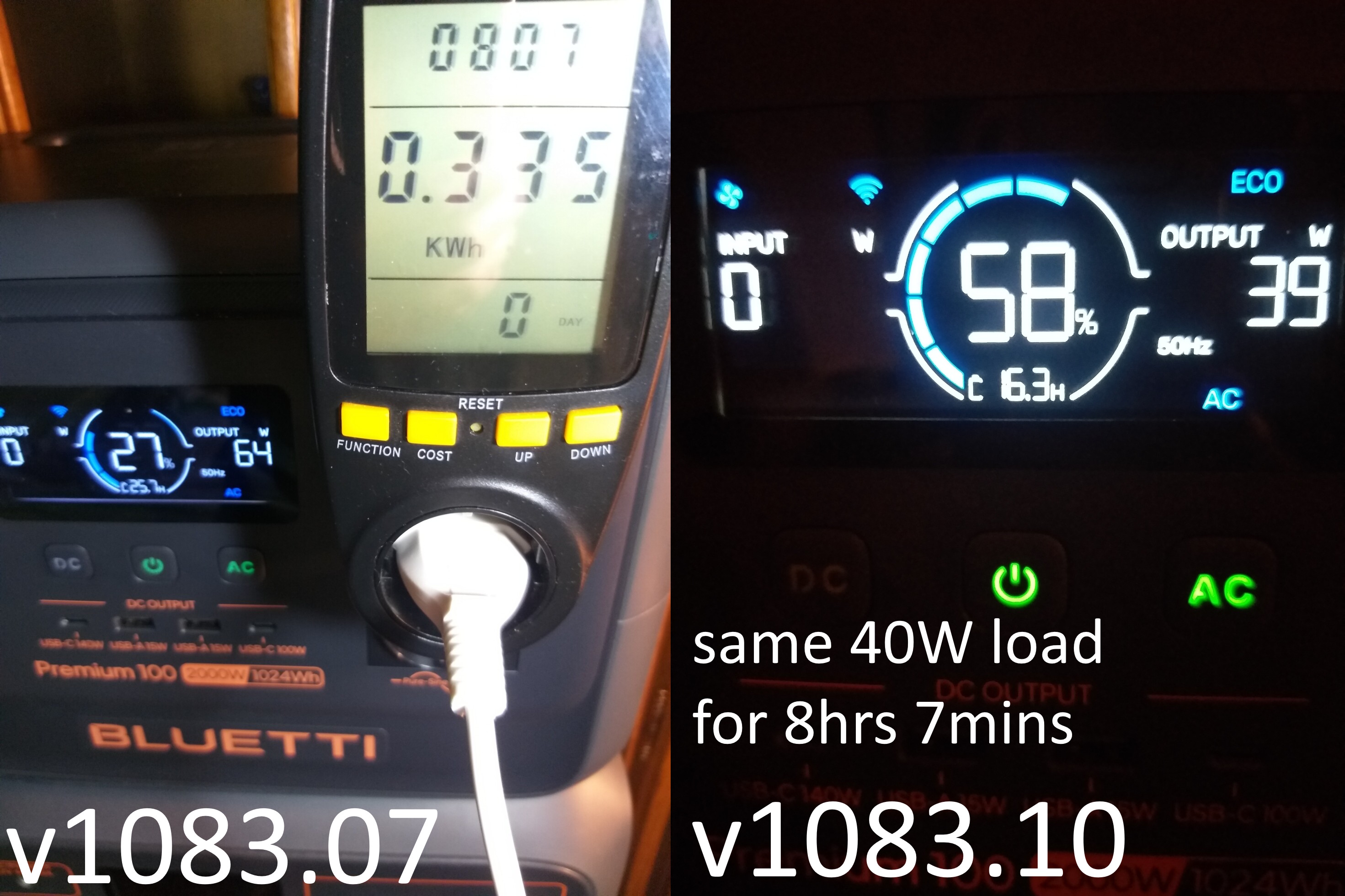

  2. Discharge with small loads - see pic below. I did the same - electric blanket set to 40 watts for 8hrs 7mins. Output, SOC, time remaining — it’s a day and night difference!
  3. Output reading: now, here’s the problem - it’s not quite there yet. I feel like loads under 50W are displayed as active power, but beyond that is still apparent power, because 60W becomes 75W on the display (it was 97W before, tho), and a 130W fridge is ~200W.
Nevertheless, the SOC reading is not the ravings of a madman now, and pretty accurate, time remaining too, and the unit is more or less usable now.

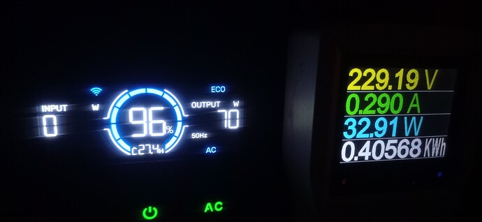

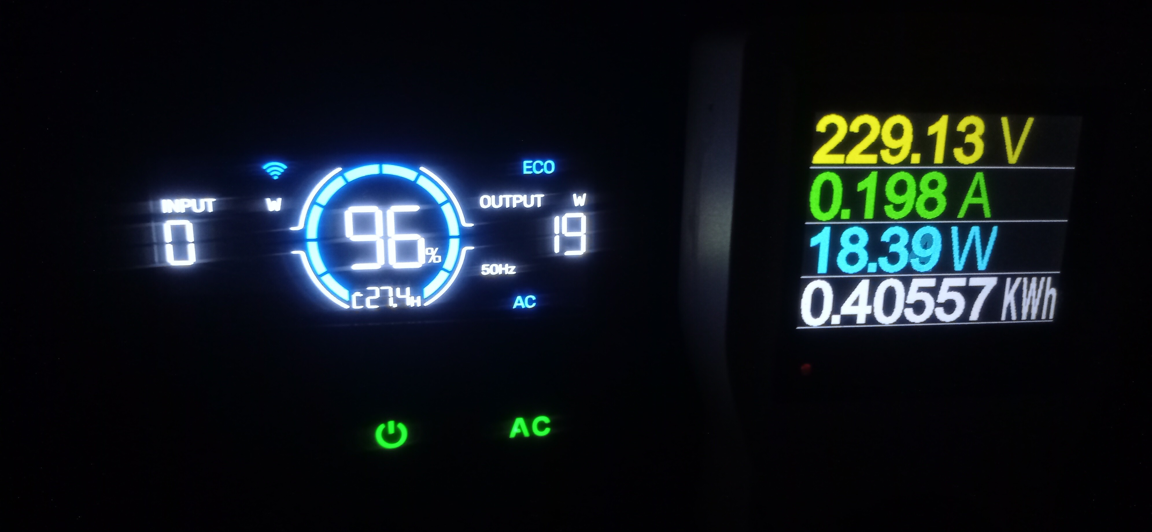

Hi @BLUETTI_CARE! The firmware arrived, I installed it. Thank you. There’s still something wrong with the wattage display; there are significant differences between the readings on the station screen and the wattmeter. But sometimes they match. Moreover, I connected different loads. It’s difficult to understand the relationship. For example, I have a router and 5 identical LED bulbs.

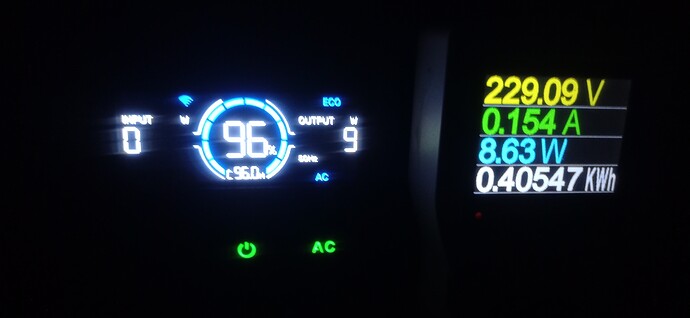

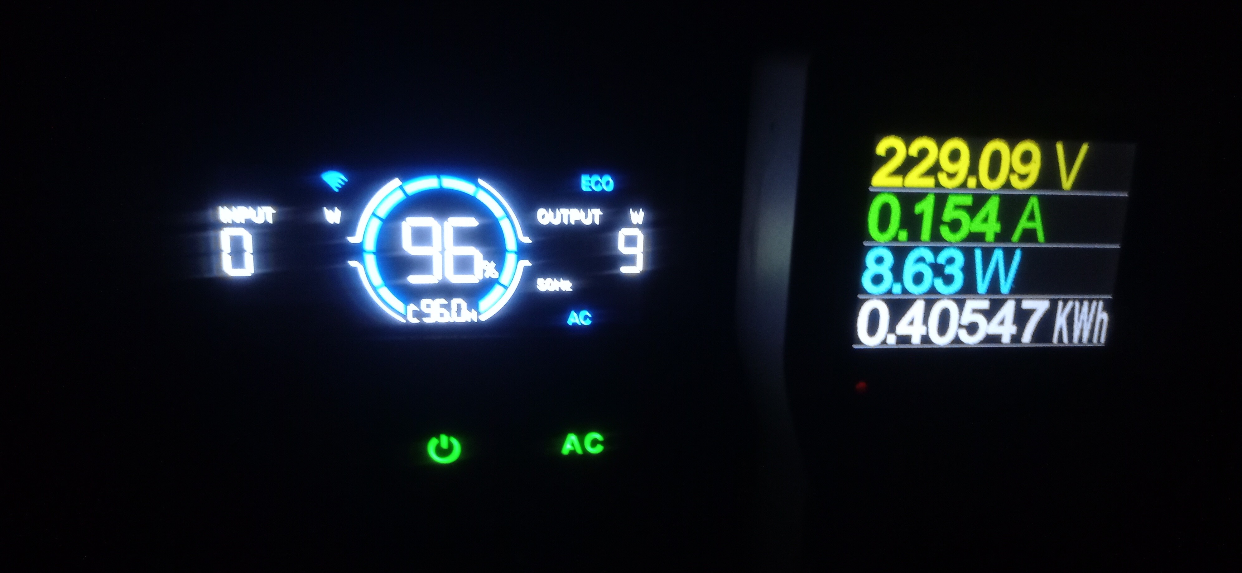

  1. One router works. Station -9 watts, Wattmeter -8.93 watts. - Excellent.

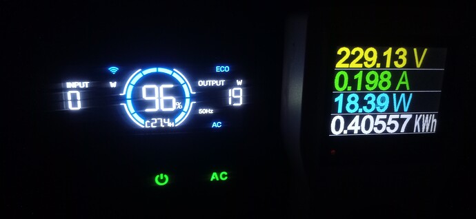

  2. Add 2 LED bulbs (approximately 5 watts each = +10 watts). Station -19 watts, Wattmeter -18.39 watts. - Excellent.

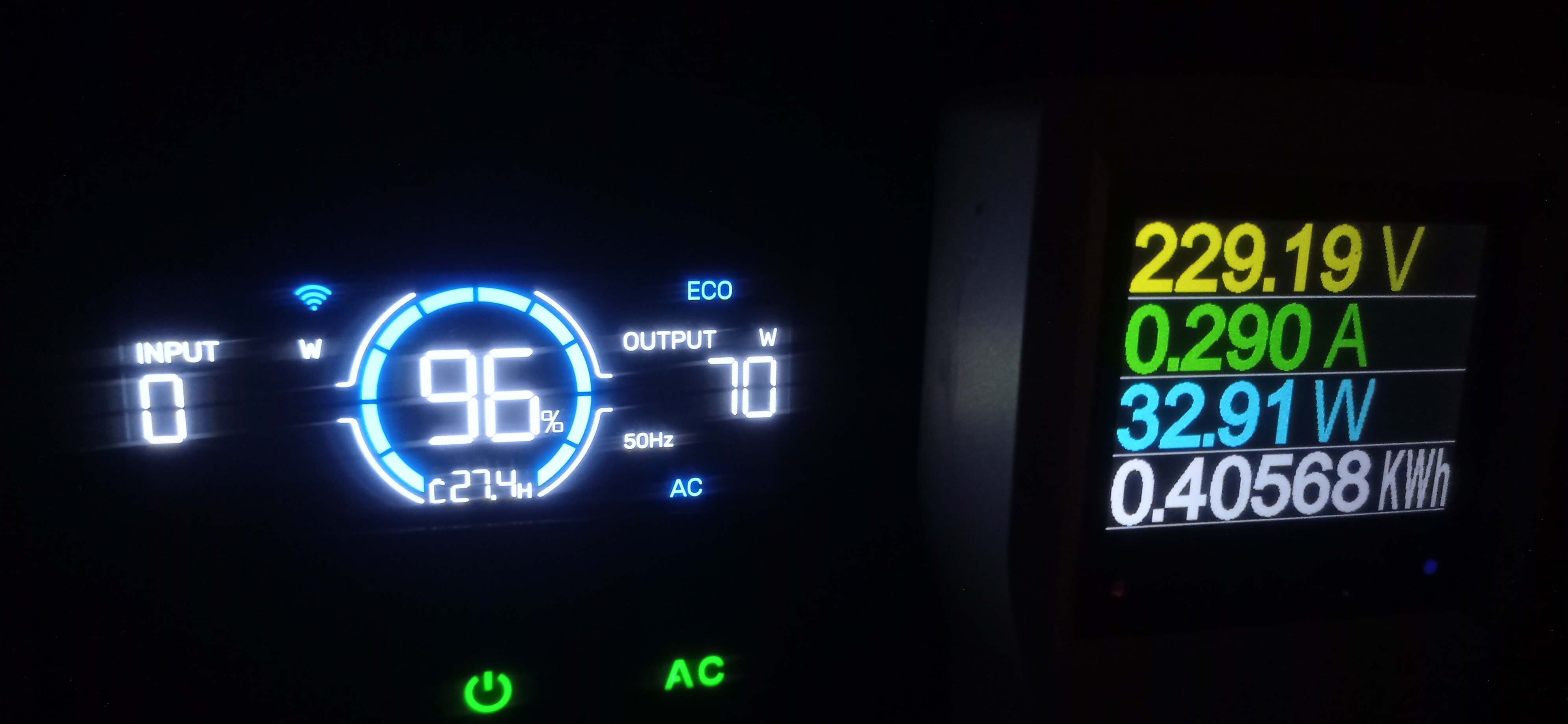

  3. Add 3 more LED bulbs (also 5 watts each = +15 watts). Station -70 watts (???), Wattmeter -32.91 watts. How the station shows 70 watts is beyond me. I’m attaching a photo.
    Maybe the developers will take the trouble to run these basic tests themselves.

Hi @lavash_bluetti, we have now received a response. For the Elite 100 V2, the screen will display the apparent power when the apparent power of the load exceeds 50W.
When the apparent power of the load is less than 50W, the screen will show the active power.
Your power meter should be displaying the active power, which causes the numerical difference under different power conditions.
When your power meter shows 32.91W (i.e., the active power is 32.91W), the apparent power at this time has already exceeded 50W—hence the Elite 100 V2 displays the apparent power.

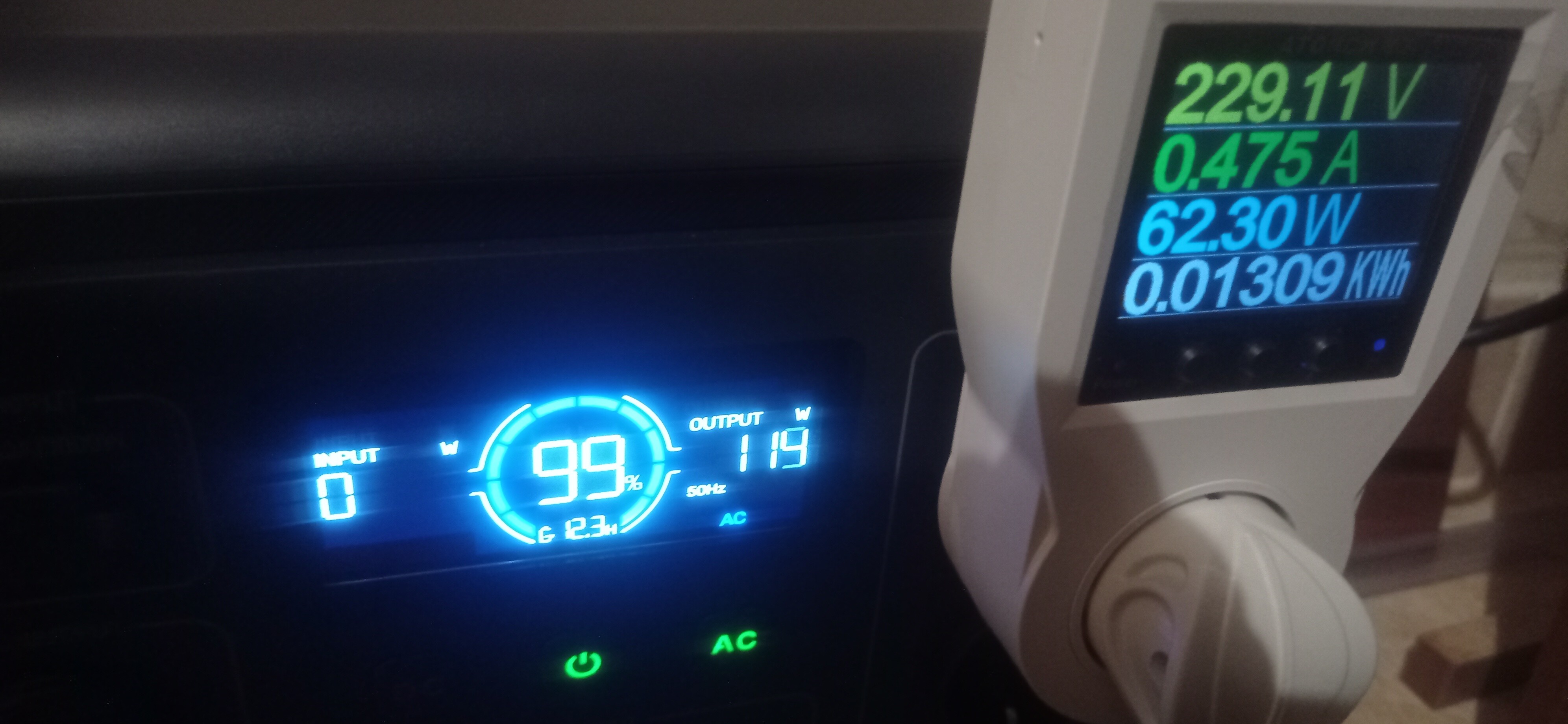

Hi @BLUETTI_CARE !
Let’s get back to the problem and I’ll try to explain why displaying total power is an error.
I don’t want to write a lot of theory here; read this explanation of active and reactive power.
https://www.google.com/search?q=What+is+active+and+reactive+power%3F&oq=What+is+active+and+reactive+power%3F&gs_lcrp=EgZjaHJvbWUyBggAEEUYOTIJCAEQABgTGIAEMgkIAhAAGBMYgAQyCggDEAAYExgWGB4yCggEEAAYExgWGB4yCggFEAAYExgWGB4yCggGEAAYExgWGB4yCggHEAAYExgWGB4yCggIEAAYExgWGB4yCggJEAAYExgWGB7SAQg5MDNqMGoxNagCALACAA&sourceid=chrome&ie=UTF-8
If you’ve read a bit of the theory, I’ll tell you why this is an error.
  1. The charging station display itself says “WATT,” which means it should only display ACTIVE power, which is measured in WATTS. - Is that clear?
  2. Look at two photos with the same load on two stations: an AC180 and an Elite 100V2. The load is LED lighting (LED bulbs only). The difference is obvious. - Make it like the AC180!!!
  3. Now, why is it practically more convenient to see active power? We use active power in our everyday lives. We know that a lamp uses 10 watts, a refrigerator uses about 100 watts, and so on. And so, when you have no power for 15 hours a day and you use a charging station, you always look at the station display and estimate the load, mentally adding up all the devices turned on, wondering if you’ve turned on anything unnecessary. And the figure of 115 watts in the example photo raises questions – where does it come from if only the LED lighting is on? Why do I need to know the reactive power???
Let me give you a simple, abstract example. When you’re driving, do you look at the speedometer? You see 50 km/h there, but the speed limit signs on the road are also in km/h.
So imagine that the car manufacturer decided to display your speedometer not as your ground speed, but as your sun speed, while the signs on the side of the road remain ground speed.
So, do you understand the problem?
