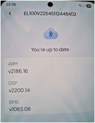

No new firmware yet…
Unfortunately my app still shows that I am up to date with
ARM v2186.16
DSP v2200.14
BMS v1083.08
I don’t know what I am doing wrong…
Still no firmware…
Holidays ?

@LvdK @Dragline fyi, it was BMS v1083.07 which caused major issues with SOC readings and my meltdown itt, so they gave me v1083.10.
I’m not sure which publicly available BMS version is the latest (.08 or .09) and the difference between them and .10.
Maybe there are none :man_shrugging:
