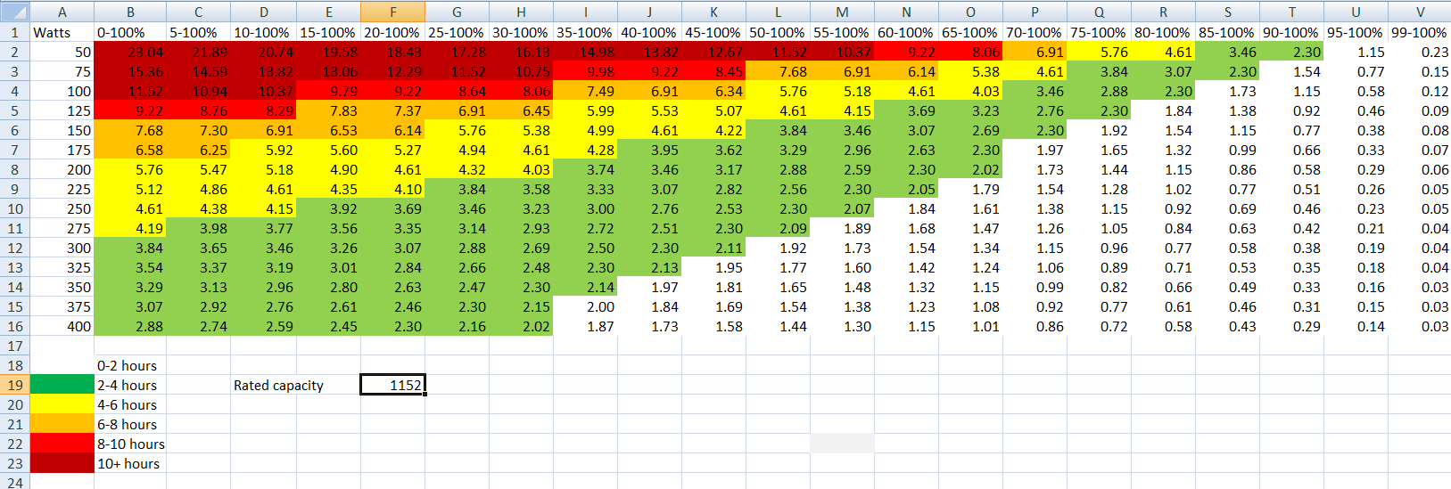

With that said I built a spreadsheet a while ago for my AC180 that tells me what my estimated recharge time would be to refill the battery at a certain state of charge (assuming 90% charging efficiency in formula) at a certain constant solar input. So to give you an example if you have 25% battery left, but its overcast and your panel is getting you only 50 watts, it will take 17 hours to top off the battery (simply not enough solar potential).
Let’s say you get two panels and run them in parallel to double your output to 100 watts. It would still take over 8.5 hours to top it off. Assume you get 12.5% output when its dense low cloud cover, 25% output when its thick clouds and 50% when its overcast but not as dense. Well if you have two 350 watt panels in parallel, 12.5% of 700 watts is 87 watts, 25% is 175 watts, while 50% is 350 watts.

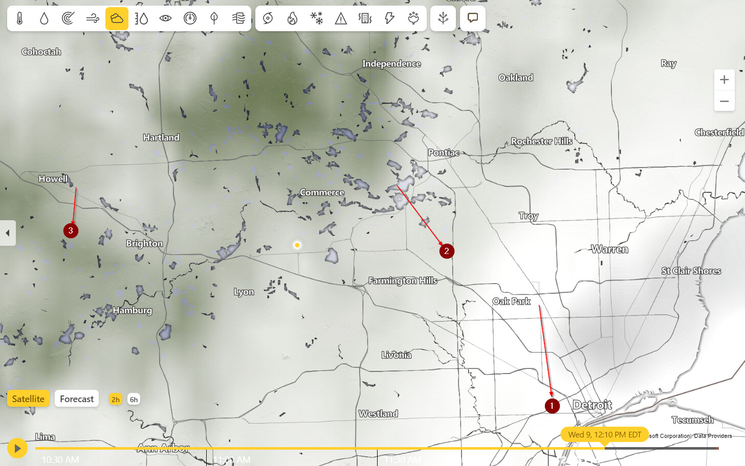

Let’s do a thought experiment. Assume worst case scenario for 3 straight days we get 12.5% output.I consume 950Wh per day from my usage. At 12.5% output and running two 350 watt panels, I would generate 696Wh per solar day. A net loss of 254Wh per day. If I had an Elite 100, with a 90% depth of discharge I have 921Wh available. 921/254 = 3.64 days before battery would run out from a net negative charge rate. This assumes I average 87 watts over the course of 8 hours of available Sun. With the Elite 200 V2 it would be 1865/254 or 7.34 days. Granted its not as cut and dry and just leaving out your solar panels all day, because for example the Bluetti foldable panels are not IP68 waterproof. You may lose some time due to rain, but this just gives you a general idea of what you could manage in terms of solar potential vs system sizing (aka your real world usage per day).
Cloud cover around #3 will generally net me around 50% power, 25% around #2, and 12.5% or below around #1.
