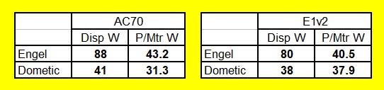

I tested the Elite 100 & the AC70 running 2 fridges from 240VAC. The first fridge is a 40lt Combi Engel. It can run from 12VDC or 240VAC. It has a Sawafuji Swing motor compressor, which is an electro magnet pulse reciprocating piston, i.e. no crankshaft or electric motor. The second, is a Dometic 110lt Fridge freezer and also runs from 12VDC & 240VAC. However it has a standard crankshaft type compressor. It also has a power brick type 240VAC input, which tells me is is a 12V motor. Here are the results.
FRIDGE TEST
Of note: Neither power station is directly running the Dometic fridge, they are powering a power brick.
Both the AC70 and the Elite 100, are showing a power output (80+W) almost double that of the power shown the Engel is using (40+W).
The important point - Both fridges work as they should from both power stations. :grin:

With some loads there seems to be approx 10% more Watts on the power station, than the device draws. On other loads, in particular fridges, the power station display is approx double the actual load.
I am at a loss to explain why!
