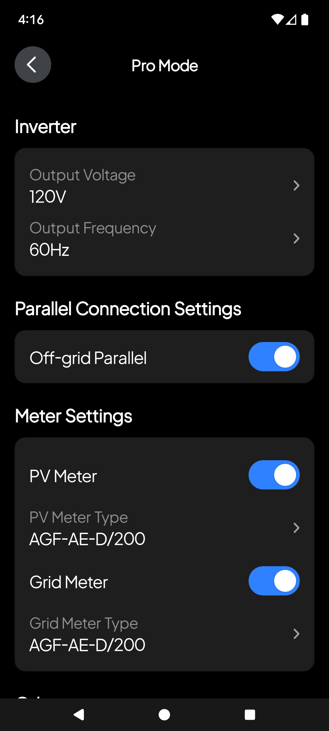

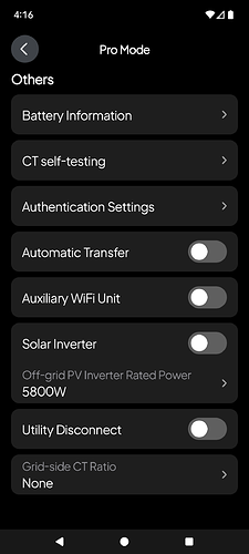

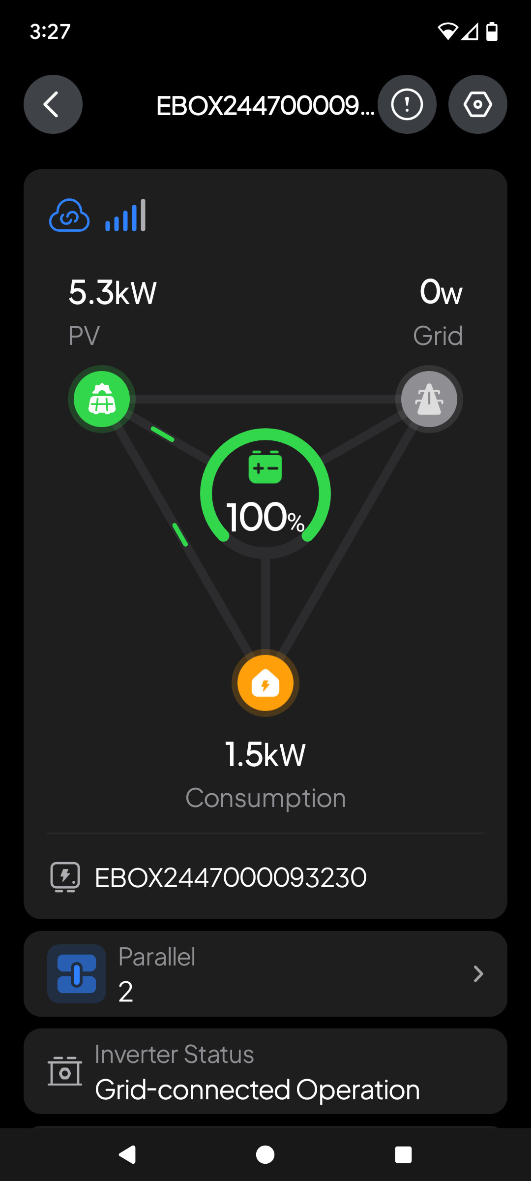

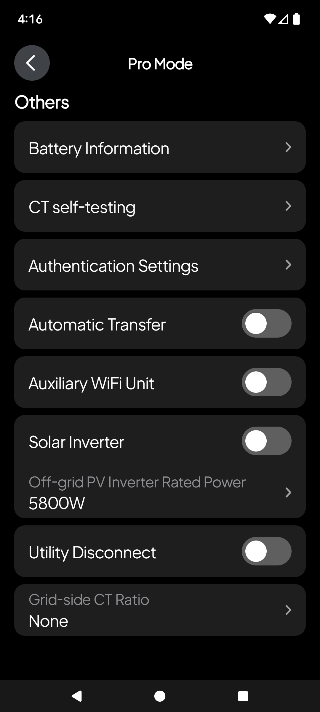

I’m having trouble getting my 3rd party pv array to export excess solar after both EP900 show 100% charge. How do I enable this? I have it AC coupled (grid side/main panel) to an Enphase IQ8A 8KW array with a max output of 5.8KW.

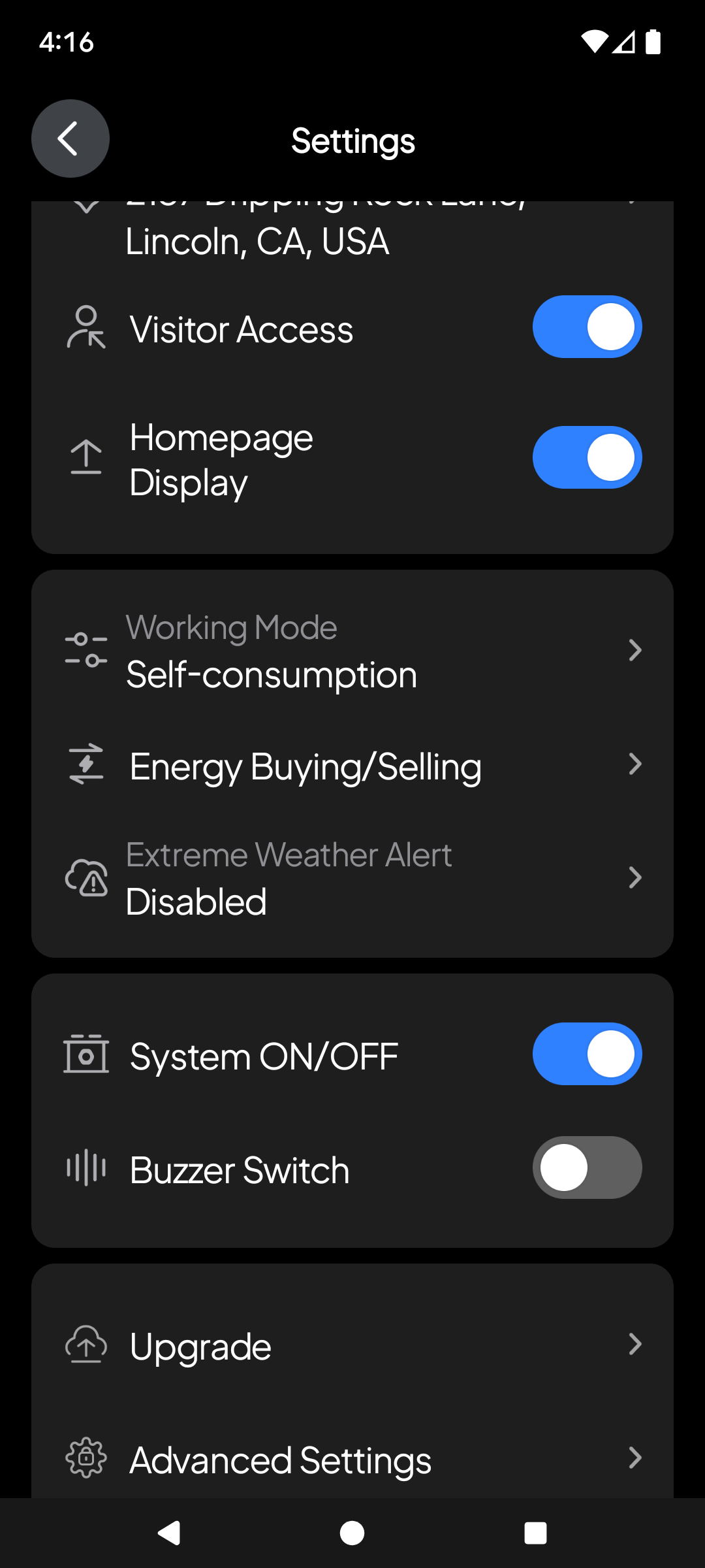

Ok, I think I have it figured out. If I
- Change working mode to Custom.
- Disable Time of Use

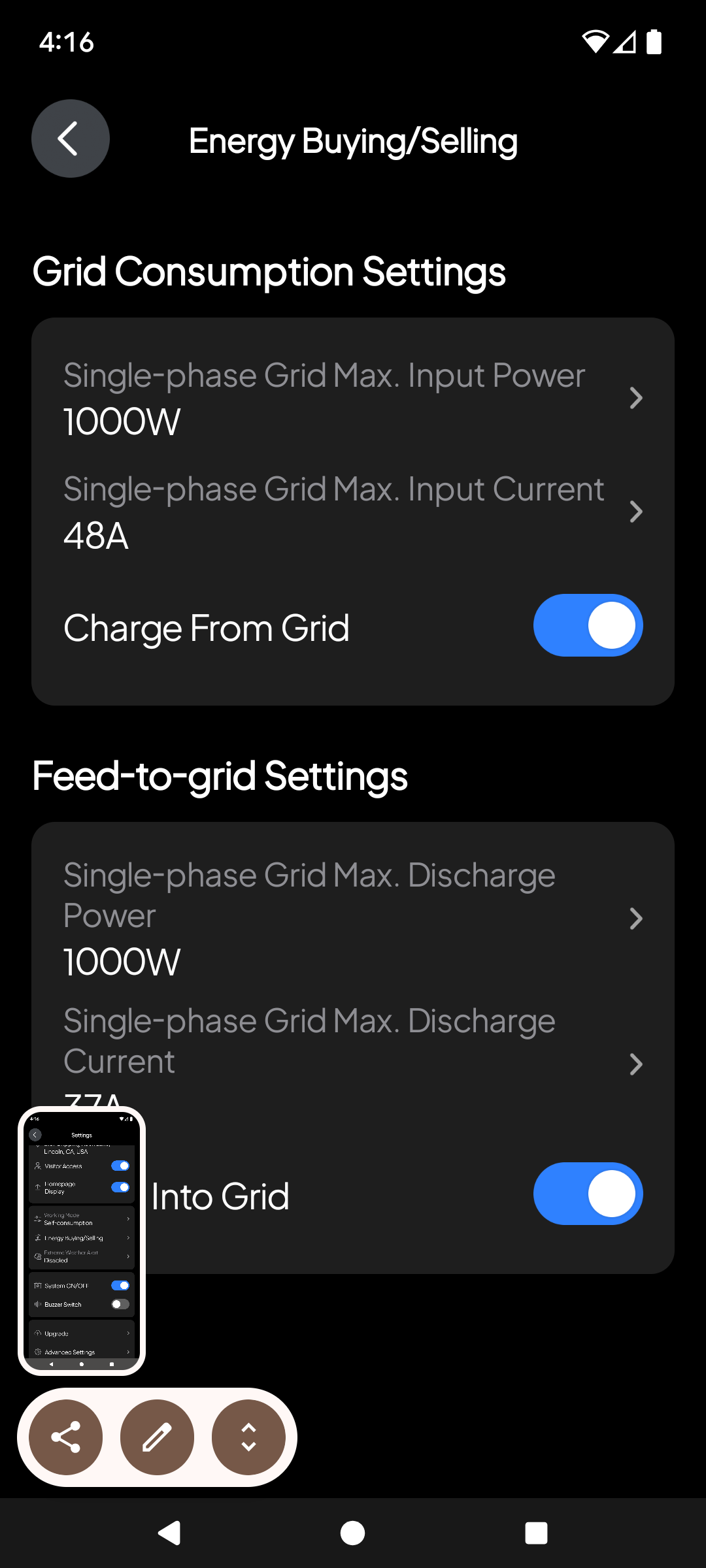

- Set SOC limits to 20%-94%.
- Turn on Charge from Grid.
- Turn on Feed to Grid (a value to ensure the 3rd Party PV array exports sufficiently to grid)
Then the ESS will charge from solar between 20-94%, then at 94% it will export ONLY PV? While maintaining the 94% SOC until PV is not longer sufficient for home consumption? Is this correct?
Please Note, My PV array is NEM 2.0, so I need it to export any excess generation, and only from the PV array. I’m waiting for PG&E to set an NGOM. I cannot have the ESS export any power to grid.
