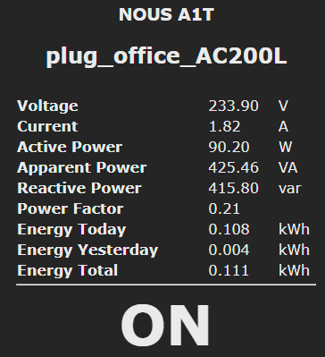

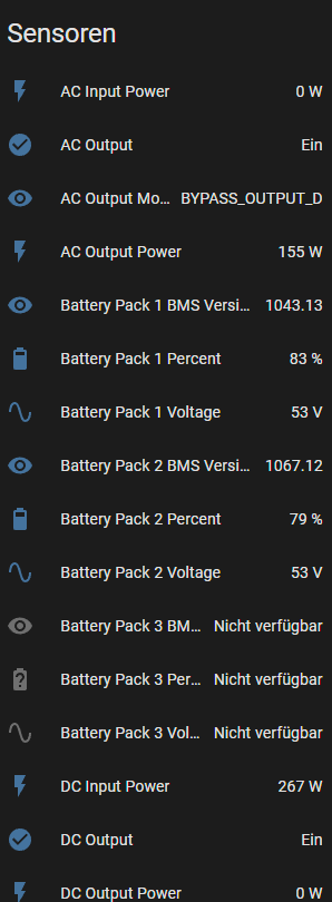

I discovered that the AC inverter seems to be hardwired in some way to the grid. The setting to use charging from the grid is ignored, so there is always a drain from the grid. I verified this with a wifi smart plug that I plugged in my wall socket and the AC200L in that. When I turn of the AC inverter the power draw from the grid stops. The power draw is not equal to the connected AC load. The grid power draw in the app is shown as 0W. The actual power draw is around 90W and the AC Load is around 157W. PV input is 257W.

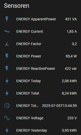

This means: The inverter couples inductive or capacitive to the grid to synchronize Volt and Frequency. For this it needs a small dummy load present to the grid to have a current flowing that can be monitored. My tasmota plug shows a relatively high current flow but a very low power factor (aprox 0.2). This means the grid usage we see is only for synchronizing to the grid itself. I can further confirm this when I disconnect the grid (aka turn of tasmota plug). Then the Voltage and Frequency deviate slightly from the grid. Bluetti also mentions a short switch over time (aprox 22ms) in USV mode which resembles the ramp up time of the internal generation of voltage and frequency.

When you mentioned, “If I check the input side (grid) and output side (load) in the Bluetti app, I see that the values for voltage and frequency are exactly the same,” — that’s expected. When using grid charging and there is an active AC load, the system enters bypass mode, and the voltage and frequency will sync exactly with the grid.
If your goal is to disconnect from the grid during non-charging periods, but still allow charging at other times, you’ll need to control the charging power by limiting the current. A display of 0W means the input is 0W, which already meets this objective.

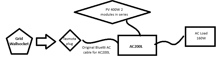

I hope my drawing makes things a bit more clear.

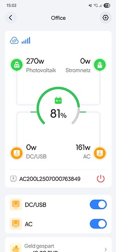

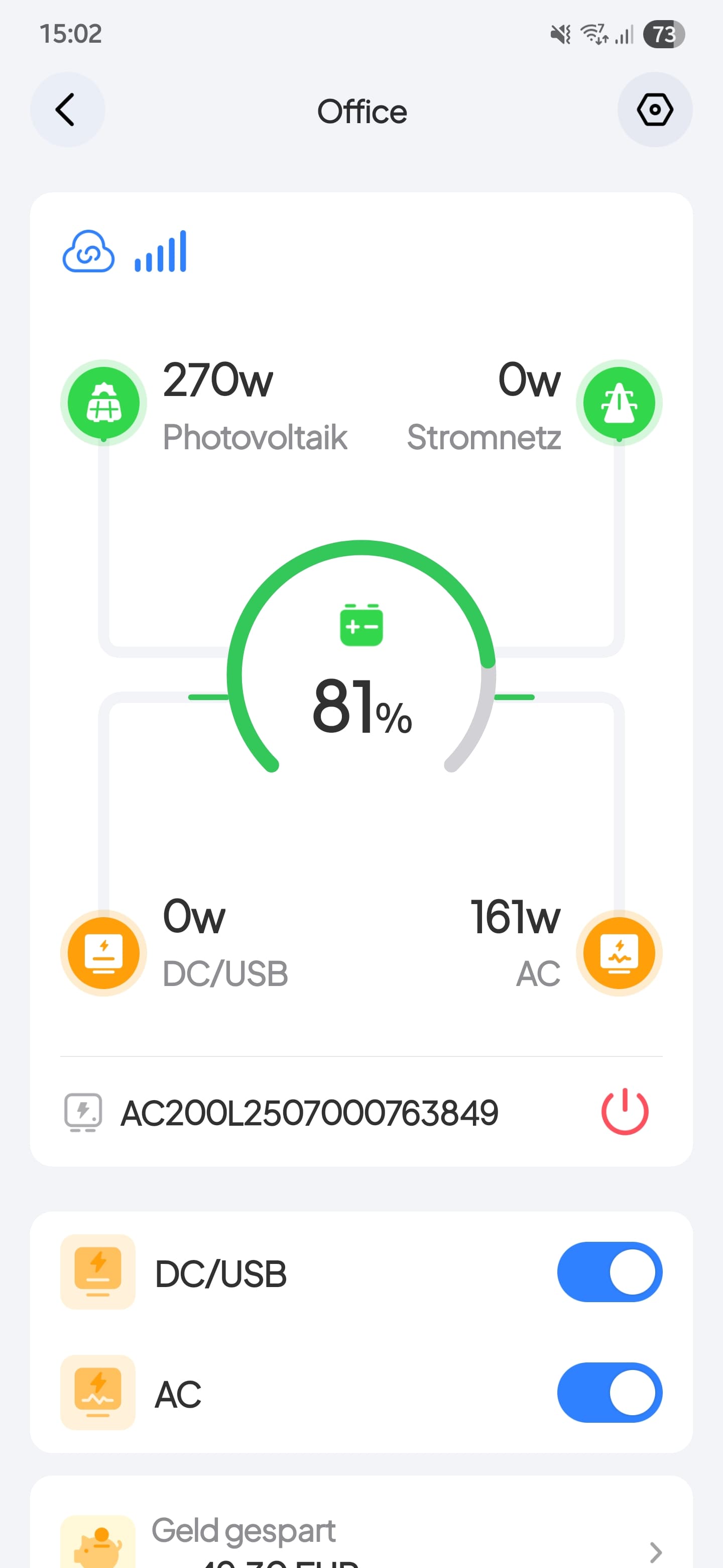

What I tried to describe is: AC200L shows 0W grid usage while tasmota plug shows 90W power draw with PF of 0.2. That means the AC200L is drawing power from the grid but the app shows 0W. The problem I have is: the 90W are actually billed because they are Active power which count as normal power usage. It is just like plugging in a 90W light bulb for 24/7. When the bluetti app shows 0W, I have to assume that it does not draw ANY power from the grid. The reality in my case is different: It draws 90W 24/7 which is too much and not acceptable. I refered to a dummy load because I assume that is how the inverter is synched to the grid when he is in bypass mode. If this is not switchable or not even possible to disable bypass mode that is actually very unfortunately.

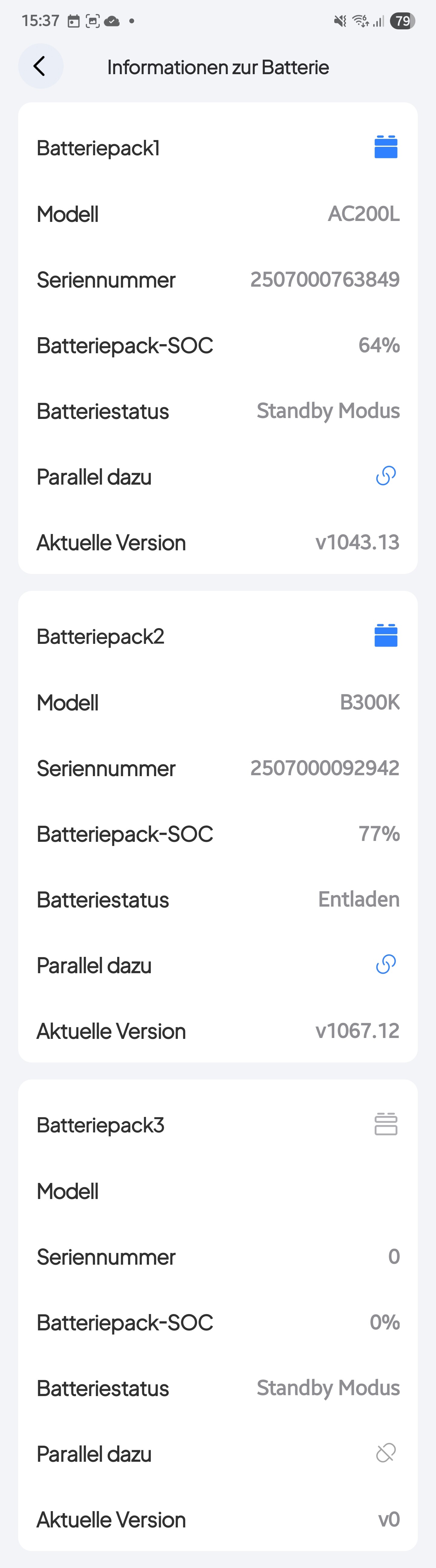

Regarding the power loss tests: Just to make sure it does not get lost in conversation: My AC200L has a B300K connected to it. Maybe this is relevant for the tests, but I do not know for sure.

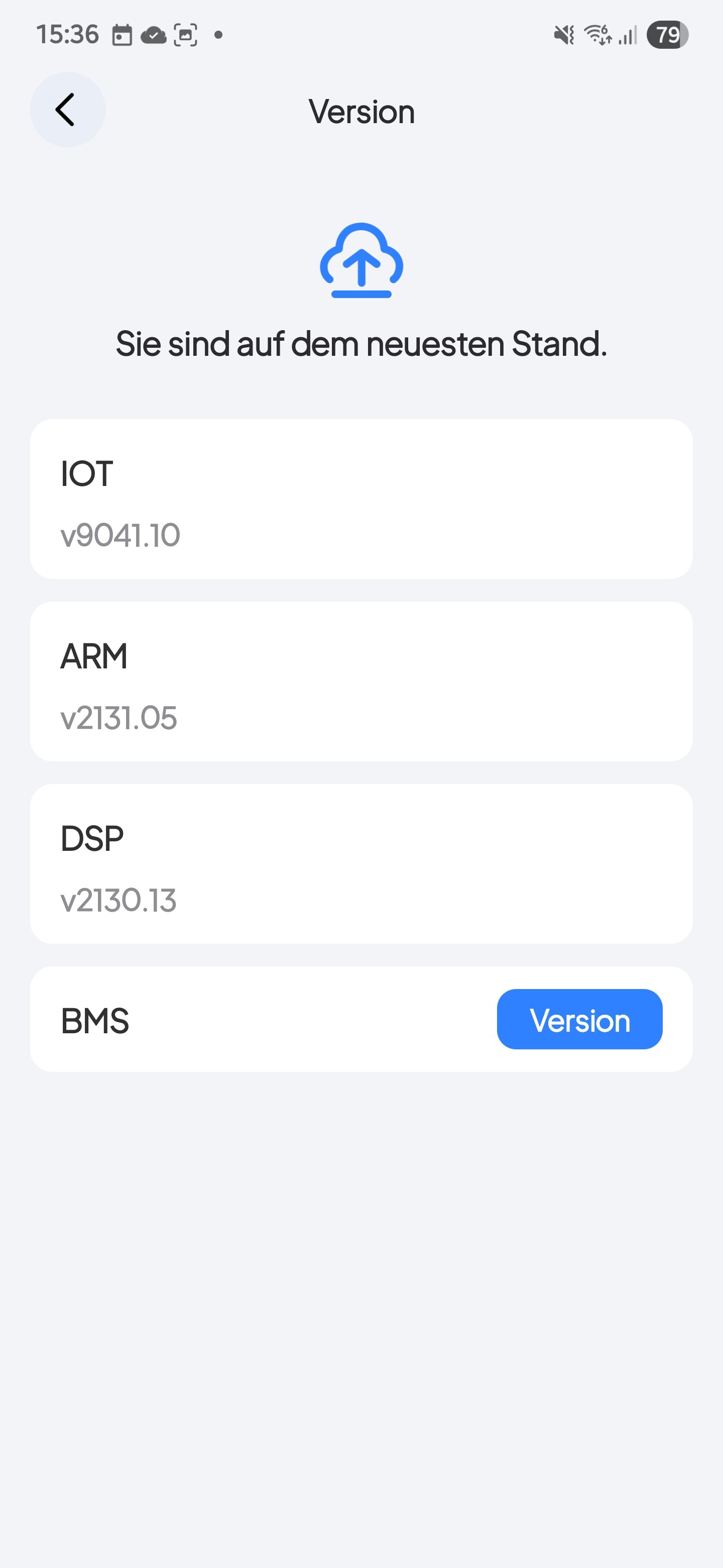

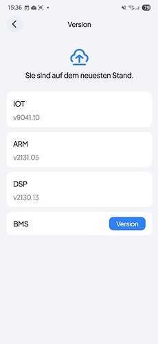

This kind of issue is indeed rare. We still would like to know your firmware version, as it will help us with testing and reproducing the problem. We look forward to your reply.
