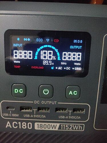

Today I noticed that the display of my charging station looks like the one shown in the attached photo. The station operates in UPS mode and is constantly connected to the power grid. Power outages happen regularly, so it is continuously operating in charge/discharge mode. What could this indicate, and how can it be fixed? Thank you.
Appears inverter’s management chip is unable to read sensors of internal components, or is able to read sensors but unable to update the LCD due to an LCD connection fault. Is it actually supplying power to your DC or AC devices ? Does Bluetooth still work ? Can you connect to the AC180 with bluetooth and Bluetti App to check for any error icon (!) in top right corner of main page. If error icon exists, tap on it to see error code.
It’s control board problem, same issue were reported numerous times for AC180/AC180P. You should tag @BLUETTI_CARE and they will provide you with repair shop info.

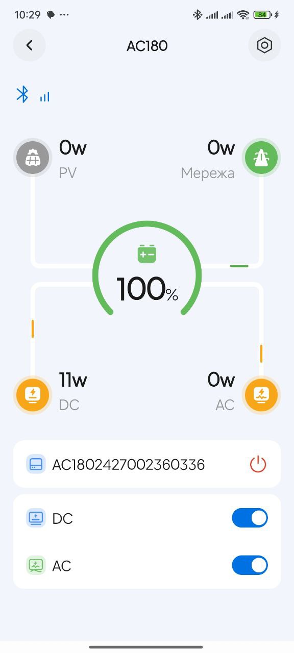

There is voltage on both AC and DC. There are no errors in the
app
Is your only load 11W DC? I ask because true UPS is pass through AC from the grid to an AC device and the milli second response is the inverter switching time for seemless continuous power.
Any DC load is from the battery and does not connect to the inverter. But, connected to the grid it will still act as a quasi UPS for DC loads anyway.

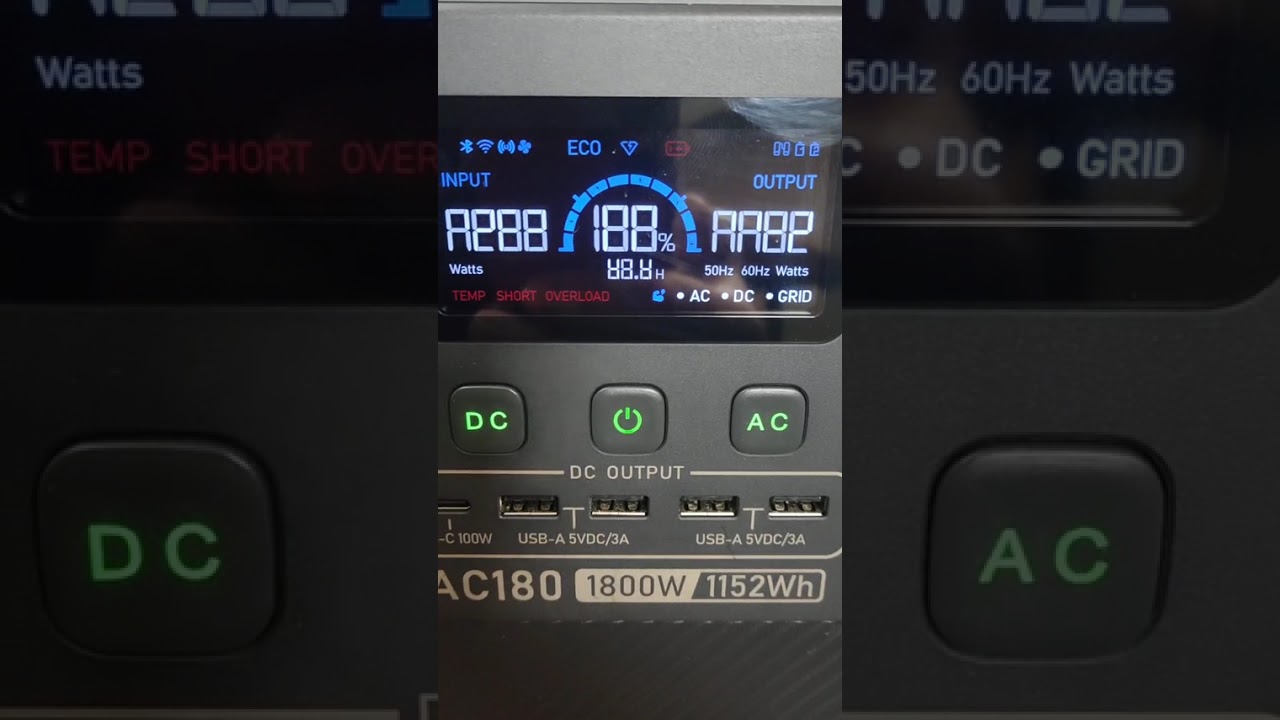

Have you done a recalibration recently? If not, plug in a constant AC load (300 to 500W) and flatten the AC180, then do a full AC grid recharge with no loads and both DC & AC outputs turned off. (Bit like a computer, turning it off then on again usually fixes 4 out 5 problems lol.)

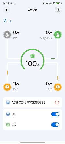

provided this screenshot to show that there are no errors in the app

The grid is connected, and at the same time there is a load on the AC port

all those errors, overload temp short etc are not normal. In fact before a recal, if you haven’t already done so, diconnect everything, input and output, turn it off for a couple of minutes, then back on.
There is voltage on both AC and DC. There are no errors in the app
Hi @drukar, We are concerned that this may be caused by a loose flex cable of the LCD screen, and a return for repair will be required.

So you believe that the overall functionality of the device has not been affected and that these are defects limited only to the display? Thank You

Hi @drukar, I agree with you. Yes, a loose flex cable can cause distorted screen display, but it will not affect the AC180’s performance. You can check the specific status information via the app.
If you are still camping or traveling, we recommend that you continue using the device for the time being. You can arrange for repairs when you have time after returning home.
