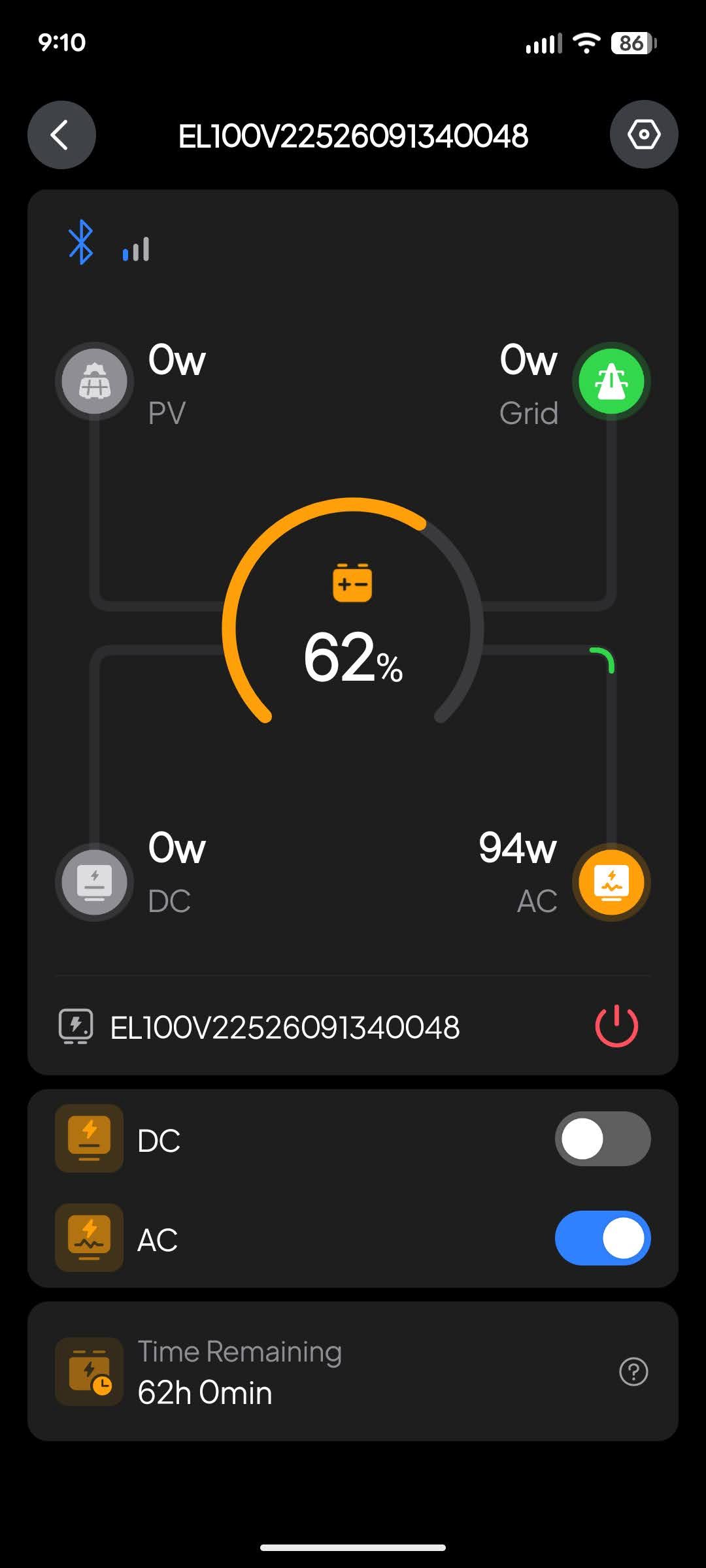

I have a new 100v2, made sure it is up to date, and am testing the Time Control UPS feature, and ran into a question about the estimated Time Remaining. I set the UPS’s offpeak and onpeak times and the power station disconnected from the grid at the onpeak time and assumed the ~94W load running some electronics, but the estimated time remaining was over 80 hours (it’s only a 1024Wh unit so the estimate was extremely wrong). After 5 hours the battery drained from 90% down to 62% (so about 287Wh was drained for an average of ~50W per hour) but the time remaining is 62 hours, so it is still very inaccurate (it should be closer to 12 hours). Is this a bug or something I’m not understanding?

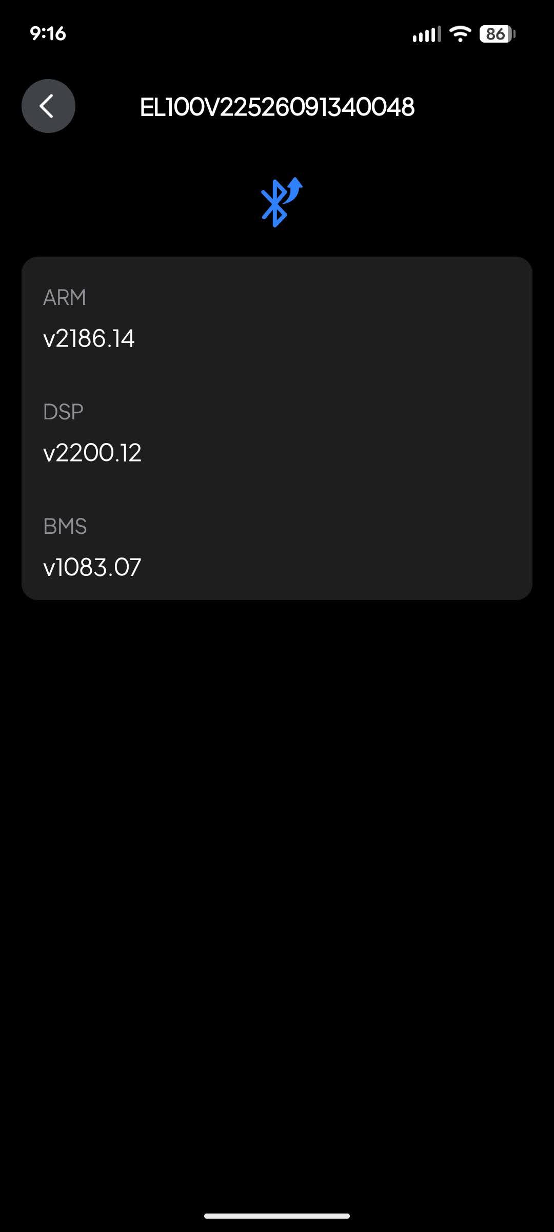

My S/N is EL100V22532010068313 and my BMS firmware version is v1083.07

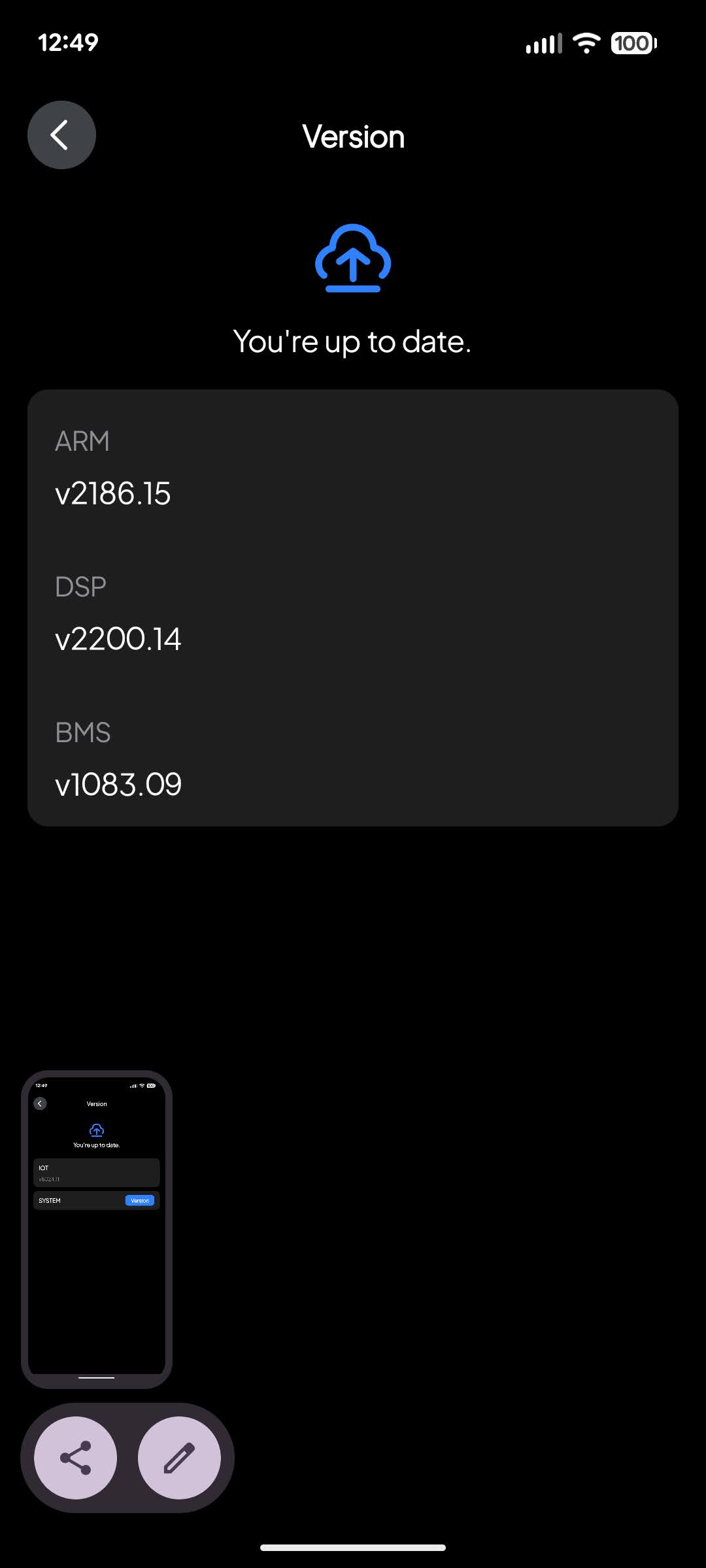

If you also need it, please let us know the current firmware version of your Elite 100 V2, and we will check if there is a new firmware available for push.

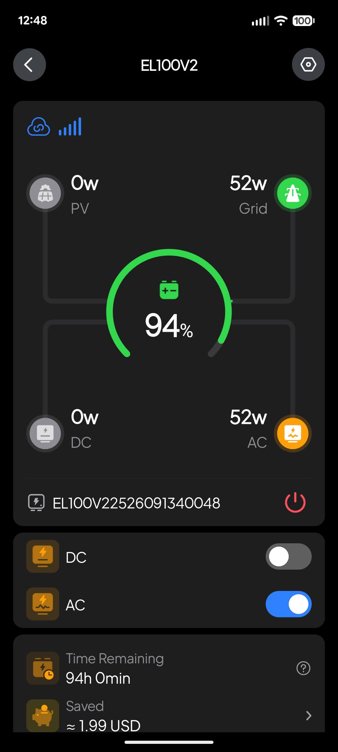

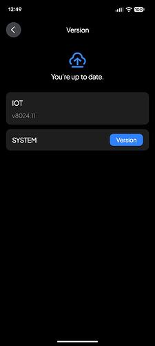

@BLUETTI_CARE If this is an issue (estimated time remaining) some one Elite 100v2 isn’t it an issue on all, why is the firmware enhancement not made available to all Elite 100v2 devices but only those who complain about the issue?

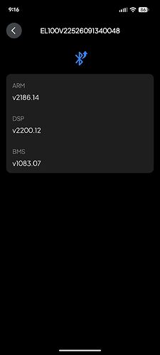

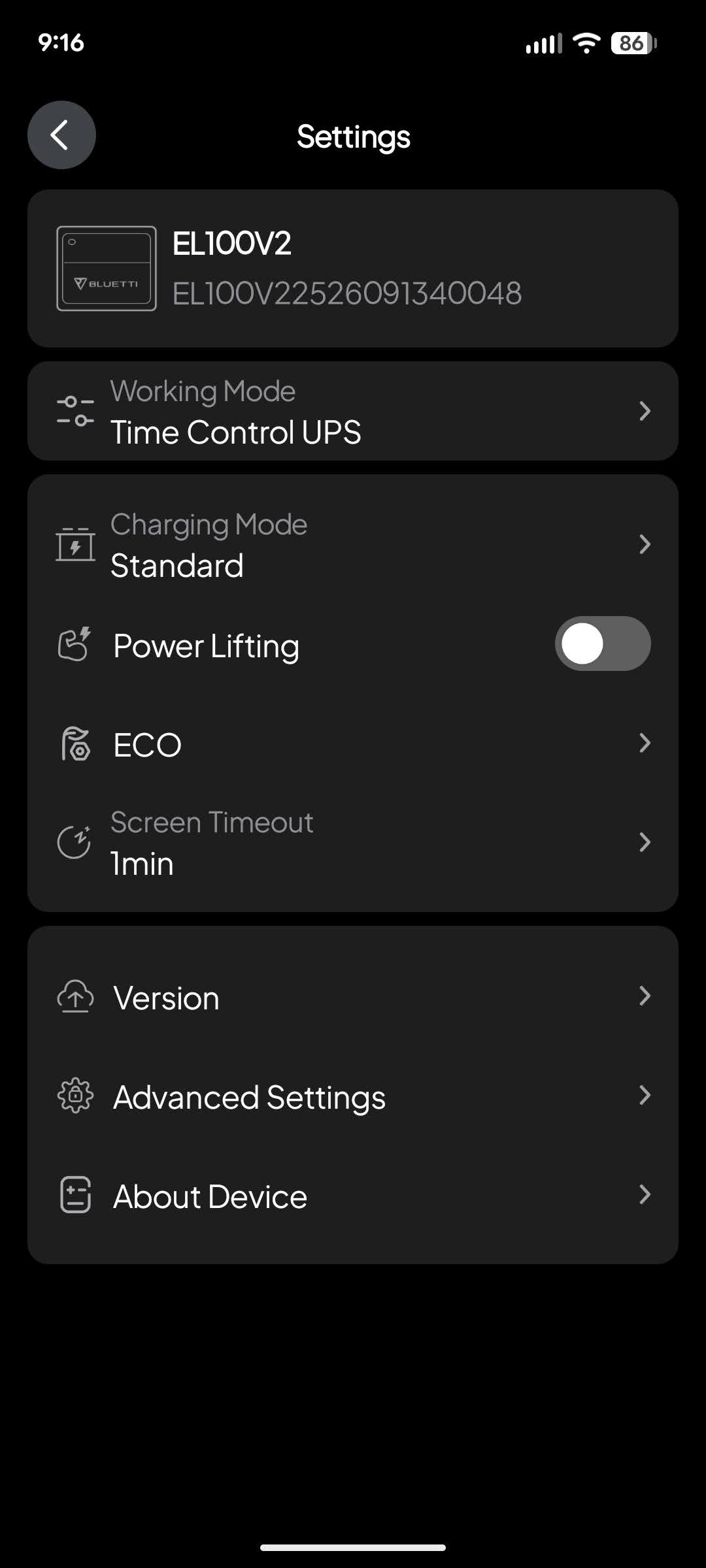

Thanks @BLUETTI_CARE, here are my100v2 versions along with the unrealistic time remaining.
