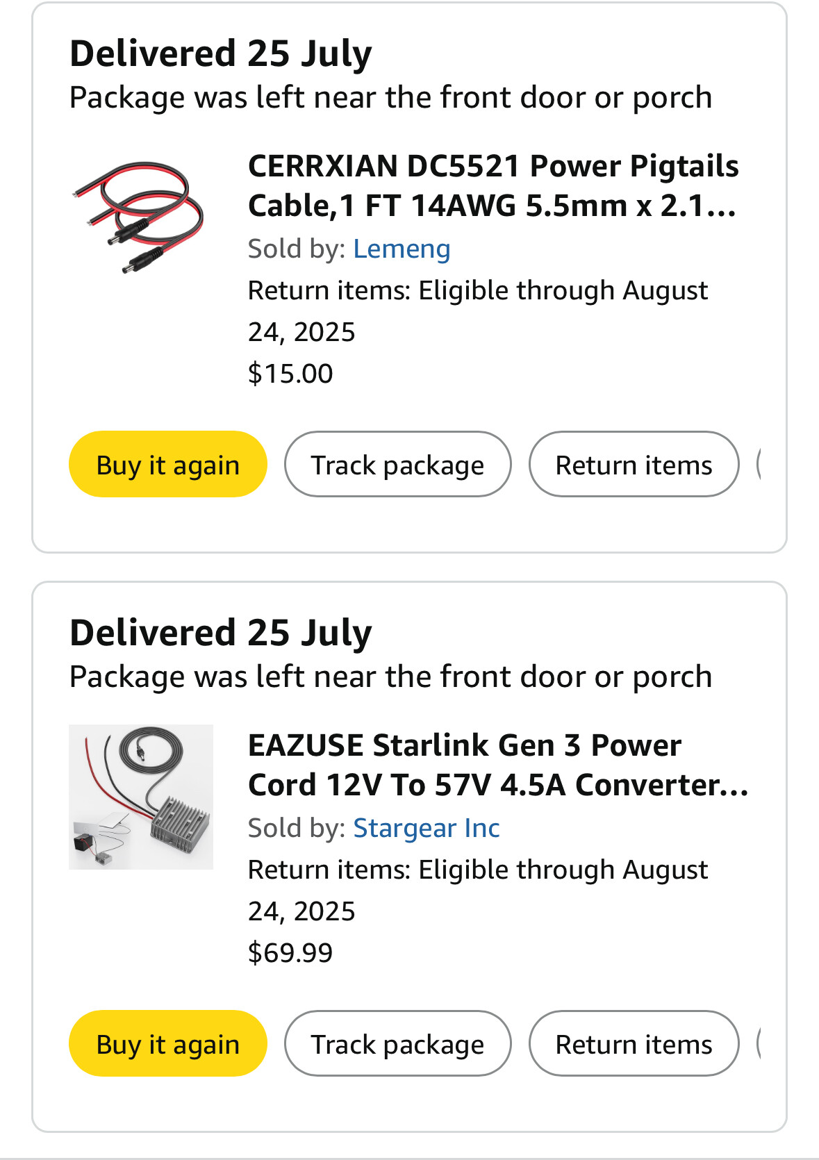

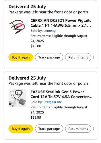

SUCCESS Standar Starlink with gen 3 Router on AC200Max. I am in Canada and cannot buy Starlink’s own DC-DC unit, so I bought the following and have complete success using the 12v 10amp 5221DC output. We were drawing on average 75 watts using Starlink on AC and now are averaging 45 watts. Thank you for all your suggestions. I learned a lot from your responses
