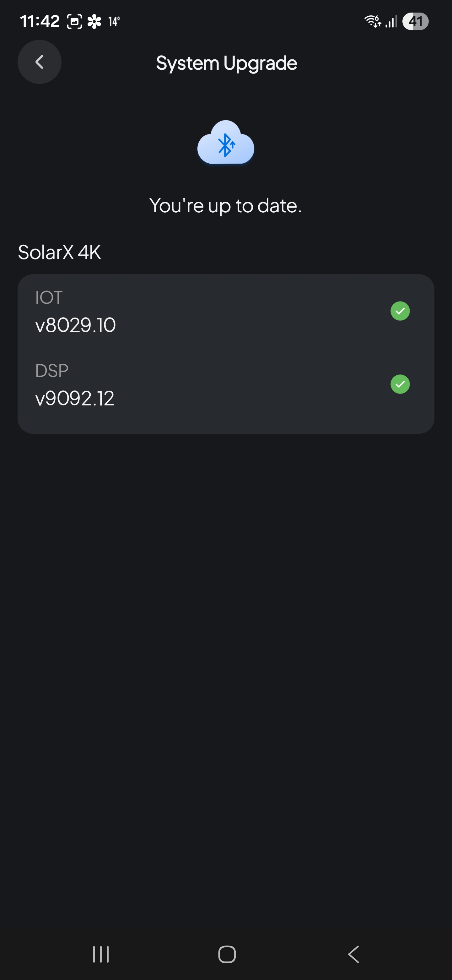

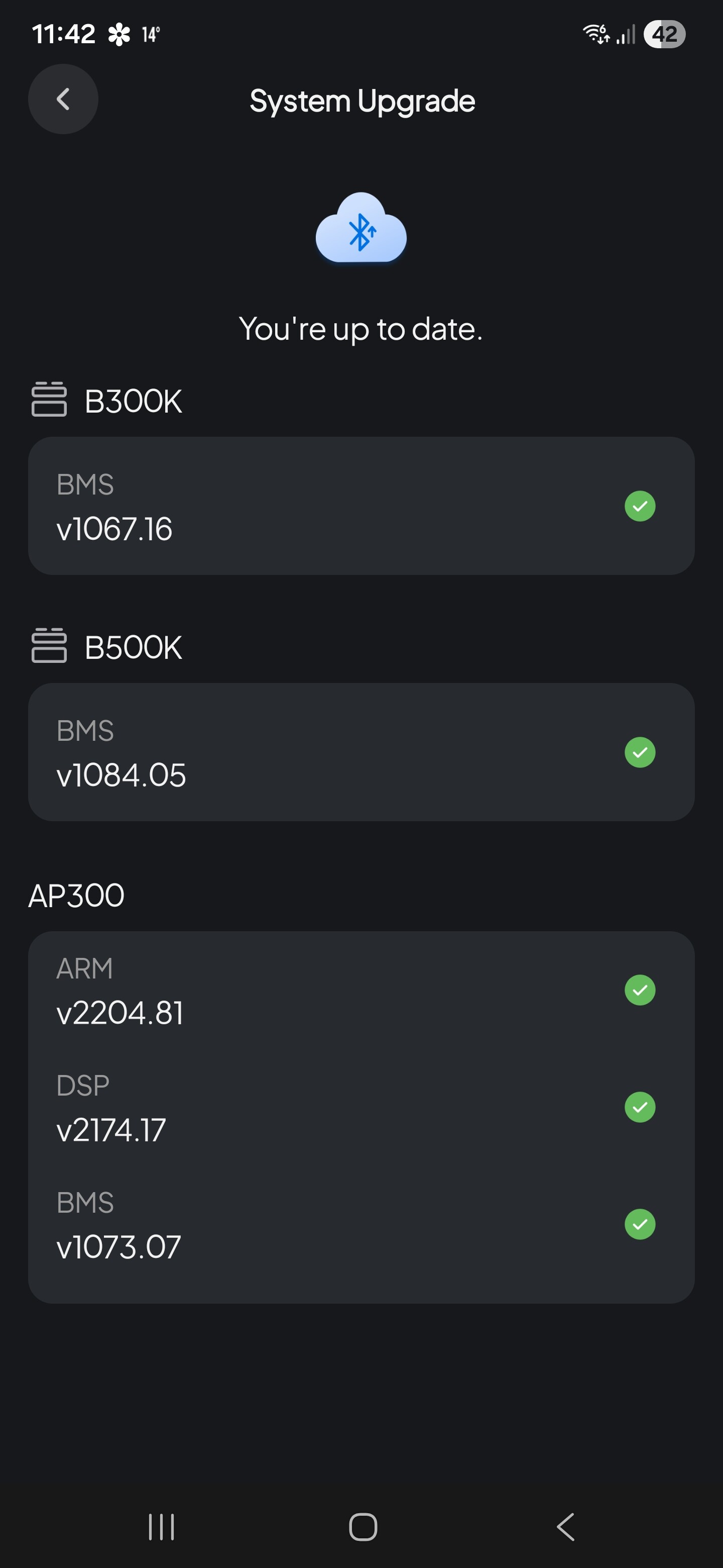

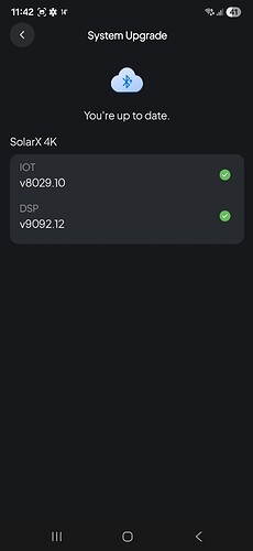

Hi @BLUETTI_CARE
Here is a screenshot of the firmware versions currently installed.
Please let me know if you need any additional information.
