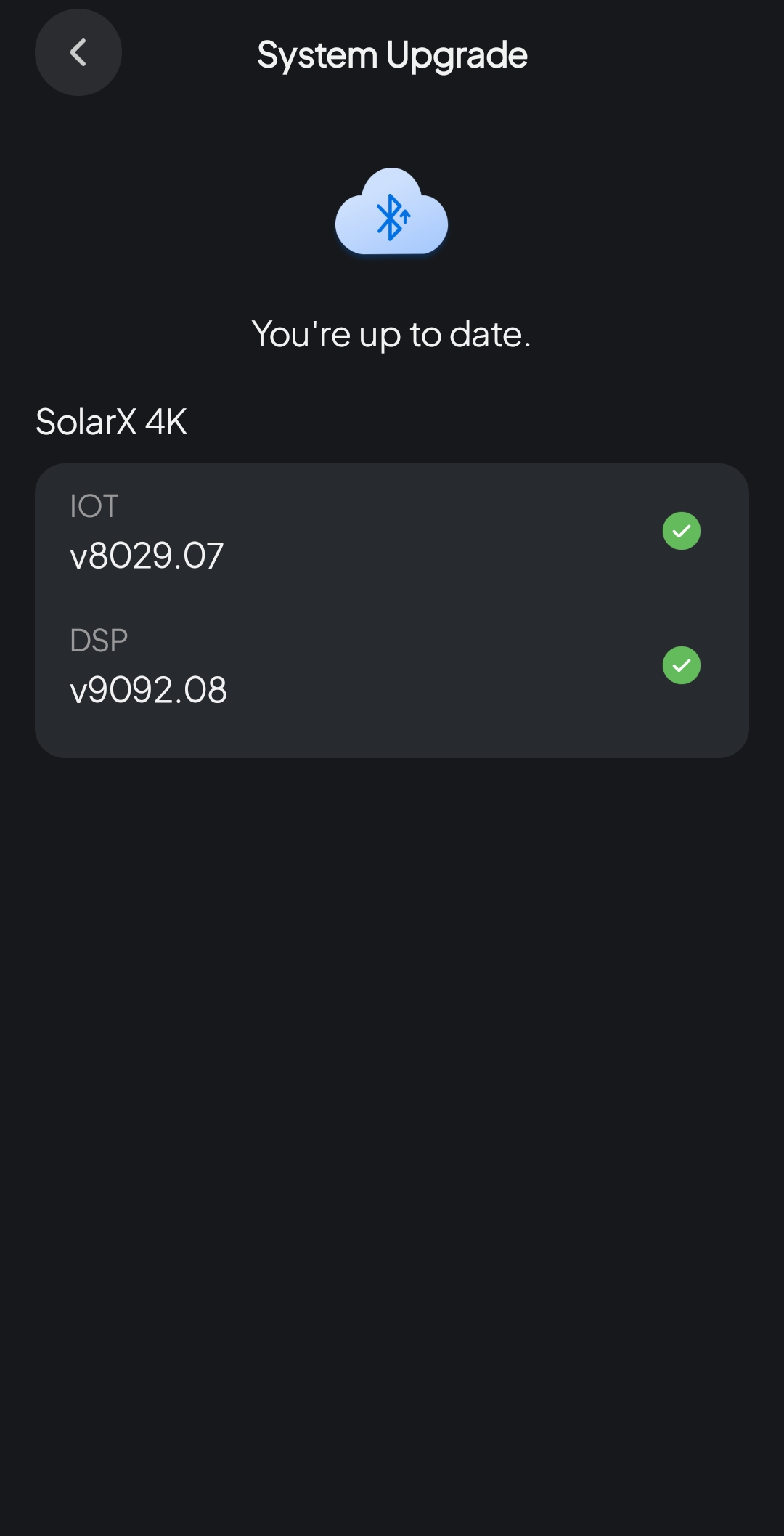

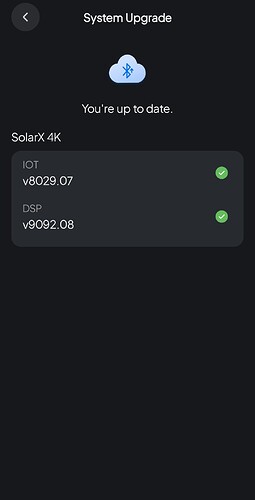

Hello @BLUETTI_CARE ,
So far I have not seen any update for my SolarX. I am attaching the current versions on mine, in case I happen to be at the latest.
Also, I had the no-charging issue happen again today, and I had to turn the charging toggle off and on again to restart it. I would definitely love to see if the update fixes that.
Thank you!
Hi @hnymann, that’s a bit strange, but no worries—we’ve applied to push it again.
This will take one business day, so please try upgrading next Monday.
