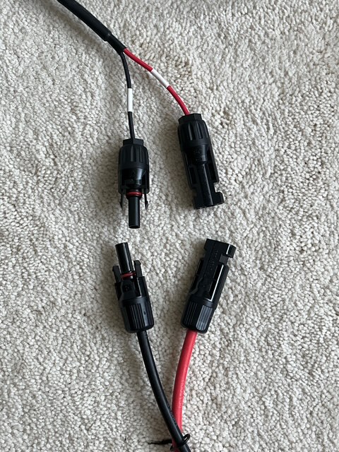

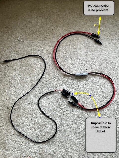

Hello I received 2 pieces of lAnderson connection cables. But I have the following problem:
When I connect both Anderson connection cables and then want to connect one of them to the MC4 connectors of the MC4-DC cable of AC180, this turns out to be impossible.
Could I cut off the MC-4 connectors and then place 2 new ones in the desired place male/female?, or am I overlooking something? Is that not possible or allowed?
Would like your advice
Thanks in advance
I didn’t realize that when I first found these adapters, but yes, the connectors need to be swapped. Just like with an AC extension cord, if the original end is female, then the end of the extension cord must also be female after being extended. Since we’re using the Anderson to MC4 cables as a disconnectable extension cord, the far end needs to reverse the connectors of the near end. You can either crimp new opposite polarity MC4 plugs on one of the adapters (better), or swap the connectors on one of the Anderson plugs.
