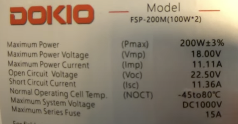

@sealy1986 As you can see i found the specifications!
IMP 11,11A and VMP 18 V For this panel is this 199 Watt, Correct me if i’m wrong!
Most reviews on Amazon and youtube are also very positive!
I would be sad if I couldn’t use it, personally for me it’s very important that it’s much sturdier than most portable solar panels I see passing by. And I also find the price acceptable € 170,-
Are there other Alu-panels like this one with better specifications that better fit the AC180 and my purpose?

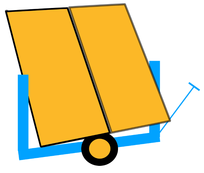

I think it is best to build a kind of transport cart myself with 2 good solar panels mounted (e.g. 2x 150W) that I can simply move in my garden according to needs and sun positions. And if I don’t use it anymore, e.g. in winter, then I just drive it inside my garage and cover it with a tarp, done! Approximately as shown in this image below and then tiltable with locking.

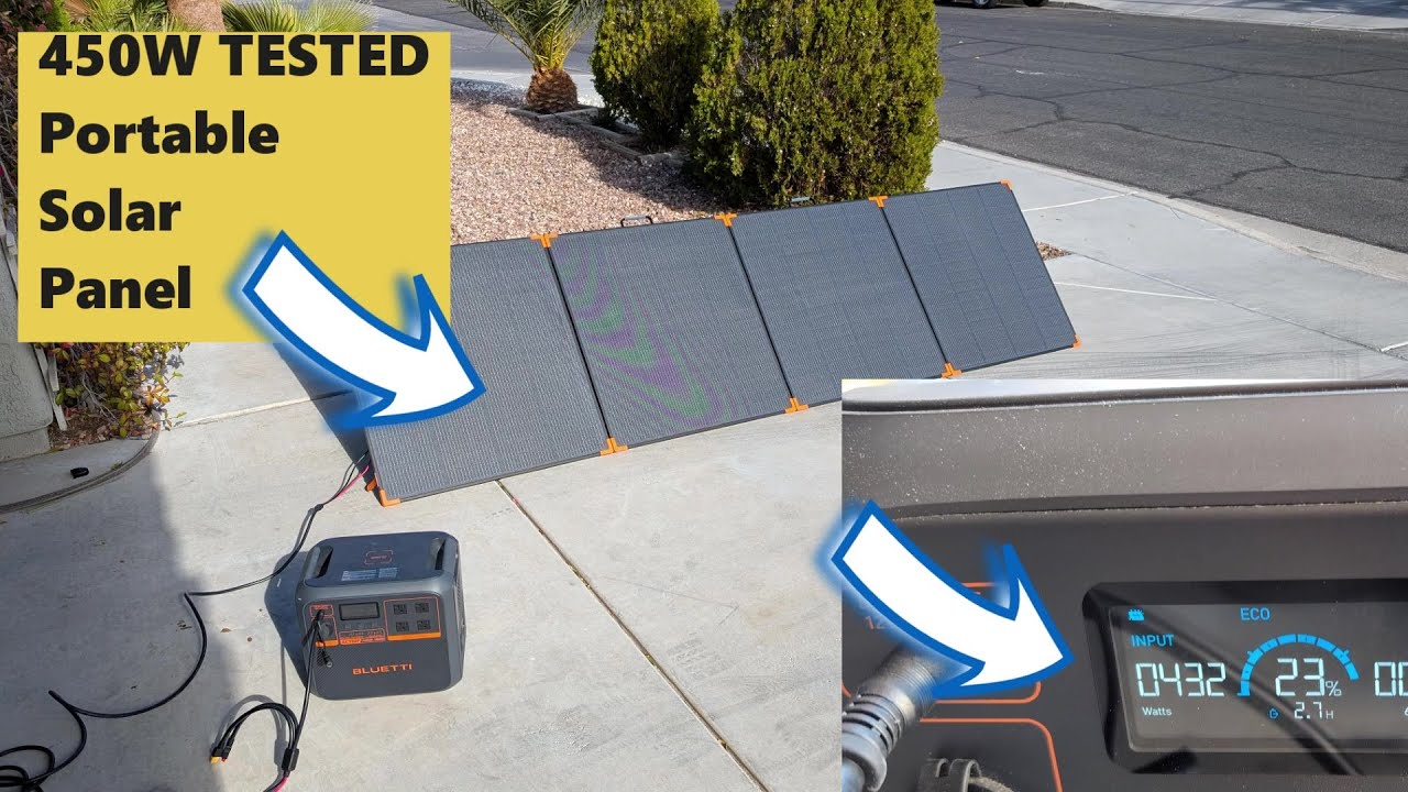

Hi. I’m interested in hooking up 2 of these solar panels to my Elite 200 V2. The solar input on the bluetti is rated for 1,000W Max., 12V to 60V, 20A Max.
Will 2 of these be fine on my bluetti?
Technical Specifications
Model    EZ450W
Maximum Power at STC (Pmax)    450W
Maximum Power Voltage (Vmp)    38.3V
Maximum Power Current (Imp)    11.7A
Opencircuit Voltage (Voc)    45.9V
Shortcircuit Current (Isc)    12.4A
This youtuber hooked up one of them to his AC180P (which has the same solar input voltage of the elite 200 v2, but has half of the amperage
Elite 200 V2 1,000W Max., 12V to 60V, 20A Max.
AC180P 500W Max., VOC 12-60VDC, 10A

Yes they would be compatible with the Elite 200 but you would have to run them in “parallel” and not series. You will end up with around 766 watts max output (38.3X20) since your MPPT charge controller is limited to accepting 20 amps max. All you would need to buy is a parallel y splitter (1 to 2 connector). So XT60 to DC7909 splitter if you prefer the barrel plugs, or 1 XT60 Female to 2 XT60 Males which in turn would plug into the MC4 connectors on your solar panel cabling.

If the solar panel goes over 20 amps, does the bluetti stop at 20 amps, or does it reject the power all together?
And what if I put them in series, the voltage is too much. Does the bluetti cap the voltage, or will something bad happen, or will the bluetti outright reject the charge?
The MPPT controller regulates what it will accept and so in your case anything past 20 amps +/- a very few milliamps will get rejected. Your power station will be perfectly happy and just simply not use the remaining current (amps). It won’t shut off or refuse to charge or anything like that, it’s just a hard limit. So whatever the volts and amps is coming in is what you get. Of the watts coming in, you won’t convert directly 100% of those watts into storage. Charging efficiency may only be say 90% of that. So if see 100 watts coming in, you are really “storing” 85-90 or so. Likewise with charging, you also don’t get 100% of your discharge performance due to losses. Say on the AC side you may only get 70% efficiency under a small load. It’s not exactly linear. If I consumed something on AC at 100 watts, it won’t take the same amount of time to recharge at 100 watts to get back all my power. It will take even longer. So say you had a power station that was 1000wh running at constant load of 100 watts with inverter losses. Your runtime would be 10 hours obviously (10X100), but recharging would take 1.1X that since its only 90% efficient meaning it would take 11 hours to recharge that same amount of power back. So to give you an example on my AC180 (1152Wh) if I run my dehumidifer at constant load of 285W, assuming its 85% efficient my runtime would be around 3.5 hours. If I was solar charging at 285W, it would take me 4.5 hours to recharge it. 1 more hour spent charging than consuming. So for every 25% of my power station, I’m spending 15 MORE minutes recharging to get back what I used.
The drawback of this is obviously don’t buy a panel that has too high of an amperage because its wasted money. Buy two 15’s and you will get 20 and lose 10!
And what if I put them in series, the voltage is too much. Does the Bluetti cap the voltage, or will something bad happen, or will the Bluetti outright reject the charge?
You would pray overvoltage kicks in and the power station even prevents you from using the panels together like that. If not, bye bye power station and warranty.
