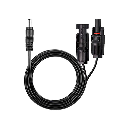

From the specs I read on your panel the open circuit voltage is 22V. When you plug a cable into the DC5525 port (to your panel) it outputs 18V@5A or around 90W in ideal conditions. So you need a DC5525 to MC4 cable.
(SP012 panel) DC5525---->(MC4 +/- pair)----><----MC4 +/- pair)—>XT60 (AC2A)
So both ends of the MC4 cables will join together basically. On the solar panel side you’ll have the DC5525 which goes into your panel and on the other side your XT60 (yellow) connector you just plug straight into the AC2A.
You may need to get an adapter that steps up to 5525 as they may not sell a direct DC5525 to MC4 cable. For example I’ve seen ones where its DC5521, then they include adapters which convert it to 5525/7909/etc. Like this one .

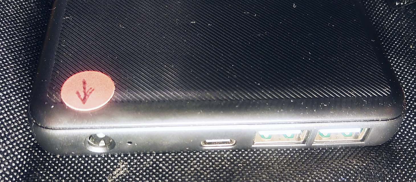

I’m attaching a photo of my Allpowers SP 012 solar panel. As you see, it only has the 5525 output port and thus it is impossible for me the use the MC4 connector.
Hi Jack,
There is an adapter that goes from DC5525 TO MC4.
Then you have the MC4 to XT60 cable that came with the Bluetti unit.
Plug the MC4 cables into each other. Male side of MC4-#1 into female side of MC4-#2. Female side of MC4-#1 into male side of MC4-#2. Plug the DC5525 into your solar panel, plug XT60 into your Bluetti. Done.
MC4#1 is DC5525 to MC4 cable
MC4#2 is XT60 to MC4 cable
(SOLAR PANEL) <-----DC5525-----MC4----MC4—XT60—> (Bluetti)
