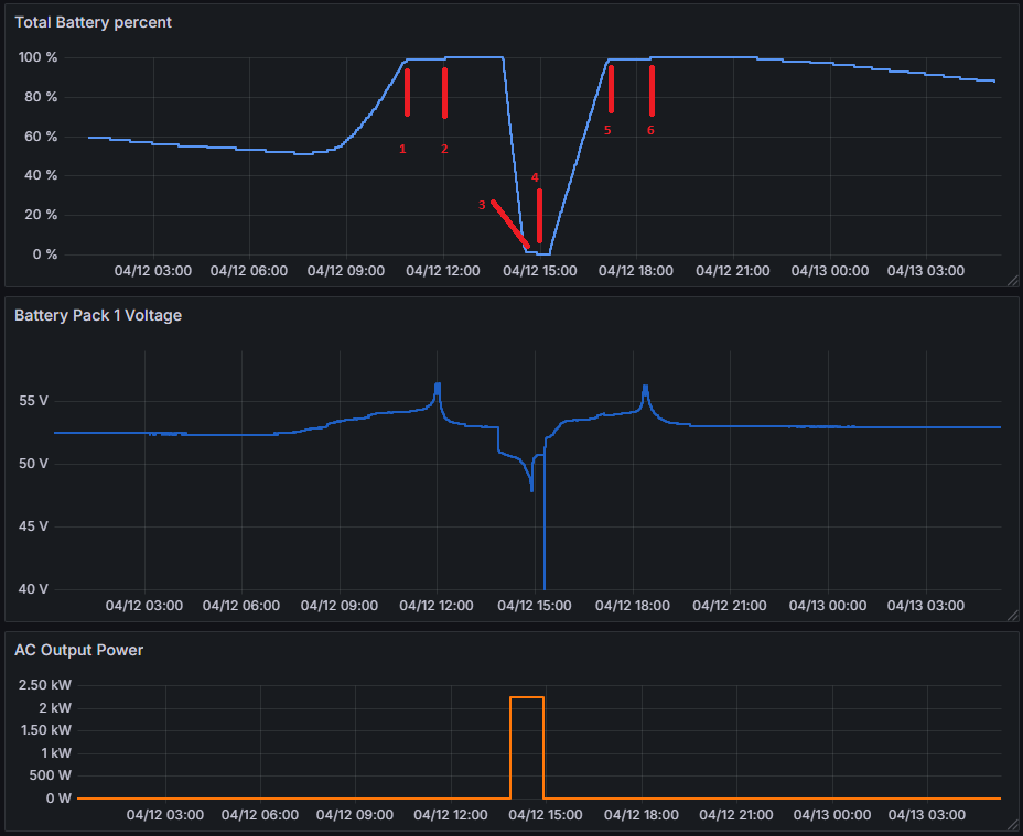

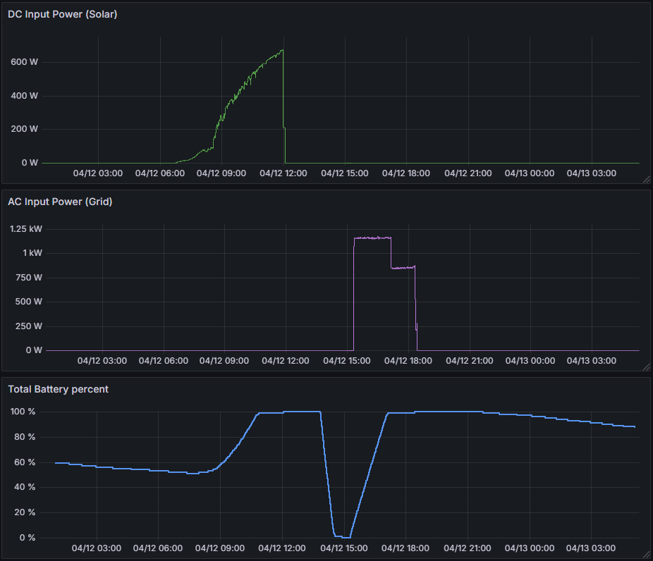

Hi @BLUETTI_CARE, I did the SOC calibration and want to share some results. I am using HomeAssistant to control the AC500 and added two screenshots with measurement results, as following:
In the beginning, the system is charged via solar input. Now watch “Total Battery percent”:
At postion (1) the SOC reaches 99% and stays at 99% for more than 1 hour, although solar continues to charge (not okay).
At position (2) the SOC reaches 100% and the AC500 shuts down solar charging
Then 2 hours later, I started to discharge with 2300W (10A * 230V)
At position (3) the SOC reaches 1% stays there for 20 min, while continuously discharged (not okay)
At position (4) the SOC reaches 0% and the AC500 switches AC-Output off then shuts the system down
20 minutes later I started to charge the systen via AC-Input with 1150W (5A * 230V). Solar charge is disconncted.
At position (5) the SOC reaches 99% again and stays there for over an hour. However the AC500 reduces charge power to 850W.
At position (6) the SOC reaches 100% and the AC500 stops charging via AC-Imput.
I found these results quite interesting and wanted to share this. Hopefully the SOC is calibrated now correctly. I will send a followup in some time.
Hi @southside, Thank you for sharing this. I believe it’s normal for the battery to remain at 99% for about an hour. When the power station is nearly full, the BMS (Battery Management System) enters a trickle charging mode and limits the charging speed to prevent overcharging, which can be harmful to battery lifespan.
We look forward to your further updates.
