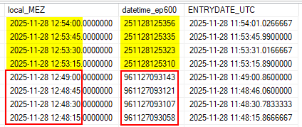

I just searched the forum because I have a similar problem with my EP600.
Does this also apply to other BLUETTI products, that they only synchronise the system time when it’s first bound to app, but not afterwards, never?
Can synchronisation be ‘forced’ in some way without having to disconnect the device from the app?
My EP600 is now several hours ‘behind’ (27h17min), which is noticeable when setting a schedule…

Hi @BLUETTI ,
ok thx, reconfiguring the WiFi with APP solved the date/time gap.
I record some values per bluetooth interface and see after reconfiguring the new and actual date/time. The remaining time difference of a few seconds results from the Bluetooth transmission to the MQTT host and the subsequent readout via the MQTT client.
