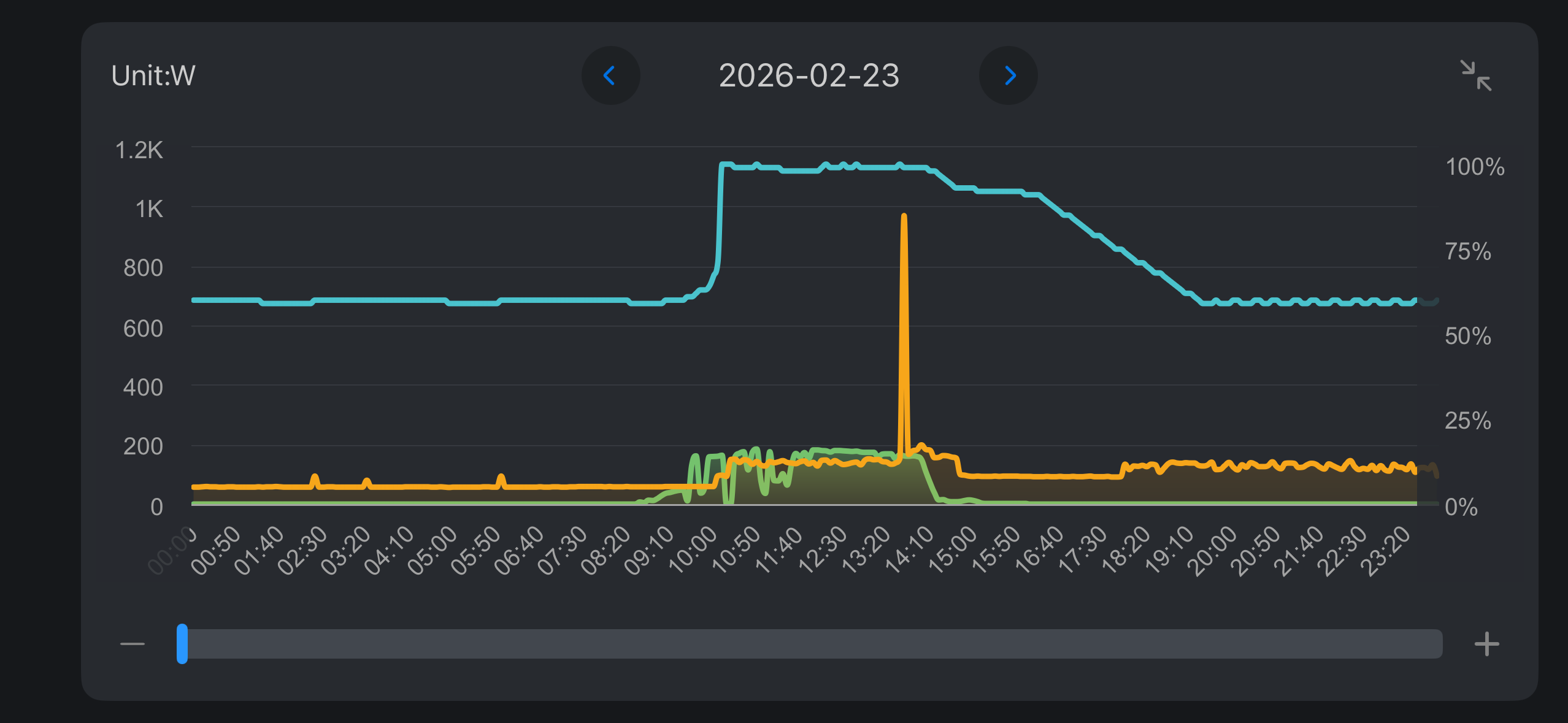

Hello @BLUETTI_CARE
Recently I have similar problems as mentioned above. I have false output readings especially at low loads and for a couple days I have huge SOC irregularities. I am sharing one graph below because I can only post one media.
As you can see from graph, there are huge inconsistent hikes in SOC readings. Especially in 23/02 reading jumps from 70 to 100 % in just 5 minutes. Because of these hikes I can not use PV charging efficiently.
MY SN Number: PR100V2225280000420193
IoT: v8024.12
ARM: 2186.16
DSP: v2200.14
BMS: v1083.08
What can be done to solve this issue. Waiting for your feedback.
Best Regards
Utku

Are you satisfied now with your power station ?
Pretty much. Despite using it as a backup, it went through plenty of cycles and has acceptable SOC readings.
No spikes or drops in percentages, linear charging and discharging.
Hello @BLUETTI_CARE @BLUETTI
Hi
I’m experiencing similar issues and would like the latest firmware pushing to my device please.
My current firmware versions of EL100V2
EL100V22537111600674
IOT v8024.12
ARM v2186.16
DSP v2200.14
BMS v1083.08
Thanks
