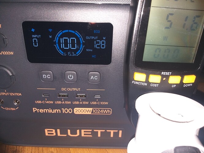

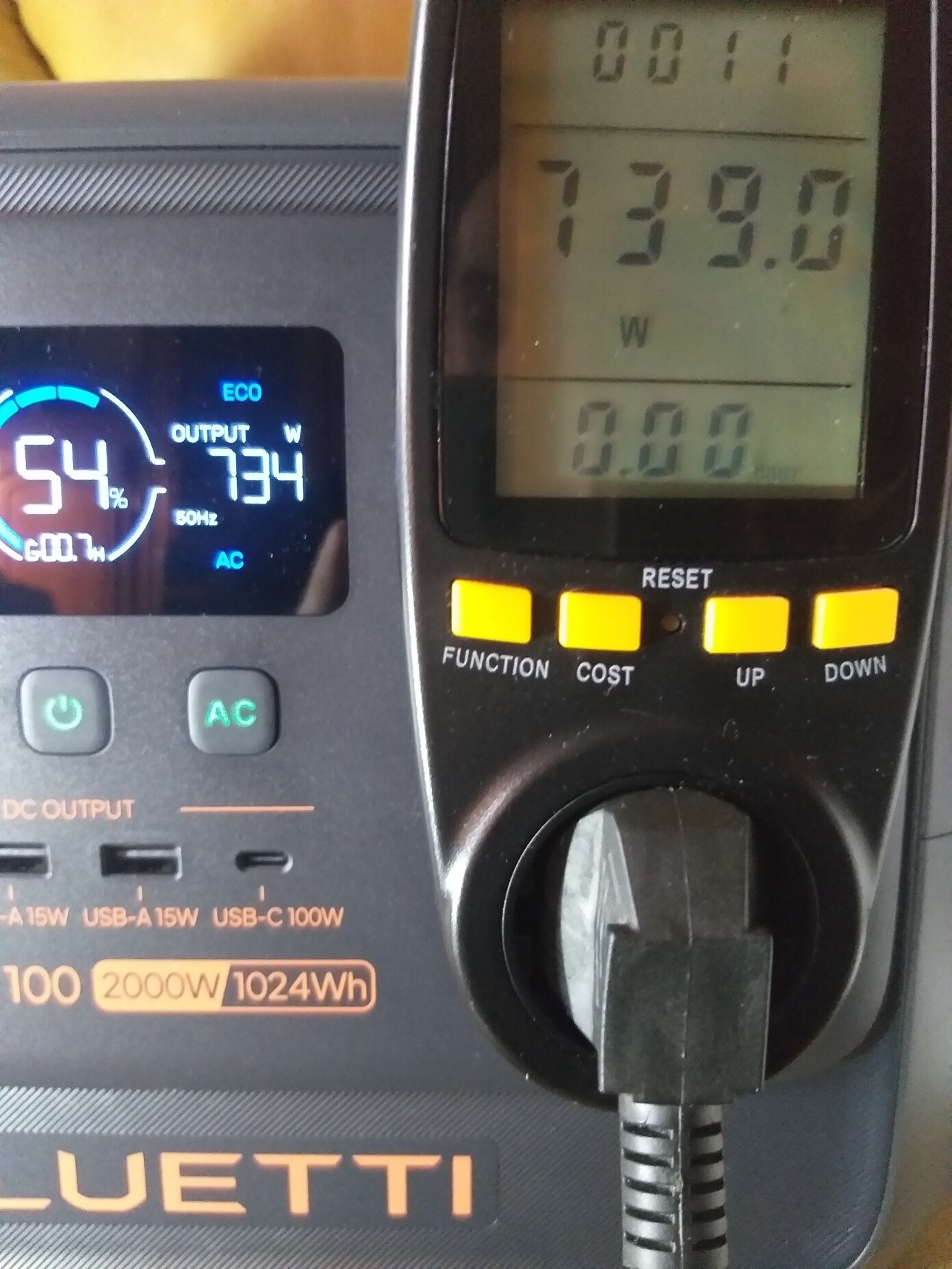

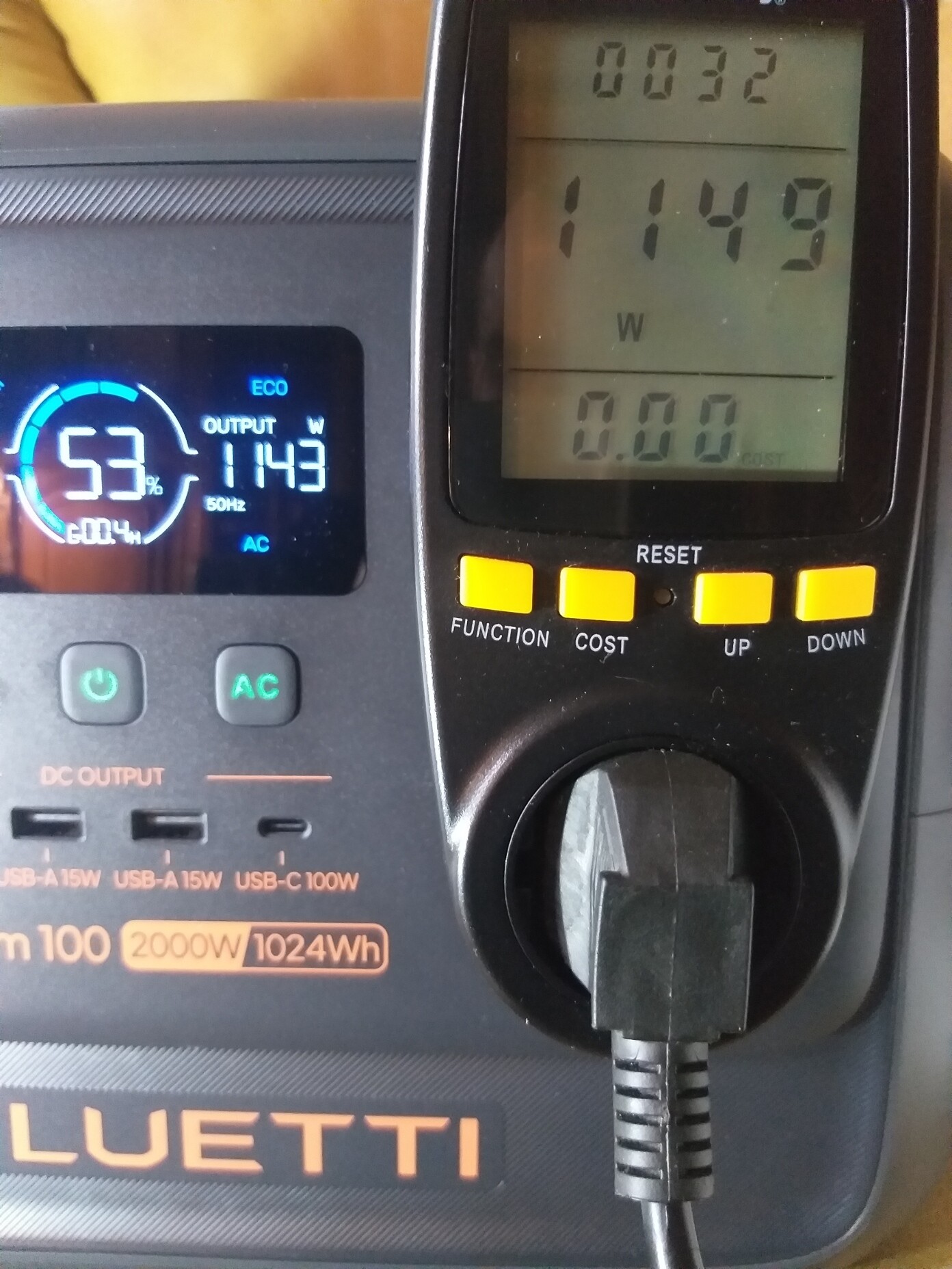

This is not normal when the first 45% discharges TWICE as fast as the last 55%.
I own another two Bluetti power stations (AC180P and AC200PL + B300K), none of them behaves like that under the same conditions, just as I mentioned above, nor during small loads under 100 watts, nor when having no load at all (just AC on).
It’s not normal to have 50% of useful capacity left, but showing 27% and recharging those 73% in 35 minutes in silent mode (SOC jumped from 87% to 100% instantly, literally in a second when I recharged it after the last post LOL)
Irrelevant. It went through 3 full cycles, as I mentioned above. At least do some edits to your stock answer.
Upgrading the BMS can indeed optimize battery performance. However, we have found that your firmware is already the latest version, so we cannot push a new firmware update to you.

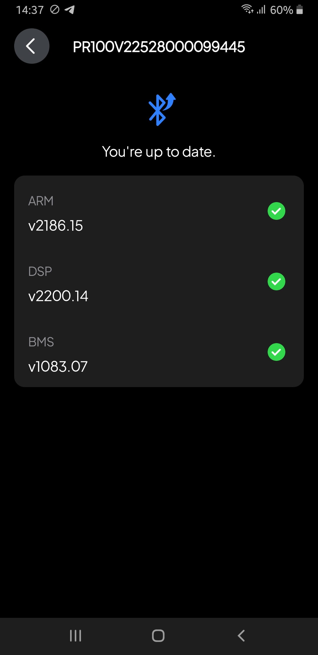

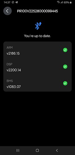

  1. Powerful summary. It’s almost like I mentioned 3 times that I had the latest firmware + provided screenshots.
  2. I didn’t ask to help me with updating to the latest version; I can do it myself if there is one. The problem is, there is none.
    Also, I like how you completely dodged the fact that it shows more output power than it should.
    Send this topic to your R&D department and instruct them to conduct further testing, confirm all the points mentioned here, and begin working on the new firmware version. Beta will do if they can do it in a week or two.
    And stop with these AI-like responses when your customer obviously knows what he’s talking about.

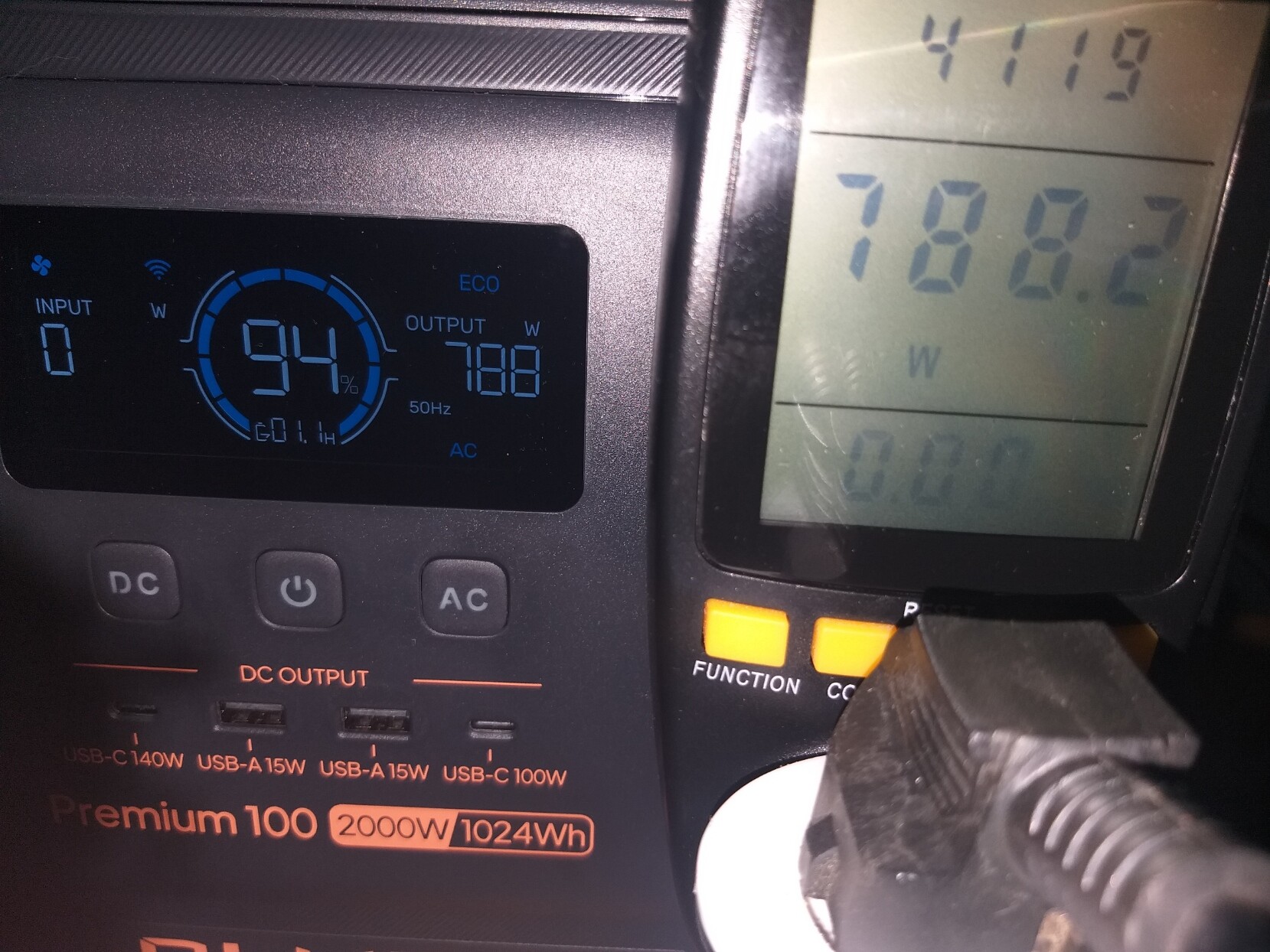

So I tested the “new” firmware, which was an ARM and DSP update (there was no new BMS version included).
Results are: Nothing. It changed nothing.
The SOC was at 56% after 24 hours of AC discharge, just as I mentioned in the original post. After 9 hours of discharge, SOC was at 80%.
The unit still has huge issues with small loads (40-120 Watts) and displays them incorrectly.
In the video above, I connected my double bed electric blanket (2x60watts), which is basically a resistive load, and switched between modes.
The unit still has no issues with heavier resistive loads, tho, like a 750W-1250W heater, as seen in the photos.
If this update is meant to be a placebo, it didn’t work because I tested it properly.

Upgraded to v108309, fully discharged (922Wh output from 750W load, slightly less than original 945Wh), charged, and tested.
Everything is still the same, maybe even slightly worse.

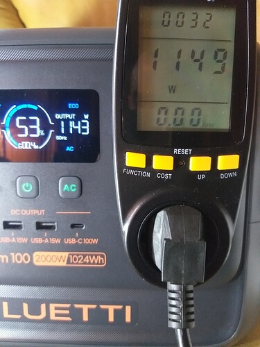

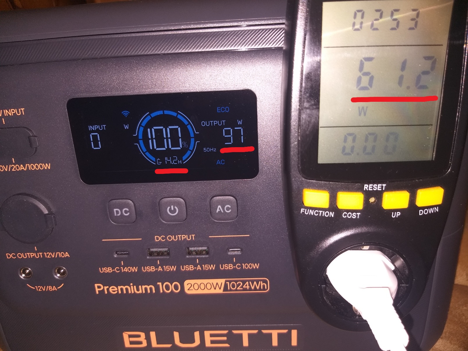

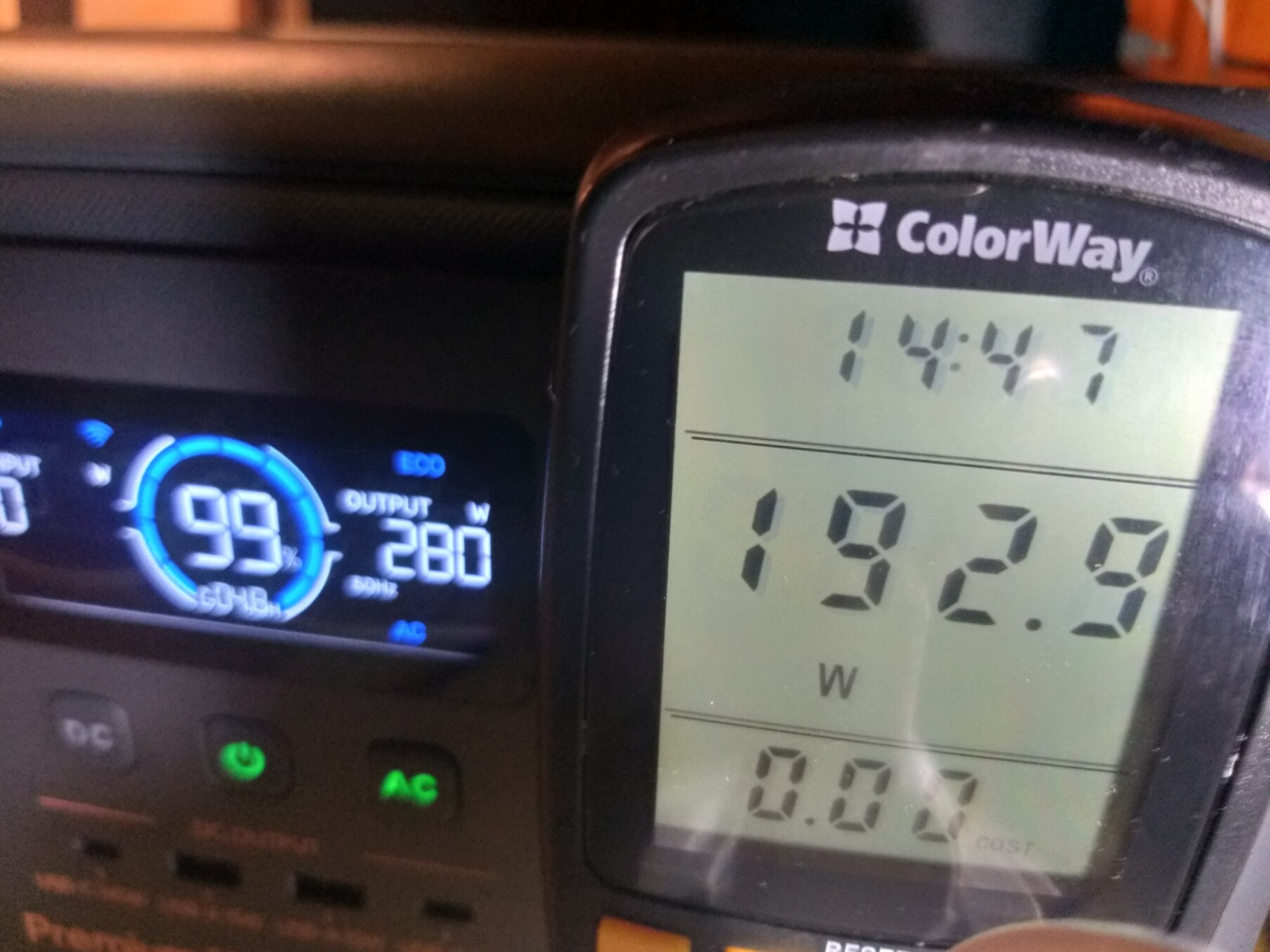

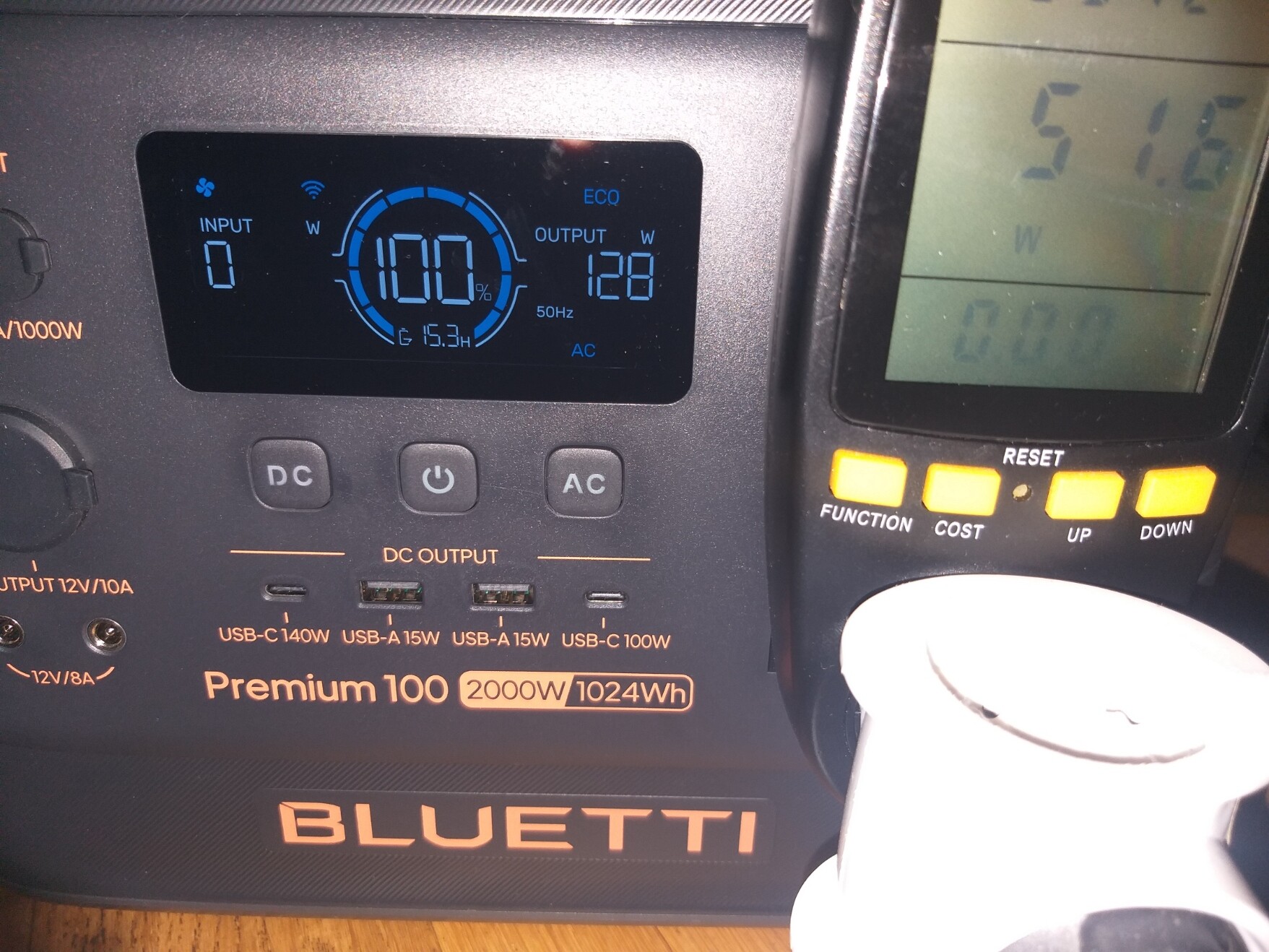

@BLUETTI_CARE
1st pic, electric blanket set to 60 watts, I marked 3 indicators. Which one is lying in your opinion?
2nd pic, my pc on idle, which is ryzen 5600G with 3 fans and no videocard + Samsung S24R350 20-watt monitor. 128 Watts is a 148% increase from the factual 51.6 Watts.
3rd pic, I increased the load to ~195 Watts, which shows as 280. “Only” 45% measurement error this time.
4th pic, PC + 750W heater, absolutely spot on, no problems.
Send this to R&D and ask them if this is considered normal and user-friendly operation, and why my other 2 Bluetties (AC180P and AC200PL) are not like that.
