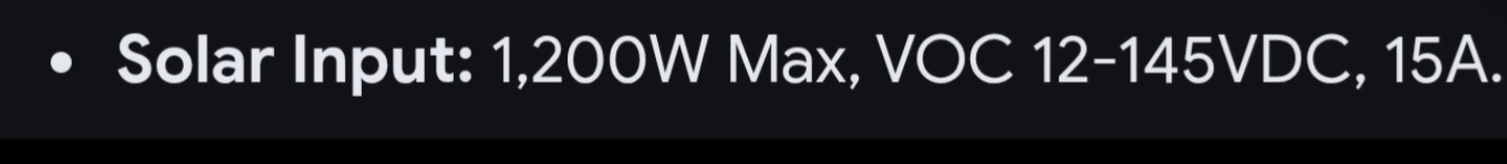

Has anyone added the total capacity that 6 200 Watt solar panels would generate? 1200 Watts is the maximum the Bluetti AC200L is rateded at.I just don’t want to exceed the maximum voltage or wattage.

You’re within spec, just be careful with voltage. The Bluetti AC200L accepts 12–145V and up to 1200W solar input, so 6 of your panels (Voc ~23V each) in series would be ~138V, which is technically safe but very close to the limit—especially in cold weather when voltage rises. A 3S2P setup is the safer option, keeping voltage well within range while increasing current to utilize more power, also worth checking full system setups like Commercial Solar installation UK to understand how panel configurations, inverters, and safety margins are planned in real-world installs.
