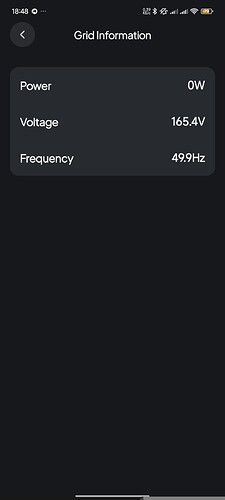

The dsp v2106.71 update came but nothing changed. Also the error e114 and once it was e117. The voltage in the network is 165 v. I added a screenshot. P

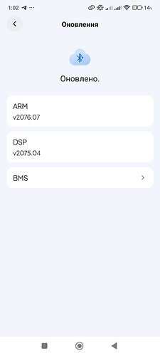

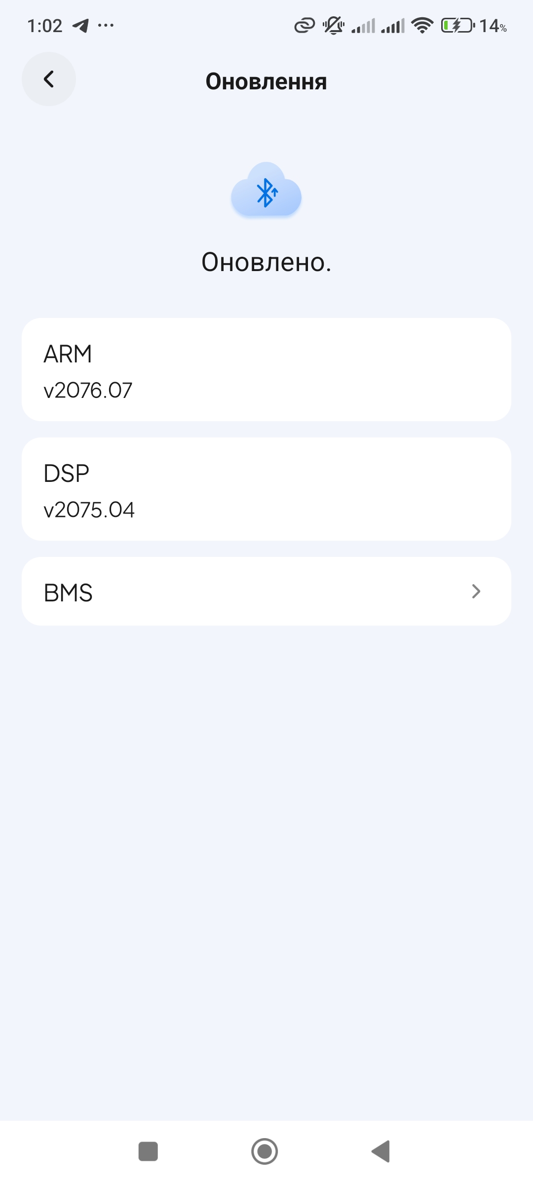

Hi @BLUETTI and @BLUETTI_CARE , I live in Ukrane and have low voltage issue(around 180-195volts), can you help me with new firmware? Thanks
Model: AC70P
S\N: AC70P2403001037488
ARM: v2122.07
DSP: v2112.06
BMS: v2112.06

Apparently you provided the firmware where the lower value is 170v. And I wrote in the first message that we have from 160 to 180v. A friend of mine has a lower value of 150v manually set on the AC100. Please provide either the ability to manually change this in the self-adaptation menu, as it was, or firmware with a lower value of 160v. Because with the current one, the station only clicks because I go jumps to 172v, charging begins, after 30-40 seconds the voltage drops again to 163-165v. And the station thus constantly clicks the inverter relay. For 4 hours while there is light in the last 20 minutes before shutdown, the voltage may rise and then the station manages to gain at least something. Sometimes 100 percent, but mostly +10 +15 percent maximum. There should be a minimum value of 160V. Otherwise, the station simply becomes furniture. Thanks

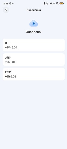

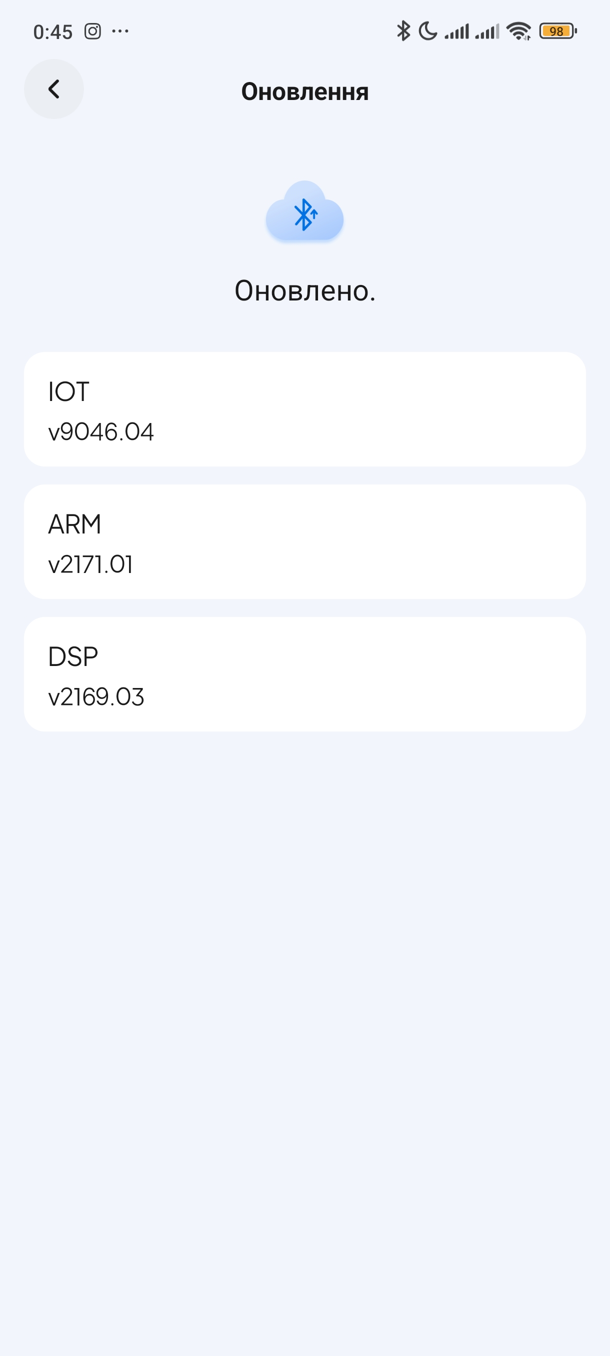

AC70P2433000366416
IOT v9046.01 → v9046.04
ARM v2152.02 → v2152.71
DSP v2112.06
