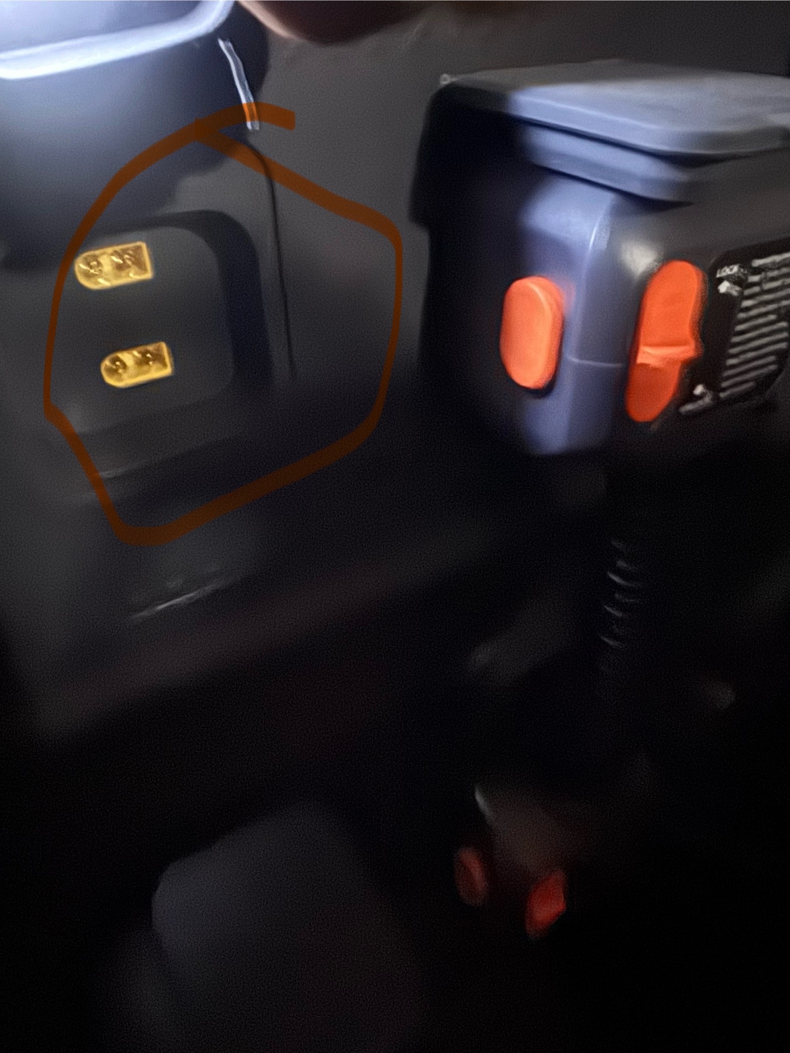

:100: three is strong textNO CAN (Ethernet ) connection on 3 way XT60 cable. At least on my cable. But on single unit cable there is one (I have both types of cables).
