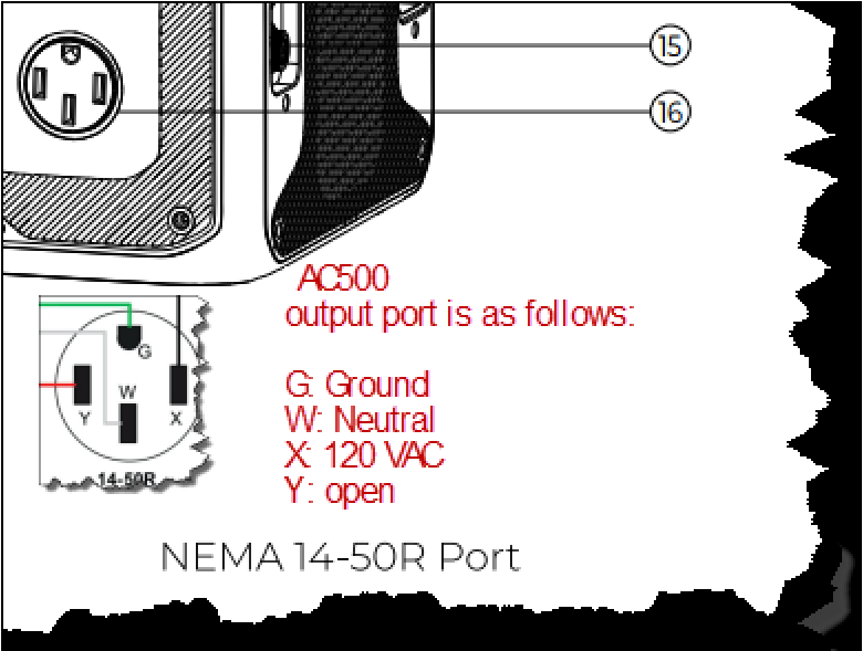

The Technical question I need answered before I can place an order for an AC500 and four B300K batteries is:
In technical terms, how exactly is the NEMA 14-50 outlet wired?
A USA NEMA 14-50 has four sockets, 1 for GROUND, 1 for NETURAL and 2 legs of 50Amp 120VAC Power (X and Y).
On the USA version of the AC500, are both X and Y connected to 120VAC ?
This is critical to know before purchasing because the unit cannot be returned if assembled and used.
If only one leg is powered (only X or only Y) the unit will not properly power a 50Amp USA RV.
The RV would only have power to 1/2 of the 120VAC outlets.
Hi @SteveMyers, Thank you for your attention to this issue.
Regarding this problem, we have marked it in the picture for your reference.
Would there be any problem if I tied L1 and L2 together on the NEMA 14-50R?

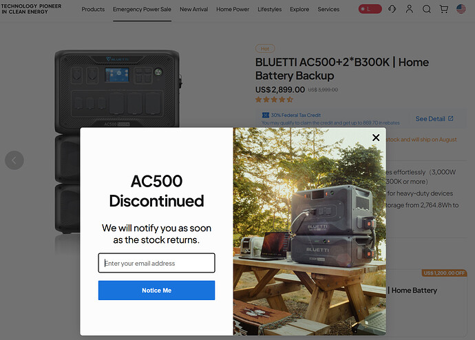

I guess it’s a moot point because when I tried to order one, the website tells me the AC500 has been Discontinued.
Not sure why it says “discontinued” because it also says it wants to notify me when it is “Back in Stock”.

Hi @SteveMyers, Please rest assured that connecting L1 and L2 together will not cause any issues.
For the AC500, we only have a small amount of stock left, and once it is sold out, we will not be able to restock it. We sincerely apologize for the inconvenience caused by the insufficient stock, which has affected your purchasing experience.
