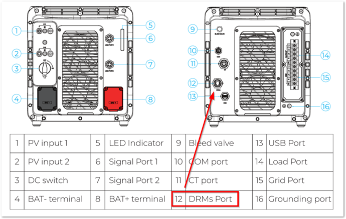

How does Dynamic Response Management (DRM) work in the EP600?

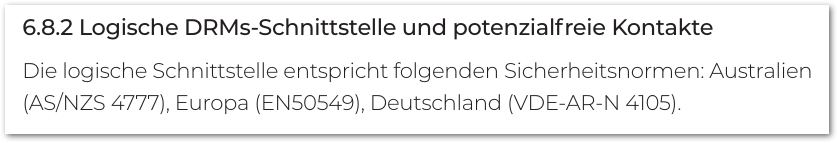

Since the beginning of this year, all new energy generators in Austria must be designed so that they can be disconnected by the grid operator using ‘Dynamic Response Management (DRM)’.
I can find this information in the EP600 documentation, but not how DRM is implemented.
Where can I find additional information on how/where the cable must be connected, and which signals to which pins?

Just to make sure I understand correctly, the DRM port of the EP600 is implemented as an output? That means the EP600 controls another device (diesel generator)?
Or can I use the DRM port to deactivate/throttle the EP600?
If the DRM port cannot (!) be used to control the EP600, how am I supposed to implement the new guidelines in Germany and Austria, which stipulate that ALL new PV inverter and generators can be throttled by the grid operator via a DRM signal (60% rule in Germany, 0% in Austria)?
Without this option, the new systems will no longer be approved and will no longer be allowed to feed into the grid (only as a stand-alone solution).
In this case, the EP600 (and probably also the EP760, EP900, etc.) can only be used as a backup battery, but not as a PV inverter for feeding into the grid!
