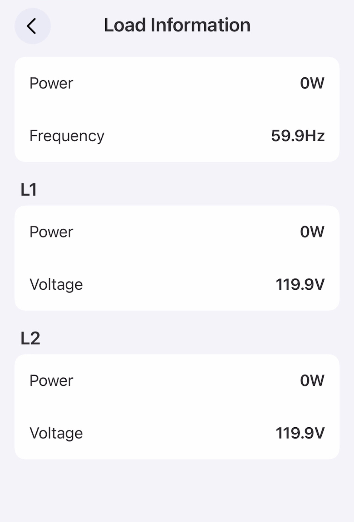

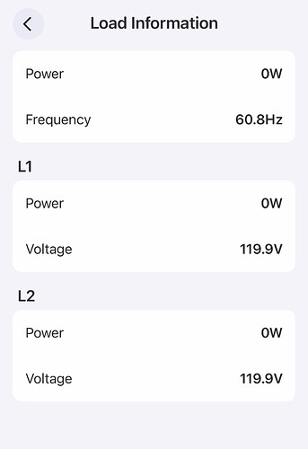

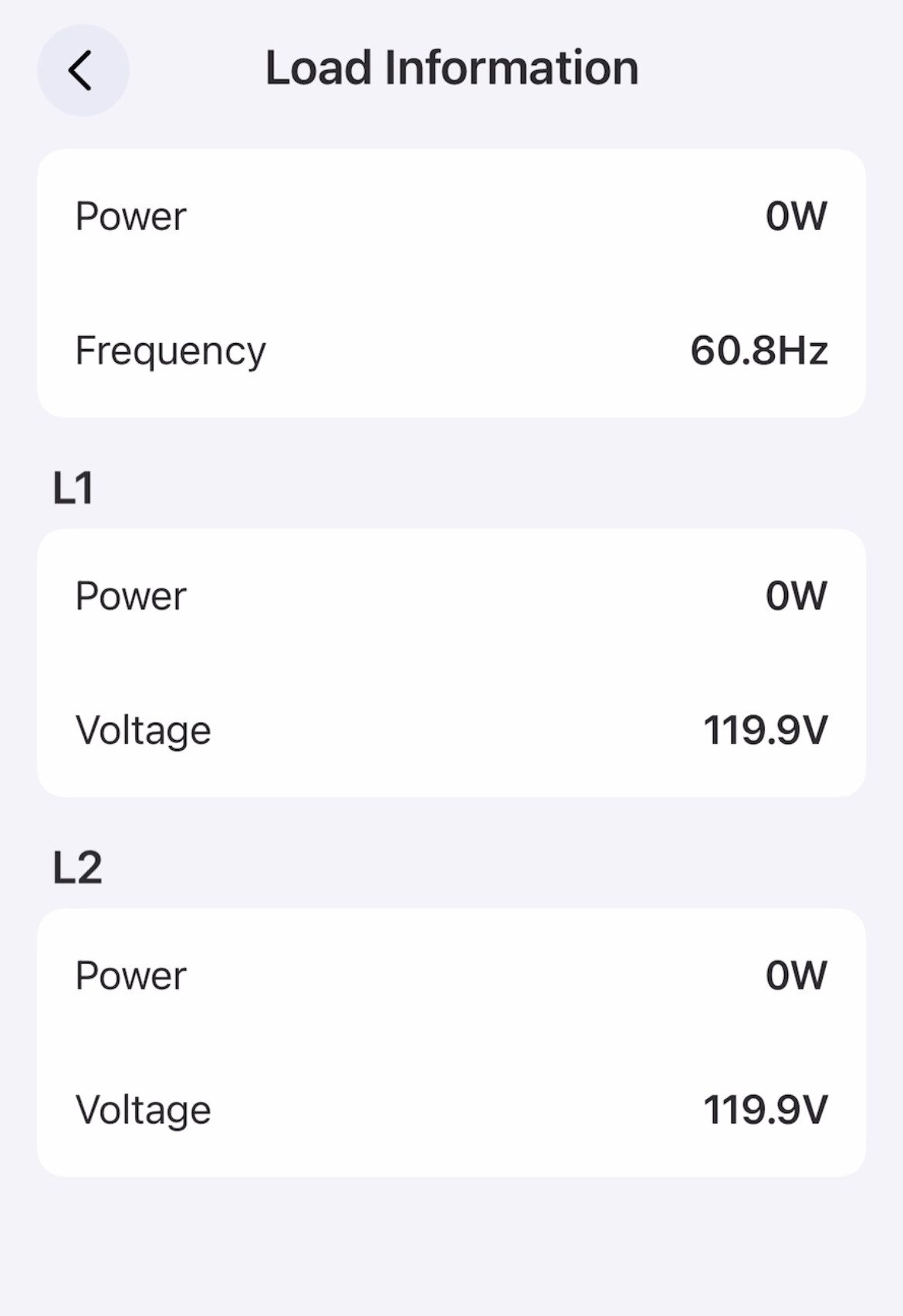

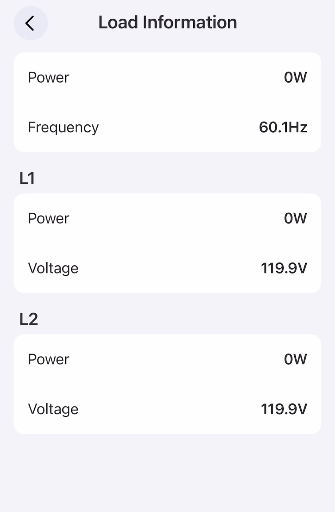

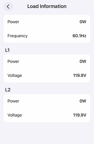

Although I don’t see the frequency in the app next to the AC output icon, when I drill down into the AC output, I see it there. Watching the display for a couple minutes, the frequency fluctuated between 59.9 and 60.8 Hz (screen shots attached).
