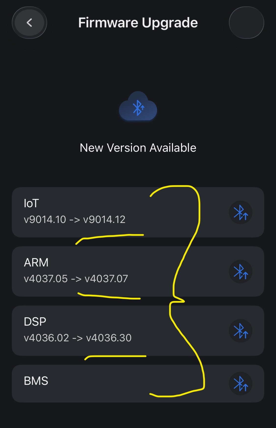

FW - IoT 9014.10
ARM 4037.05
DSP 4036.02

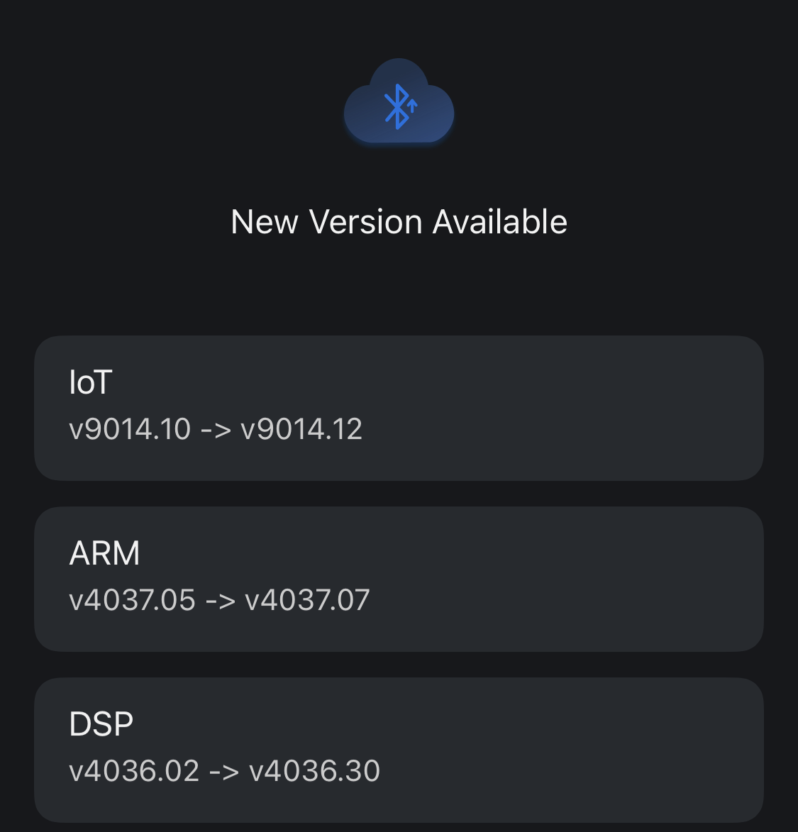

We noticed that neither your ARM nor DSP version is up to date. We have rolled out the latest versions in batches—please upgrade first before conducting further tests.

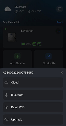

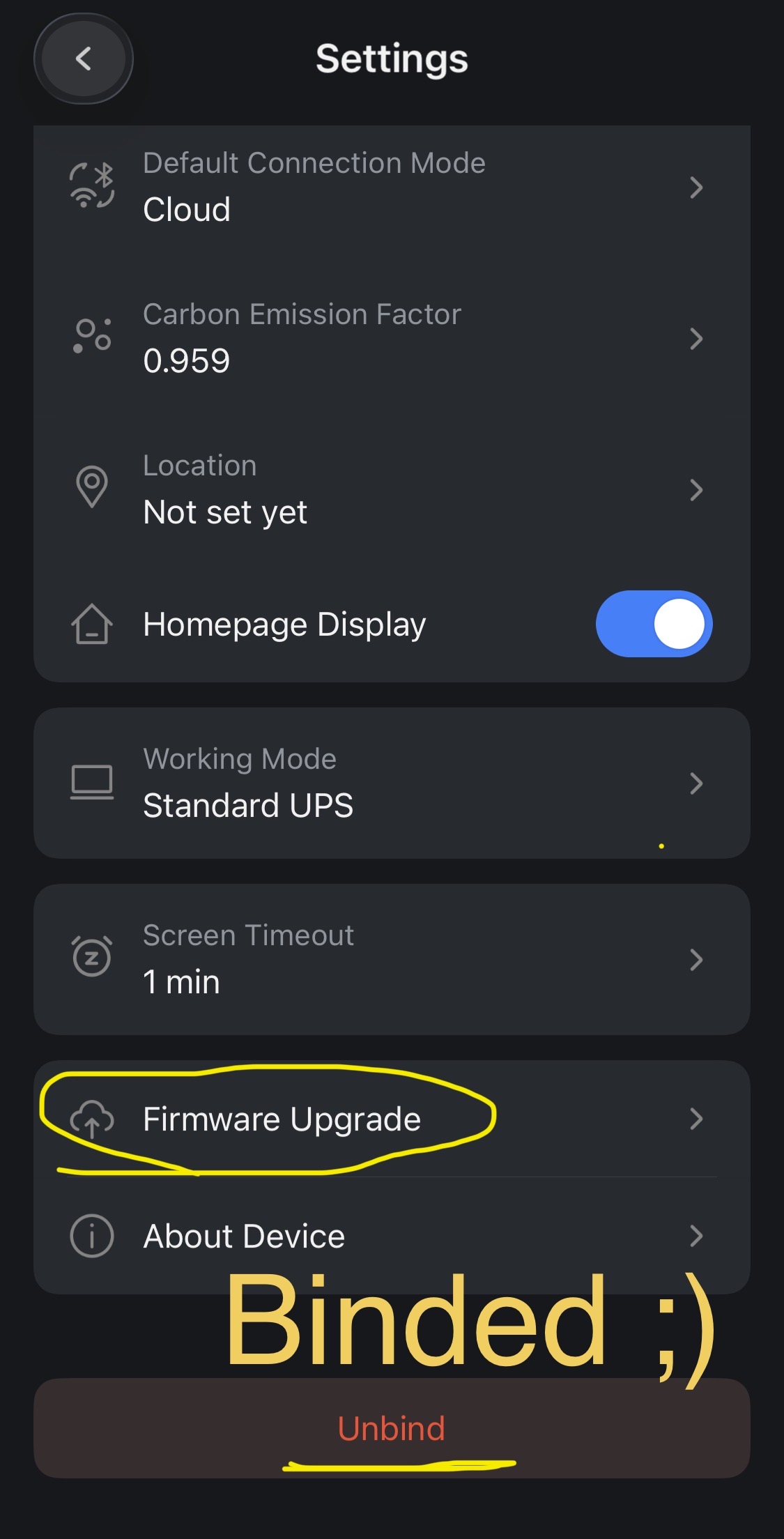

As you can see from my screenshot - this updates/versions are not containing any serious changes so I don’t see the reason to update.
Regarding “Grid Self-adoption” I don’t see such option in my AC300 menu

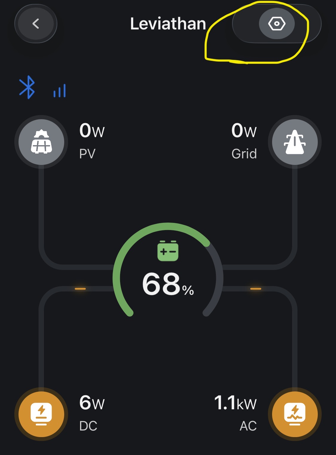

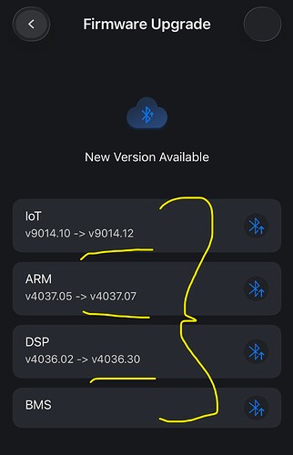

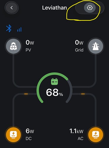

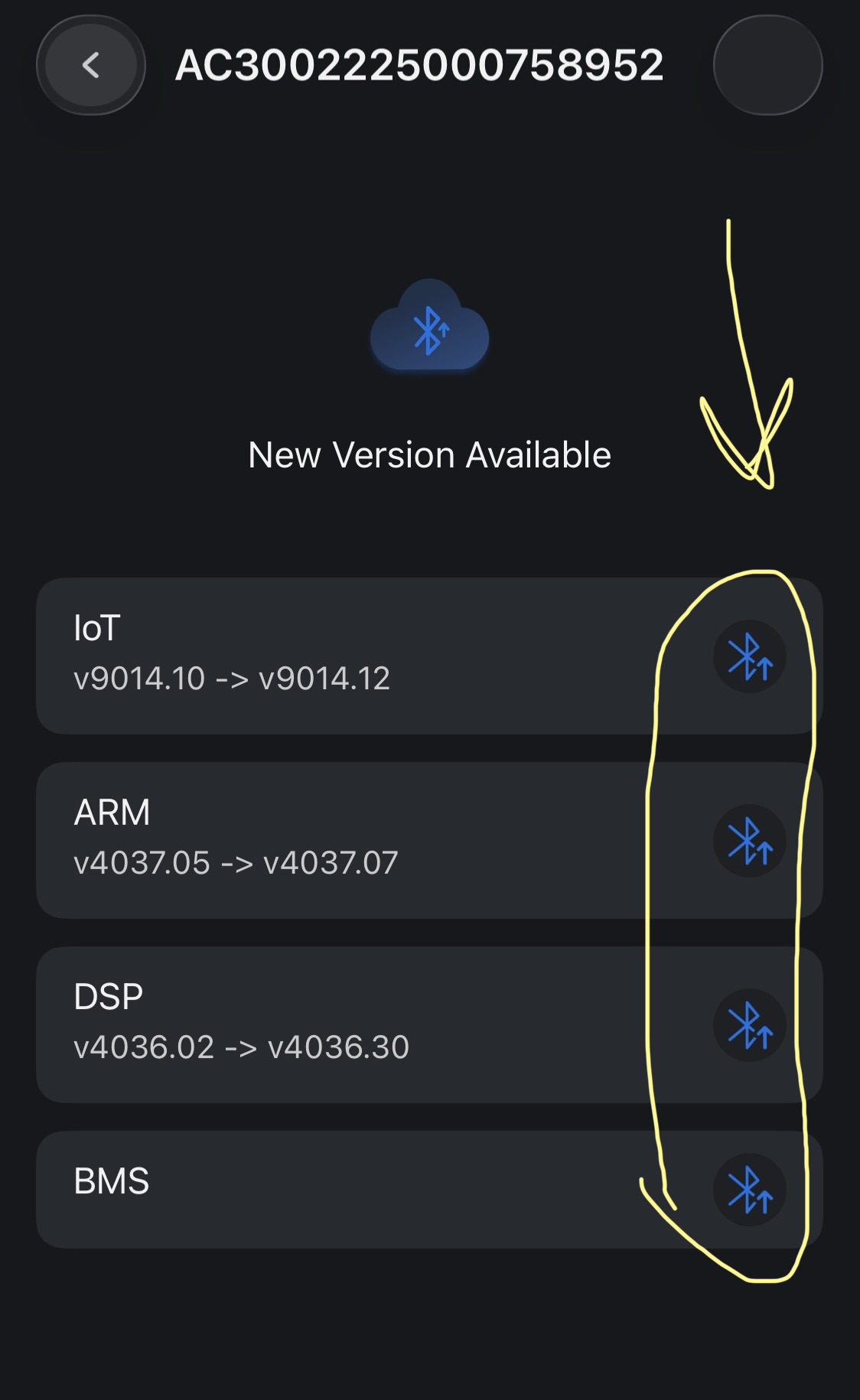

Hi @Arvian, judging from the screenshots you provided, you are using the Bluetooth offline mode or a Wi-Fi connection. Firmware updates are not available in either of these modes. Please bind your AC300 device first, then select the Bluetooth connection mode. Next, locate the blue update button and tap it to start the update.
Once the firmware update is successfully completed, you will be able to find the Grid Self-adoption option.

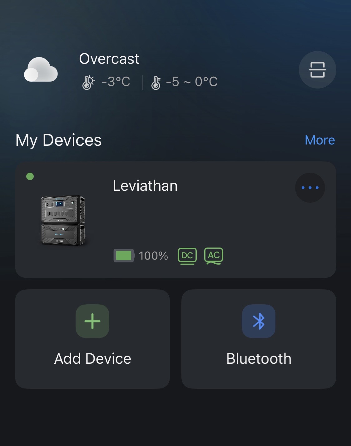

If you mean that I need to add it to cloud account - it’s already there. I can connect to AC300 from everywhere. Or I’m wrong? I’m confused :sweat_smile:
As you can see there is the same FW updates that I sent earlier (and yes, AC300 connecter to the server - binded, and I’m using bluetooth) and this FW doesn’t contain Grid power option (as I found from internet because Bluetti don’t show the list of what/where/how was changed for a new FW.
