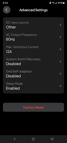

Elite 200V2 UPS & Sleep settings
Looking to use an Elite 200V2 as UPS for sump pump (grid power only)
Configuration = wall AC to Elite 200V to pump (1/3hp)
Ac = On
Working Mode = Standard UPS
Should Advanced sleep settings by on and what should they be?
Goal is to have pump run for as long as possible on Elite 200V if power is out with the quickest recovery once power is back on. (without damaging the Elite 200V)
Whole process needs to be automatic.
Also where is documentation for the Advanced Settings please? PDFs on site don’t include all of them.

Thanks for joining the conversation. I don’t have a ‘problem’ per say. I am trying to understand the Advanced Settings. Where is there documentation?
Goal is to have pump run for as long as possible on Elite 200V if power is out with the quickest recovery once power is back on. (without damaging the Elite 200V).
Hello, you can find the User Manual in the Bluetti app on the homepage under “User Manuals”. Here’s the link: gw.bluettipower.com/api/midpfilec/file/v1/getFile?id=193f247c3ce68120510ff542da6&gwcredentials=gstx17NHNxuWZ1B4lt%2FVAp5eFnhVOrlM%2Bn%2FGKbRjmQUg6Y6LtxzJNtiBx92lPMnyOHWdzfjuz%2F4%3D
Any help would be greatly appreciated. Also the fact that UPS mode does not automatically disable Eco Mode makes no sense.
