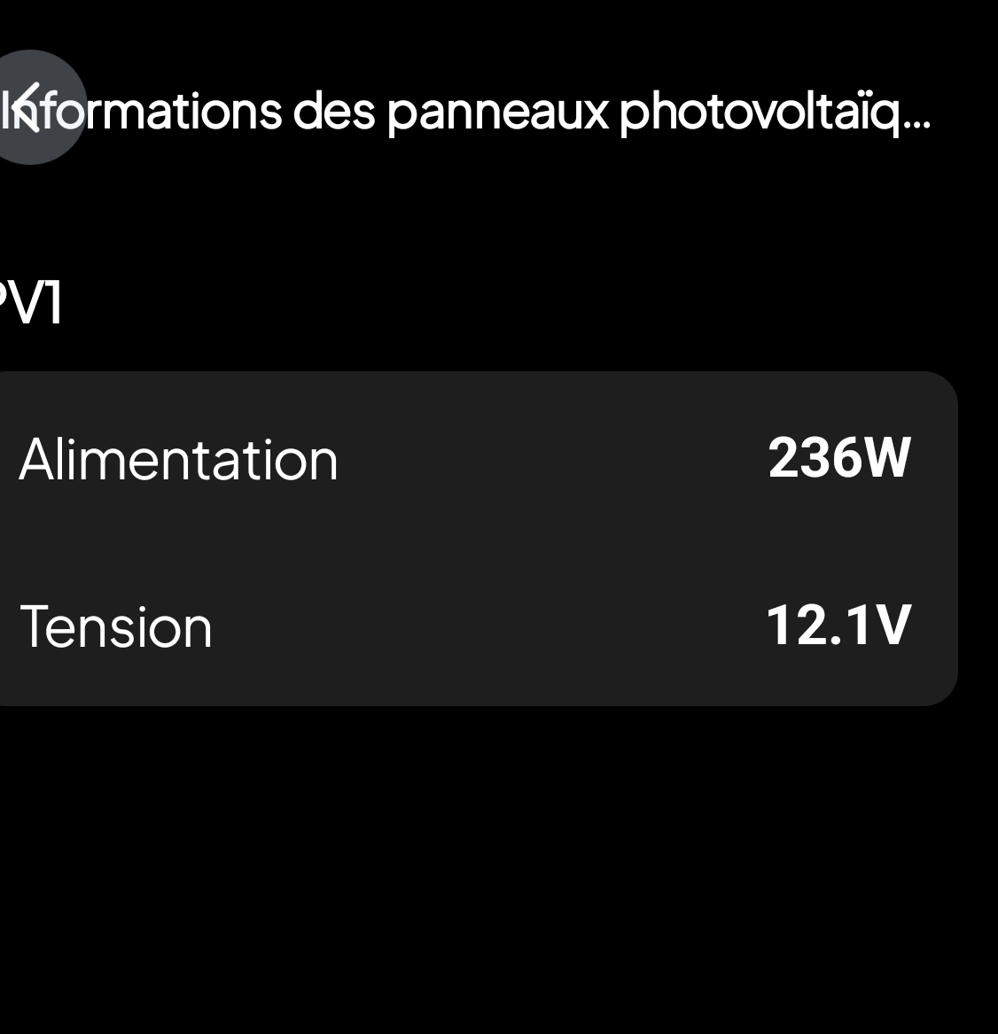

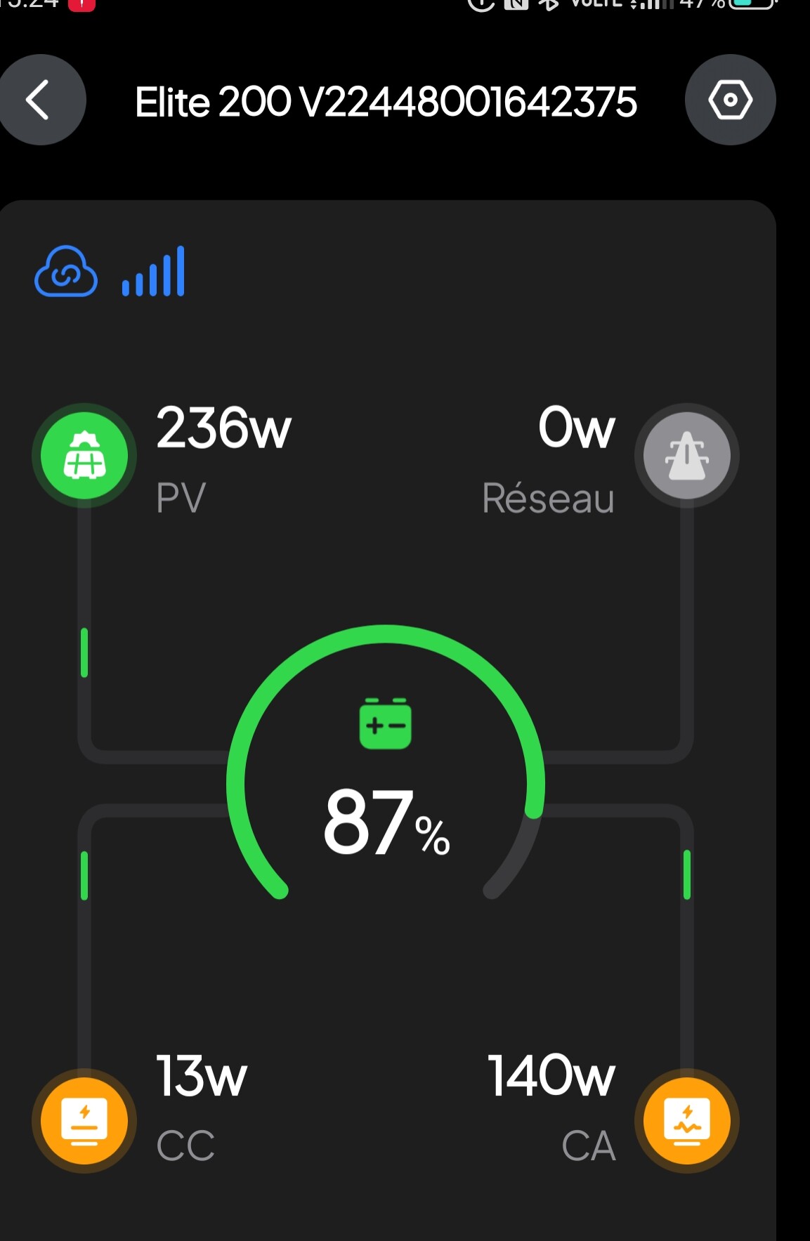

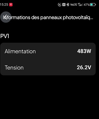

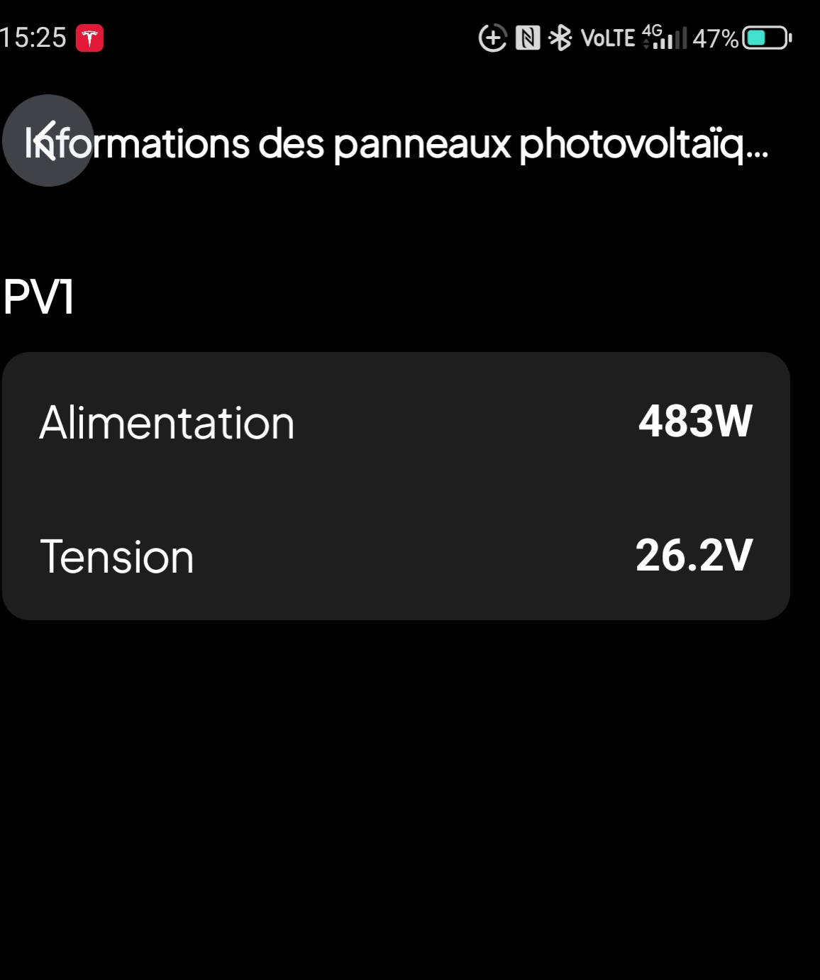

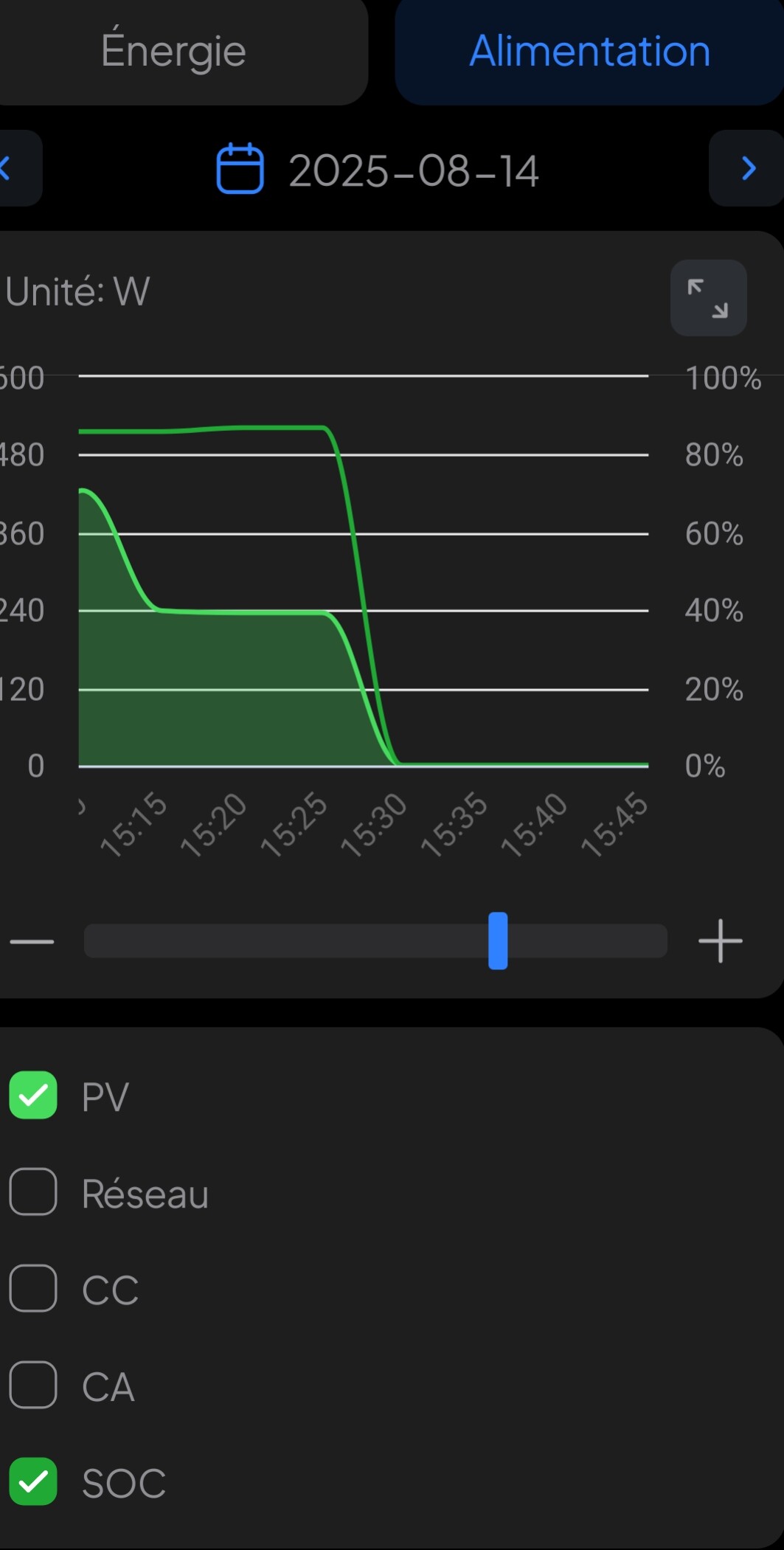

Hello, I have some feedback.
I have seen less often the issue, but last week weather was very poor, so difficult to see if problem appears or not.
Today, very sunny and unfortunatly I have seen issue again.
The solar input has stayed at low level during 30min in a row.
Lot of energy loos.
1.When issue has appeared, Voltage of MPPT drop to 12V/230W. It stays like that 30min.
2.Then I have reboot the unit. MPPT succesfully tracks Max power to 26V/480W.
Hope you will be able to find the issue

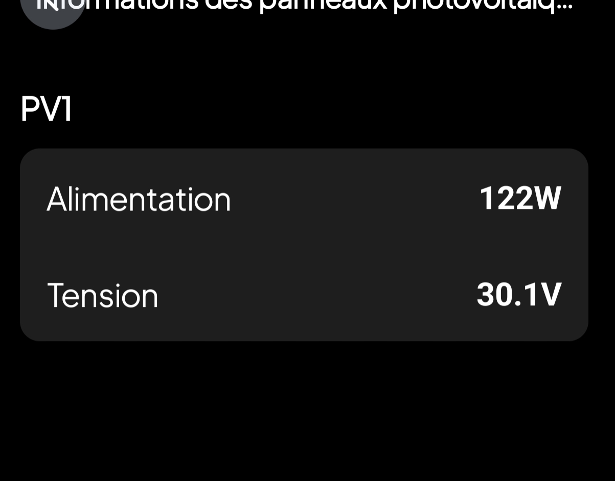

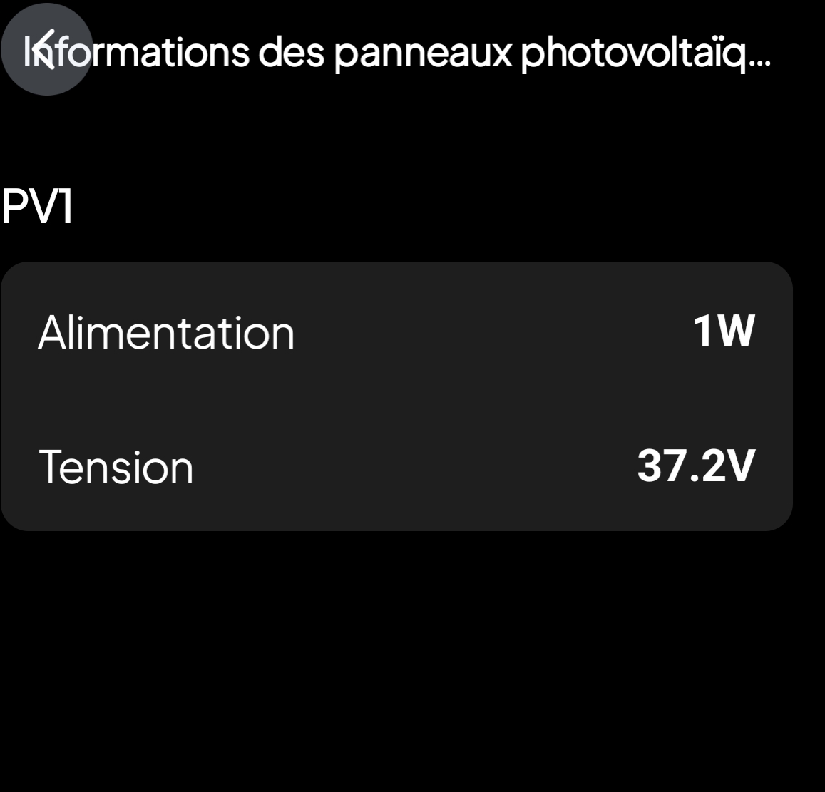

New trouble this morning. This time the MPPT stayed stuck at high voltage. Just after sunrise, the MPPT has keep V=37V->1W. I have rebbot the total unit just after I have ssen that and the MPPT found the right MaxPower V=30V->120W.
