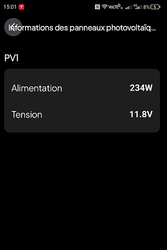

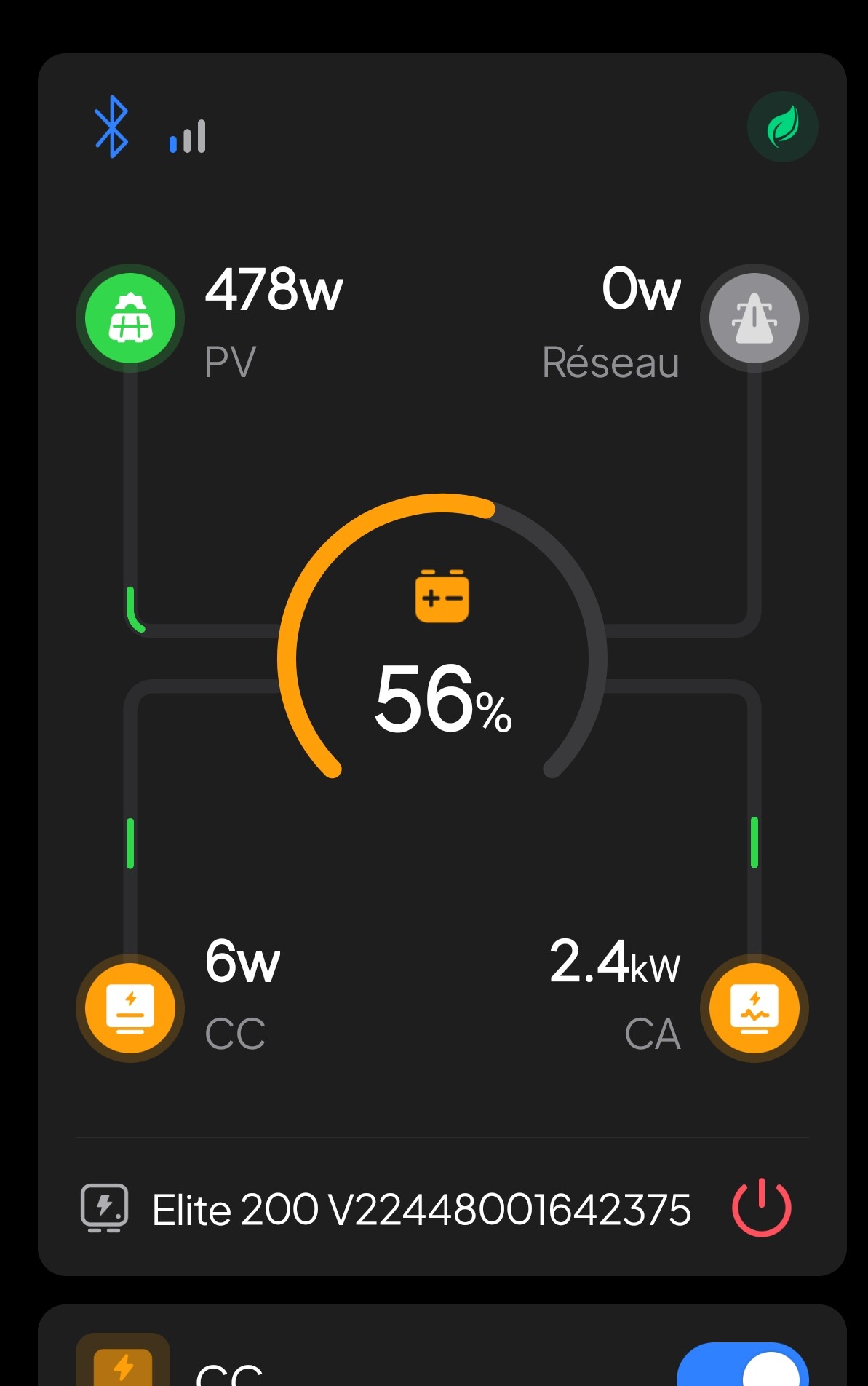

But I’m encountering a small issue with solar charging. It’s being charged by a solar panel (33V-440W). Most of the time, the charging system works well, and I reach around 350W of charging power in sunny conditions.
However, sometimes under the same conditions, the charging system seems to malfunction: it gets stuck at around 100W because the MPPT sets the input voltage to around 16V, which is far from the panel’s optimal voltage.
When this happens, simply unplugging and reconnecting the panel resets the MPPT, and it successfully finds the optimal point again (around 30–32V). Sometimes, the MPPT briefly reaches the optimal voltage, but then inexplicably drops back down, even though sunlight conditions remain constant.
Clearly, the MPPT algorithm has some bugs.
Has anyone else experienced the same issue?

Yes, I have already try “Other”, “PV”, “PV Pro”. The issue happens in the 3 modes. This happens randomly and infrequently. It can easily go unnoticed.
It realy looks like the mppt’s algorithm has a loophole in some situation. What makes me say this is that if I disconnect, reconnect the PV, the MPPT correctly finds the optimum around 32V.
I don’t have an Elite 200 V2 because I invested (too early) in several AC200max and expansion batteries. However, I encountered the same problems on the MPPT of my AC200max and I noticed that by disconnecting and reconnecting the solar input, suddenly the power can increase significantly. I only have two solutions at hand: you can add a second panel in series to increase the voltage (as Mandp suggests) however in your case it will not be possible to add a second identical panel because I understand that your panel is at 33V (Voc? Vmp?) and with two panels you will exceed the 60V max of the Elite’s solar input. You can try to find a second panel (PV2), different from your first panel (PV1) with a lower Voc, allowing to have Voc(PV1) + Voc(PV2)<60V. And ideally the second PV2 panel should have an Imp(PV2) close to the Imp(PV1) to optimize the power delivered. The other solution I see is to use an external MPPT (for example VICTRON smartsolar 100/20 - 48 V) with a battery charging voltage higher than 30V of course. If not, last solution, if Bluetti technicians are willing to look at your problem and the characteristics of your panel, they may be able to correct the MPPT of the Elite.
Hi @frncschrnvl, We suggest you enable the PV Pro mode. Does this help?
Additionally, you mentioned that the input voltage was 16V before reconnecting the solar panel, and then it increased to 33V. Could you please take screenshots of both values? A video would be even more helpful. Please upload it to Google Drive, and share the link with us, we will further analyze it.
Also, please provide the SN code and the current firmware version, including the BMS firmware, and we will attempt to upgrade the firmware to optimize charging performance.
